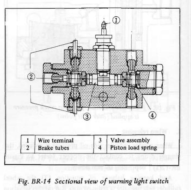

Zed Head Posted November 14, 2021 Share #26 Posted November 14, 2021 Left and right use the same chamber in the warning switch. The pressure should equalize between left and right. Hydraulics. Link to comment https://www.classiczcars.com/topic/66038-front-brakes-dont-work-need-help/?page=3#findComment-631569 Share on other sites More sharing options...

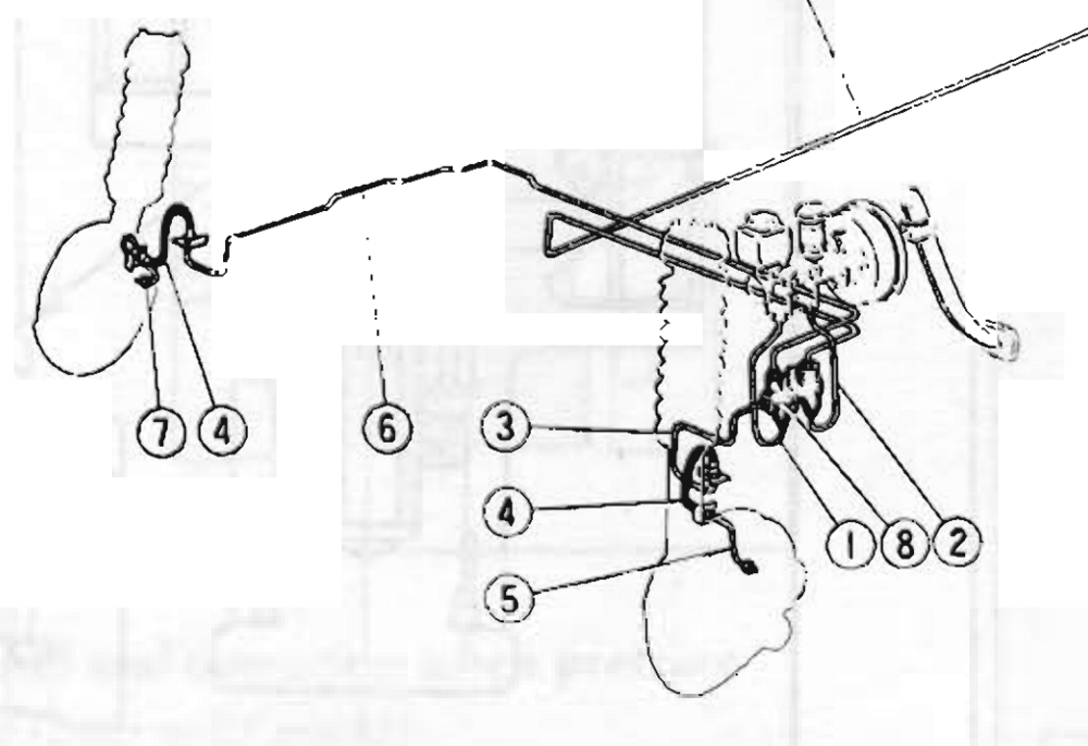

Dens240 Posted November 14, 2021 Author Share #27 Posted November 14, 2021 I agree. I'm suspicious of the lines from the switch to the left caliper. I have made new hard lines today with no improvement. I've just ordered a replacement hose to see if that's the culprit. Interestingly, all hoses and lines were new. I should have just made my own lines from the start. I replaced the speed bleeder with a standard bleeder and went to the old helper method with no improvement. Unless someone posts a eureka idea, I'll probably wait now until the new hose arrives late this week. Link to comment https://www.classiczcars.com/topic/66038-front-brakes-dont-work-need-help/?page=3#findComment-631570 Share on other sites More sharing options...

Dens240 Posted November 15, 2021 Author Share #30 Posted November 15, 2021 Cap'n - yes I bench bled the MC, which did improve things at that point. Prior to bench bleeding, I couldn't get fluid flow at either front caliper. After many adjustments - bench bleeding the MC, double checking the spacing between the booster rod and the MC piston, adjusted the brake pedal travel to ensure the MC piston can run through its full range of motion, built and installed a new brake line between the MC front brake reservoir and the warning switch - I was able to get a good full flow of fluid at the right caliper and I get good grip of the pads against the rotor. However, I still only get a very low flow of fluid at the left caliper. It's like an old man with a swollen prostate. The video I posted was taken with the speed bleeders but it would look the same with the replacement bleed nipple and the helper method. I'm now working my way through the lines from the brake warning switch to the caliper to see if I can find an air leak. Link to comment https://www.classiczcars.com/topic/66038-front-brakes-dont-work-need-help/?page=3#findComment-631581 Share on other sites More sharing options...

Zed Head Posted November 15, 2021 Share #33 Posted November 15, 2021 (edited) Hydraulic principles say that if the system is connected correctly that you will get equal pressure on left and right. It's not possible to have one side pressurized and the other not. So, air leaks are not an option if the right side works correctly. If you are getting fluid from both sides by pressing the pedal then what might be happening is that the piston is bound up in the caliper. There's pressure but no movement. Assuming that the hydraulic lines are correctly installed. Or, there's a blockage inside the switch. You might disconnect both lines at the switch and see if you get good flow from each port. I sure hope that I don't start seeing a bunch of pharma ads about flow or stream... p.s. I wrote this while others were posting. But, "first principles" apply here, as far as problem solving. The end of the warning switch has an inlet and two outlets, and hydraulics apply. The only other variable might be time, but if somebody is sitting in the driver's seat with their foot on the pedal the fluid pressure will equilibrate. Edited November 15, 2021 by Zed Head 1 Link to comment https://www.classiczcars.com/topic/66038-front-brakes-dont-work-need-help/?page=3#findComment-631584 Share on other sites More sharing options...
