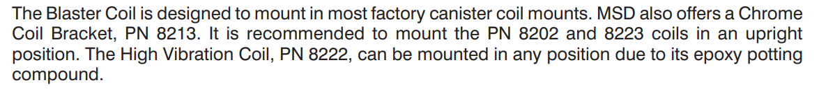

Some coils have instructions to mount them straight up, not sideways.  Maybe there's a reason.  It would be interesting to see if there are any ID marks on it.
https://www.cpperformance.com/instructions/120-8202.pdf
