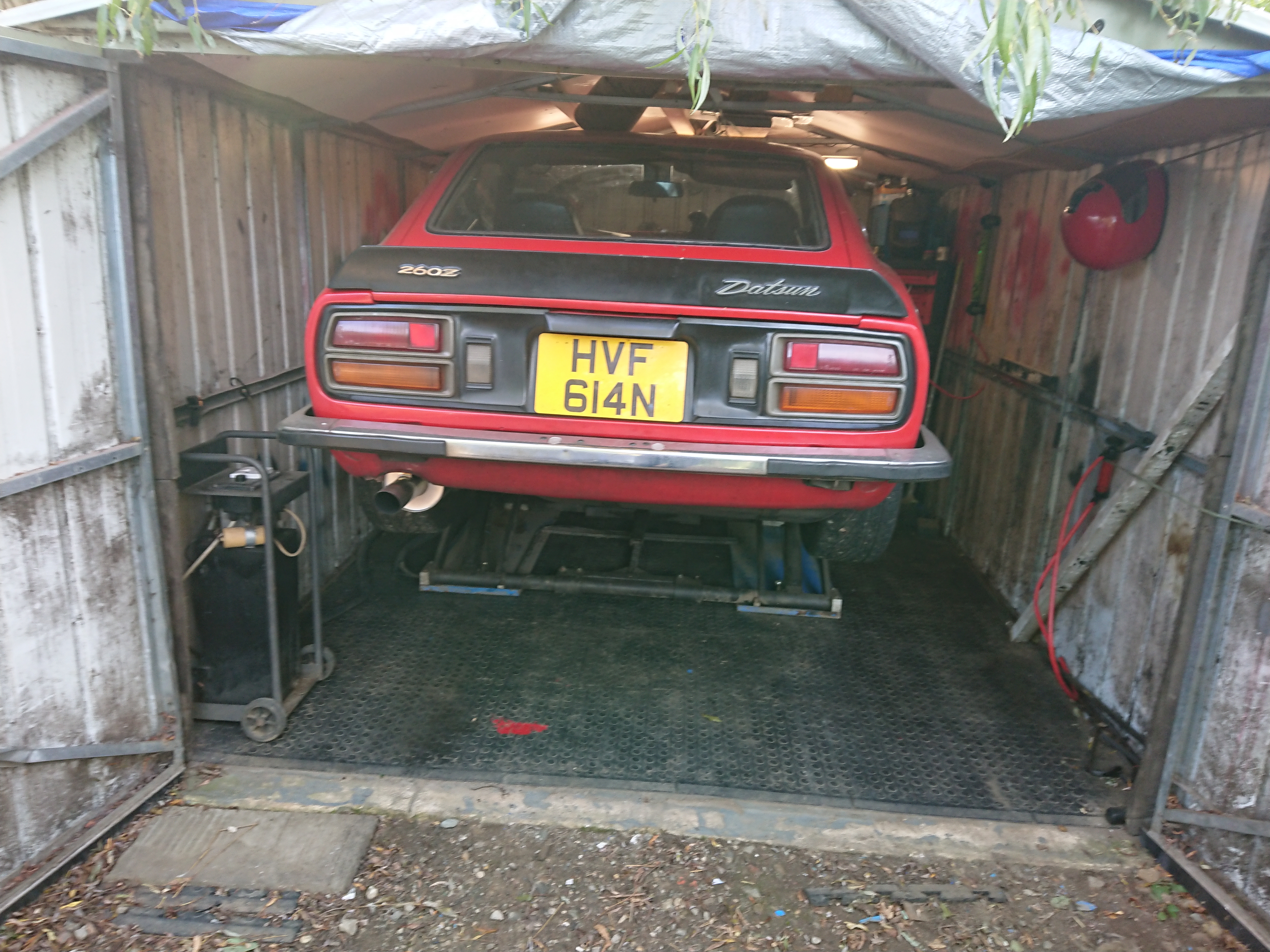

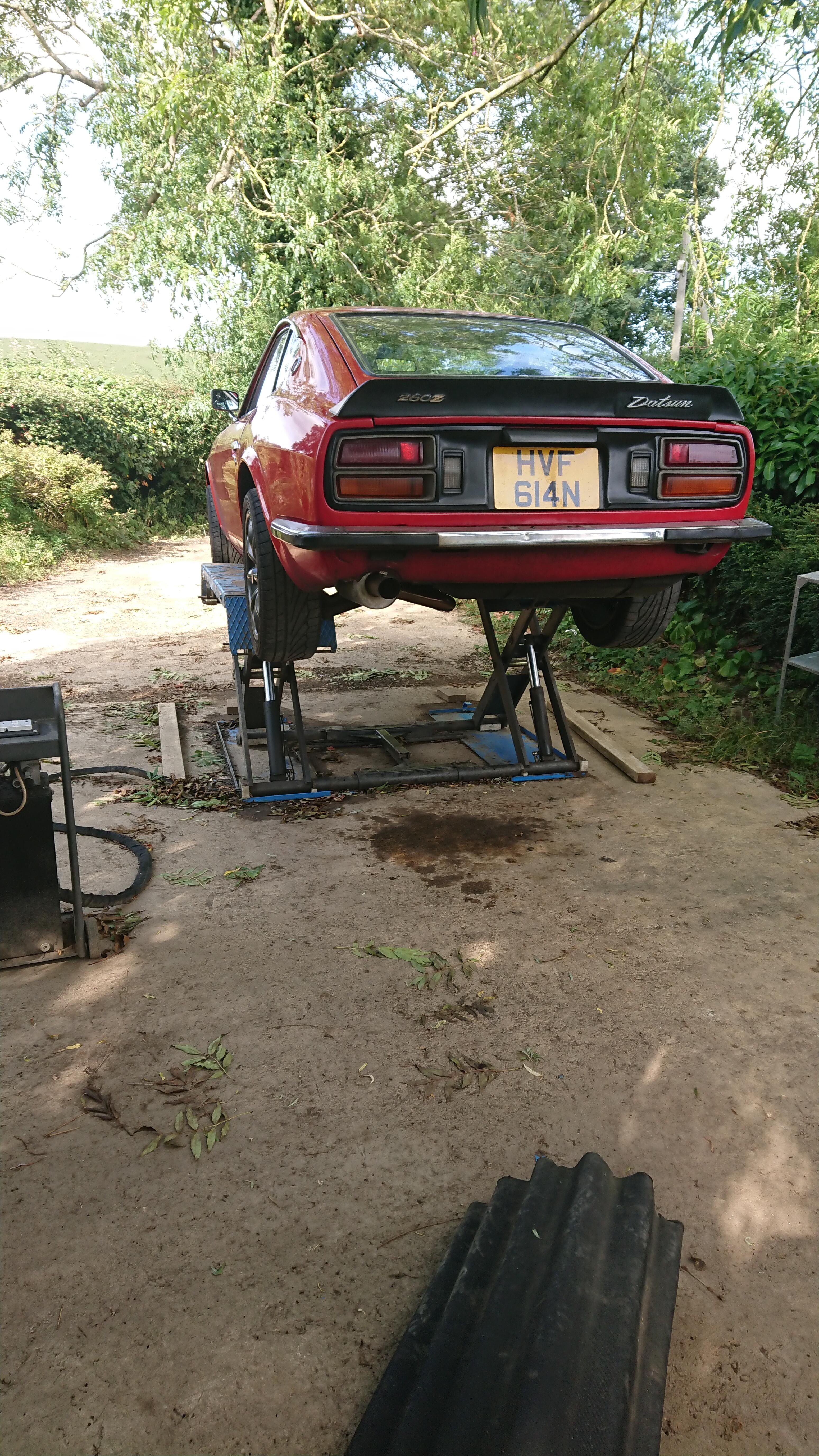

There's a couple of kinds of scissor lifts - mine does give good access to everything.

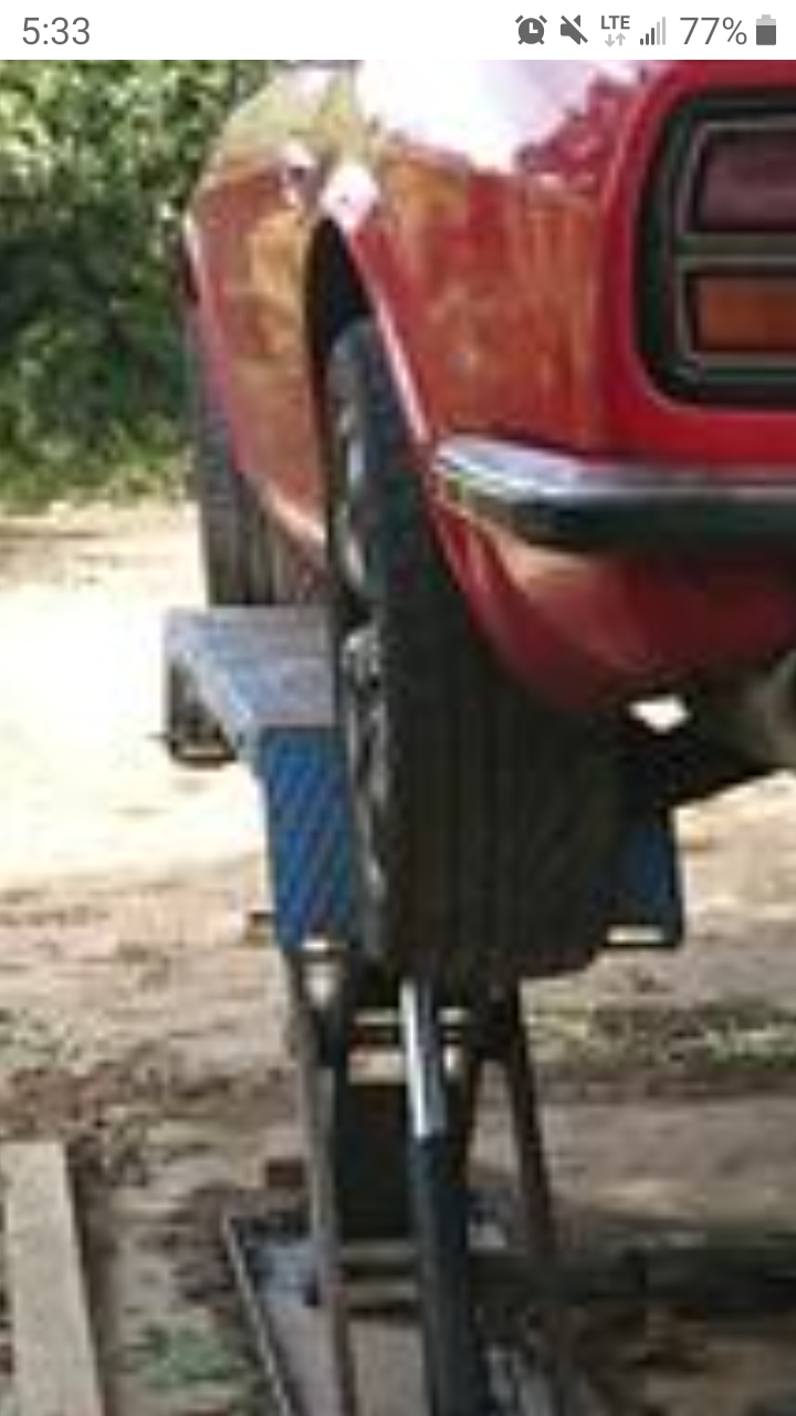

Is that resting on the tires? It looks like it does. Air compressor lifts it?
I like this lift. Thanks for the info and pics.
Here's where I think it's on the front and rear tires instead of any metal on the Z.

Cliff, I can't attest to @jonbill's setup, but for many of these lifts, there are rubber or high density foam blocks that are used. You can see them in this picture.
Great looking lift. Lots more access than the one I’m getting but I can’t pass up the price. Thanks for sharing.

no, like SteveJ says, mine also lifts on the body. I lift the Z with a cross beam on the compression rod pickups at the front and rubber blocks on the rear sill jacking point.
