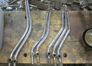

Only one hiccups, forgot to remove the shift knob so I tore the rubber gasket which pissed me off becuase I just replaced it. Anyone have a photo of their shift lever? Trying to make sure I didn't bend it, but this thing has more curves then some women I have dated so it'd hard to tell :p
