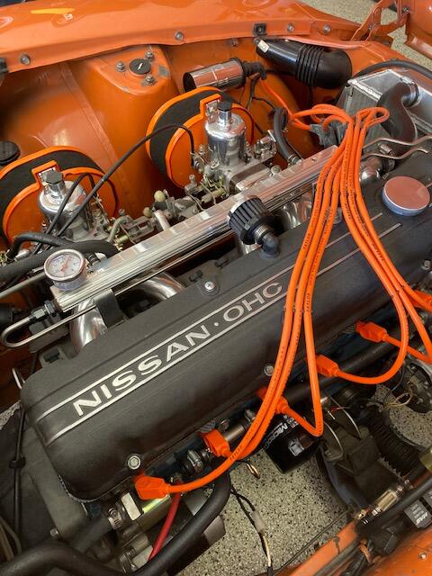

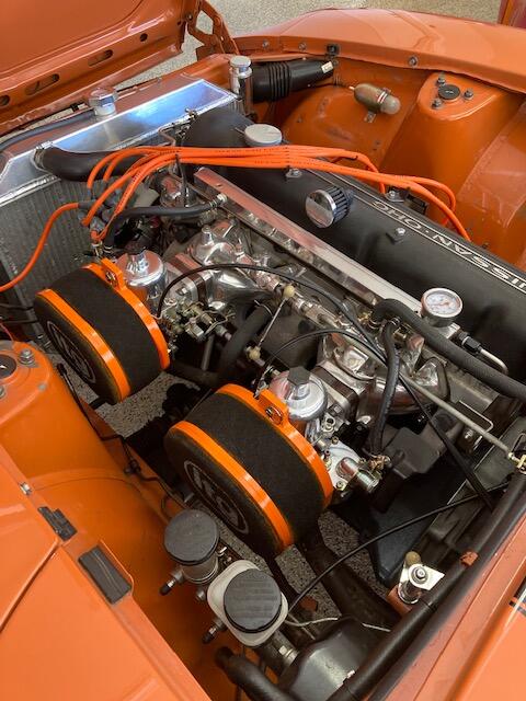

I have a freshly built, SU carbureted, L-28 in my 72 240Z, with about 5,000 miles on the rebuild. The bottom end is a 280ZX block with stock dished (turbo) pistons. The head is an E-88 which has some port matching done, and the valves have been unshrouded. I'm running a stage II cam with total timing set at 34-36 degrees. I run a stock cast iron exhaust manifold connected to 2-1/2" pipes running through a glass pack type muffler. I ran a pair of "SB" profile needles in my SUs for a couple of dyno pulls to assess where I'm at. My goal was to build a very street-able engine, without having to worry about detonation. Of course, now I'm looking at potentially bumping power with some additional mods. The best current dyno run, at the wheels, produced 180.1 horsepower and 224.5 foot pounds of torque. My question is, "hypothetically," how would swapping out dished pistons for flat ones likely impact those numbers. The downside of course is that I may not be able to run as much total timing without detonation and potential risk to my engine. As an aside, I also have a nice triple Weber set up I'm toying with the idea of swapping on. I realize this exercise is pure speculation, but would be interested in any feedback. Thanks!

Thanks Zed Head for your thoughts and link to the excellent tutorial. I learned a few things I wasn't aware of. Pretty sure my E-88 came from a 49-state 240Z, so likely fairly small combustion chambers, if I'm following you correctly. Car does run exceptionally well, so small gain with high cost is not really on the table. I had the option of installing flat-top pistons when I installed the re-worked head. My desire to get the car back on the road trumped the piston swap. This post was spurred for the most part by curiosity over what my impatience may have cost me. I may still swap on my Webers, though, I've had my triples on one of my other 240's and, honestly, my experience has been well set-up SUs perform just as well on the street, with a lot less headaches. Thoughts?
