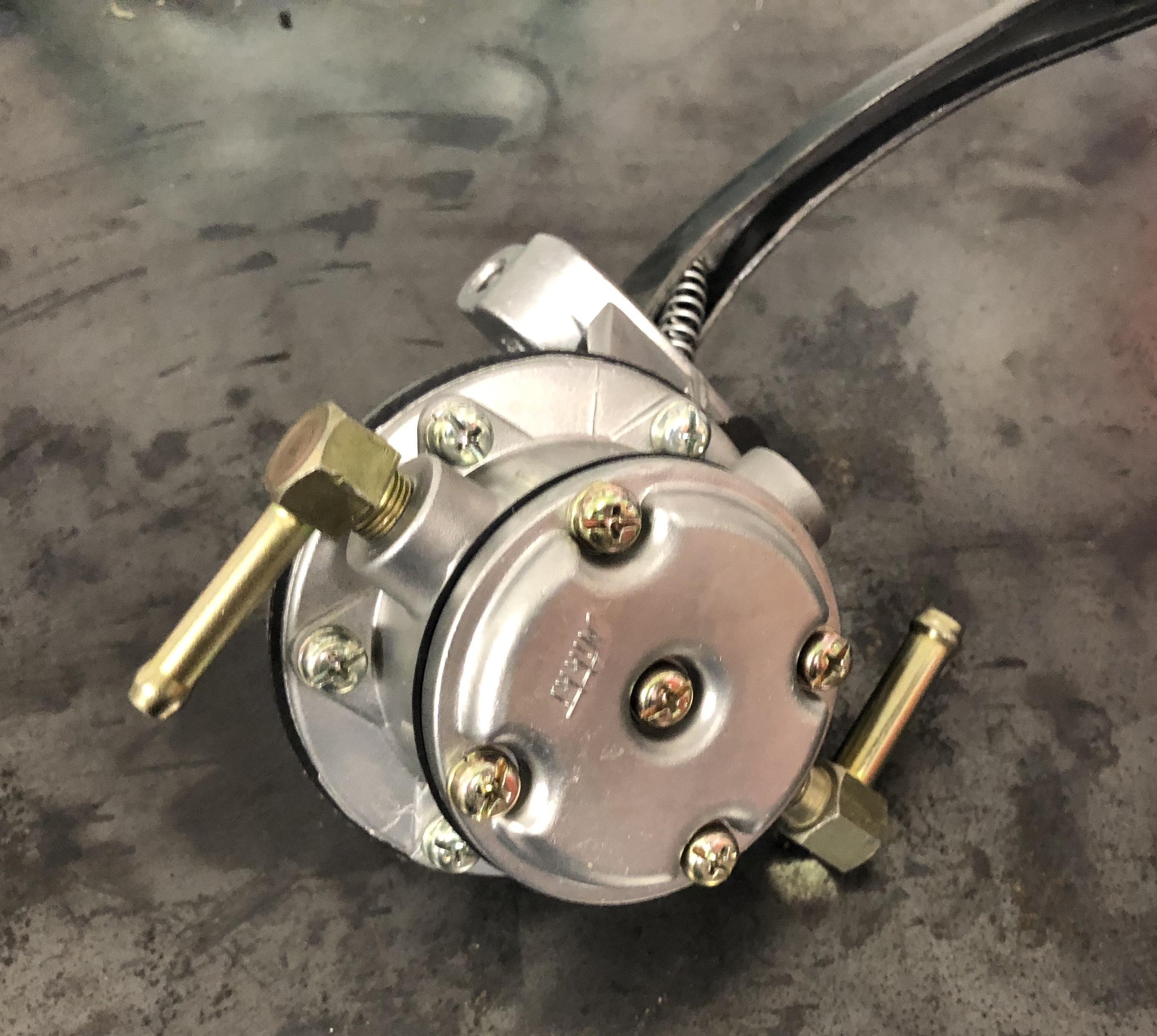

Yes, I have been sending parts off to zinc for years. Cheap and easy.  The finish is vapor blasted.
A couple more quick questions about the Nikki 271070 Fuel Pump.
What type screws secured the body halves and cover? I have seen two versions…standard Phillips head and a slotted screw with a cross slot similar to a Phillips but definitely different. (Sorry I do not know the name of this type screw head.)
I have also seen two different type covers. One is plain other than the Nikki brand name. The other has two small rectangular raised areas.
Are there different versions of the Nikki 271070 pump that might account for these differences.
I have attached a couple photos showing the differences.
Thanks
Jim
I'd guess that the bottom one has JIS screws, which require a JIS driver to avoid ruining the head.  Top one may have been disassembled at some point in its history, the PO used a Phillips screwdriver, trashed the heads, and replaced them with Phillips screws.  All just guesses on my part - possible someone else on the forum has more definitive information.
26th…
I read that article before making my post. Was able to confirm the likelihood that my 2/72 Z was equipped with a NIkki. The article mentions some differences in the screws and cover but does not really give any definitive guidance.
most of the Nikki pumps I have seen have the screws the same as the second (bottom) photo in my original post. While many I have seen have the two raised rectangular areas.
Hoping somebody can provide some definitive answer.
Thanks
Jim

Just had my Nikki fuel pump Media blasted. It looks much better, perhaps a bit dull. I will take the advice in the previous post and use some Gibbs oil based sealer. Thank You all for your help.
Jim
