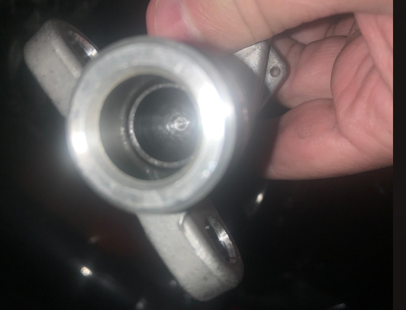

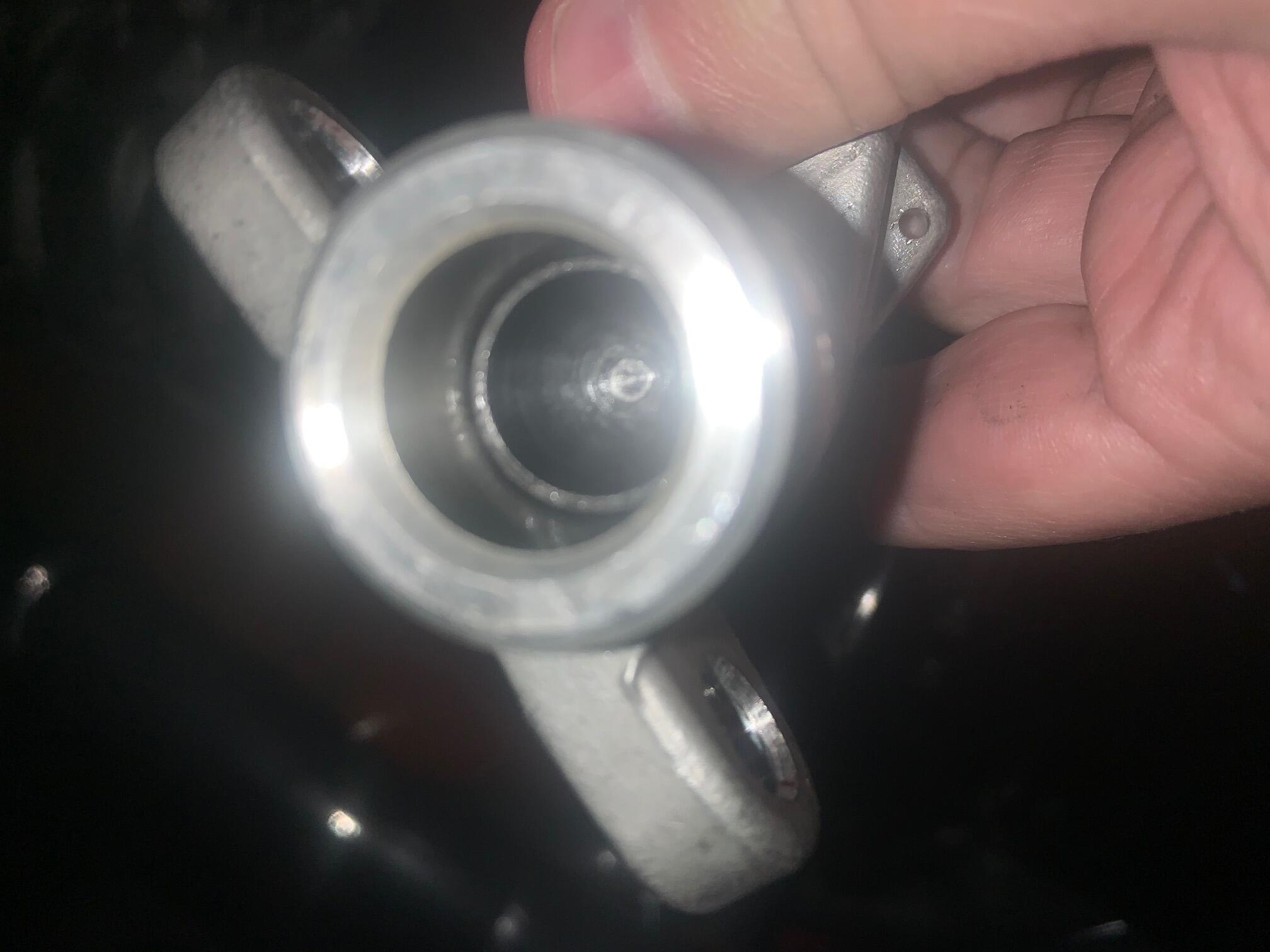

p.s. the fact that the piston is deep in the bore means that the seal is tight or the bore is dry or both.  The spring should push it forward. (Actually, outward).

His last photos are of the early (pre 73) type slave cylinder. You can see the tab next to the hose used as an anchor point for the spring. That early type slave cylinder does not have an internal spring.

Just to rewind this back the very beginning - we all suggested that the piston be removed from the bore to check the seal so that the new one does not leak like the old one did. That was the original point of the thread, I think.  It has not been accomplished.

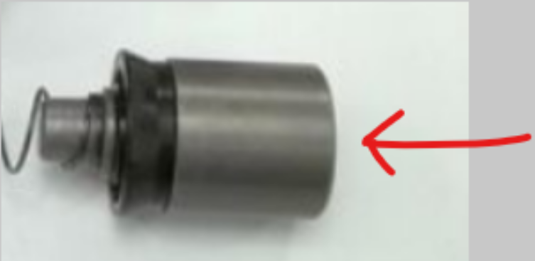

Wally is still talking about a plastic or steel cap when he's looking at the face of the piston that we want him to remove.  If there's no spring behind it then pressure can be used to pop it from the bore by applying air to the fluid inlet or bleed screw.  Overall, he might be installing another dirty slave cylinder.  A big circle with the same end result.

2 hours ago, Wally said:
I took it off and took a photo too. that round "rubber cap" is not what i thought. it is metal and i think supposed to be there like that. So, looks like all is well.
I this photo you are looking at the piston. Going by your remarks it looks like you have not removed the piston to check if everything is clean inside and free of any machine filings. I would do that before going any further.
You can push it out buy removing the two mounting bolts and pumping the clutch pedal slowly to push it out. When the piston comes out, disconnect the hose and clean the slave cylinder. Don't re-use the fluid that comes out as it could contain contaminants.
