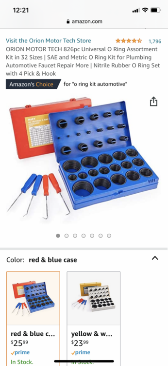

Good answer….Get a box of assorted sizes. You’ll have all the O rings you’ll ever need.
Just type in O Ring Kit on Amazon…770 pieces for $11.00. 👍
