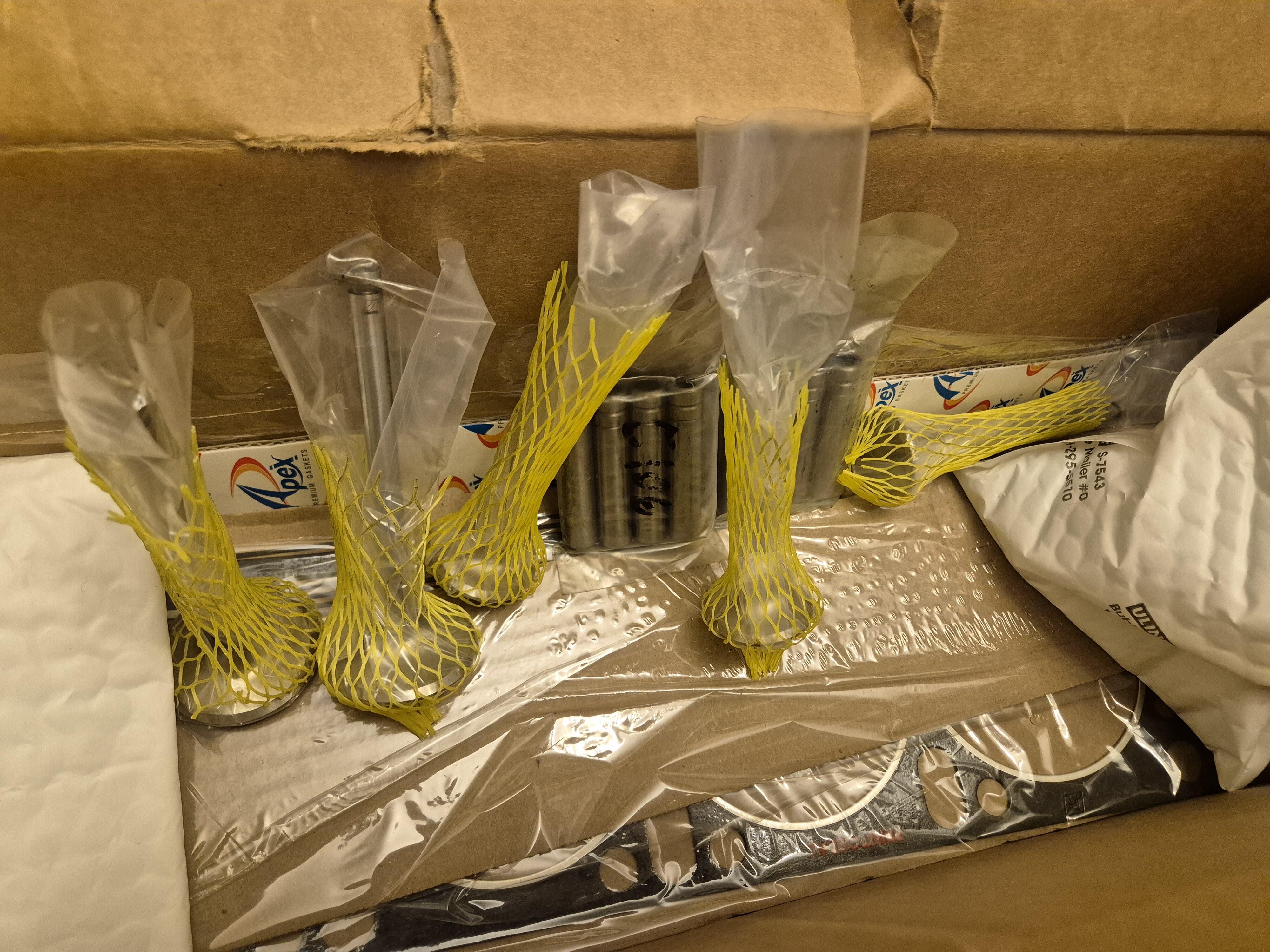

Decided to move to Spain and take the datsun with me! Hope i find a good friend or mechanic to help me with the california datsun engine. Anyway i just received new seals, stainless steel valves, guides ans gaskets. Anyone here wants me to carry out a last test before removing the head?

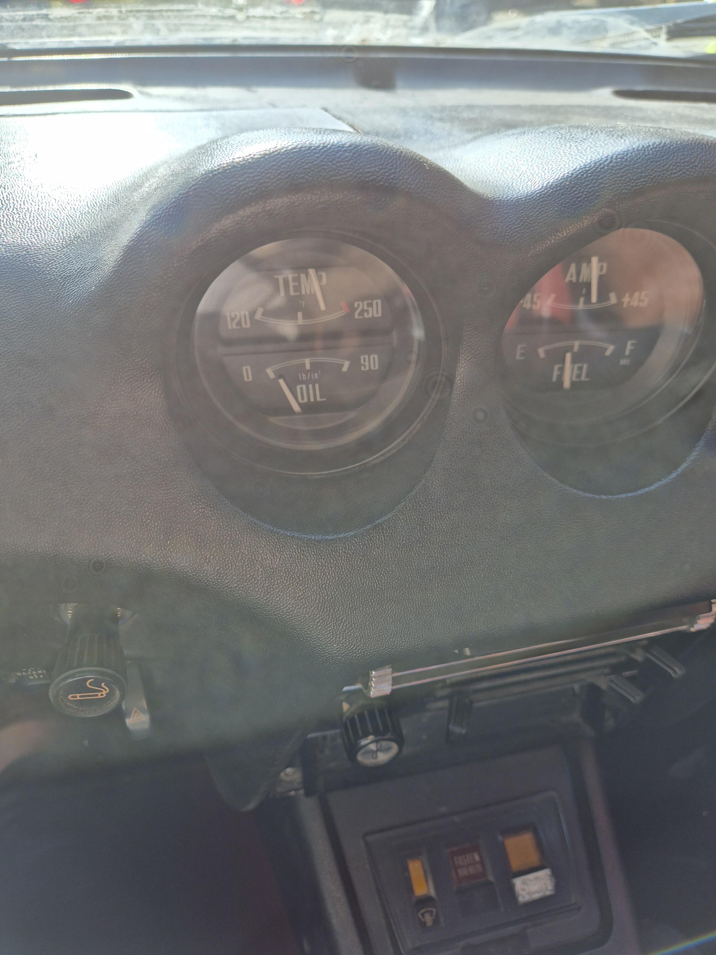

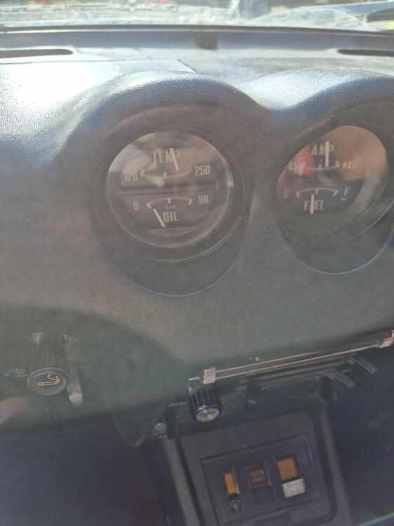

Bottomline after getting stuck in traffic for 15 minutes Temp needle raised to 3/4 on the gauge as shown in the pictures. Mechanic noticed the car started hesitating when getting away from traffic which is not normal. Anyway, he also noticed the coil was very hot and considered the following:
1. Get a new coil. This one is a petronix 1.5 ohms tied to a ballast resistor and petronix module. He said get a Bosch. Shouldnt i order a new petronix 1.5 ohm resistor? Does it matter?
2. Remove the radiator, inspect and flush
3. Get a fan clutch with more blades
If this does not solve the problem then open the head cylinder and take it to the resurface shop who will charge usd400 for the job.
Do you guys concur?

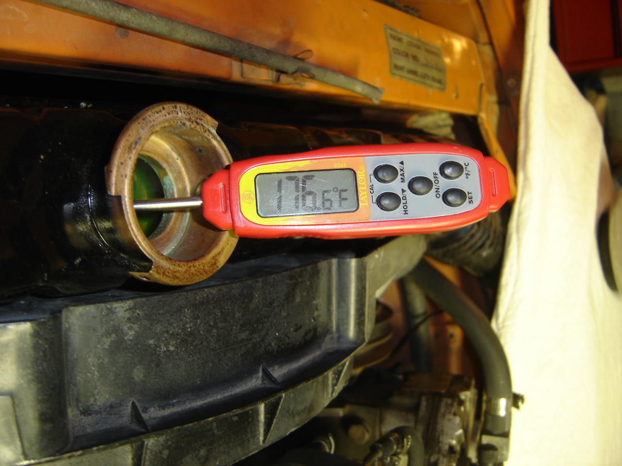

I suggest verifying that the engine is actually heating up beyond normal temps by checking it with a laser temp gun.  After a complete restoration of my car, my temp gauge is reading higher than yours, but the temps at various locations on the head and thermostat housing are 175 to 195.  I plan to remove the gauge and adjust it's reading by changing the position of a certain "adjustment" screw inside the gauge.
My gauge reads just like yours, needle lines up on the right side of the M but like everyone else's it isn't too hot. It's the gauge.
Those laser temperature guns work good but if you don't have one a meat thermometer worked for me. This is idling in my garage, thermostat open and flowing coolant.

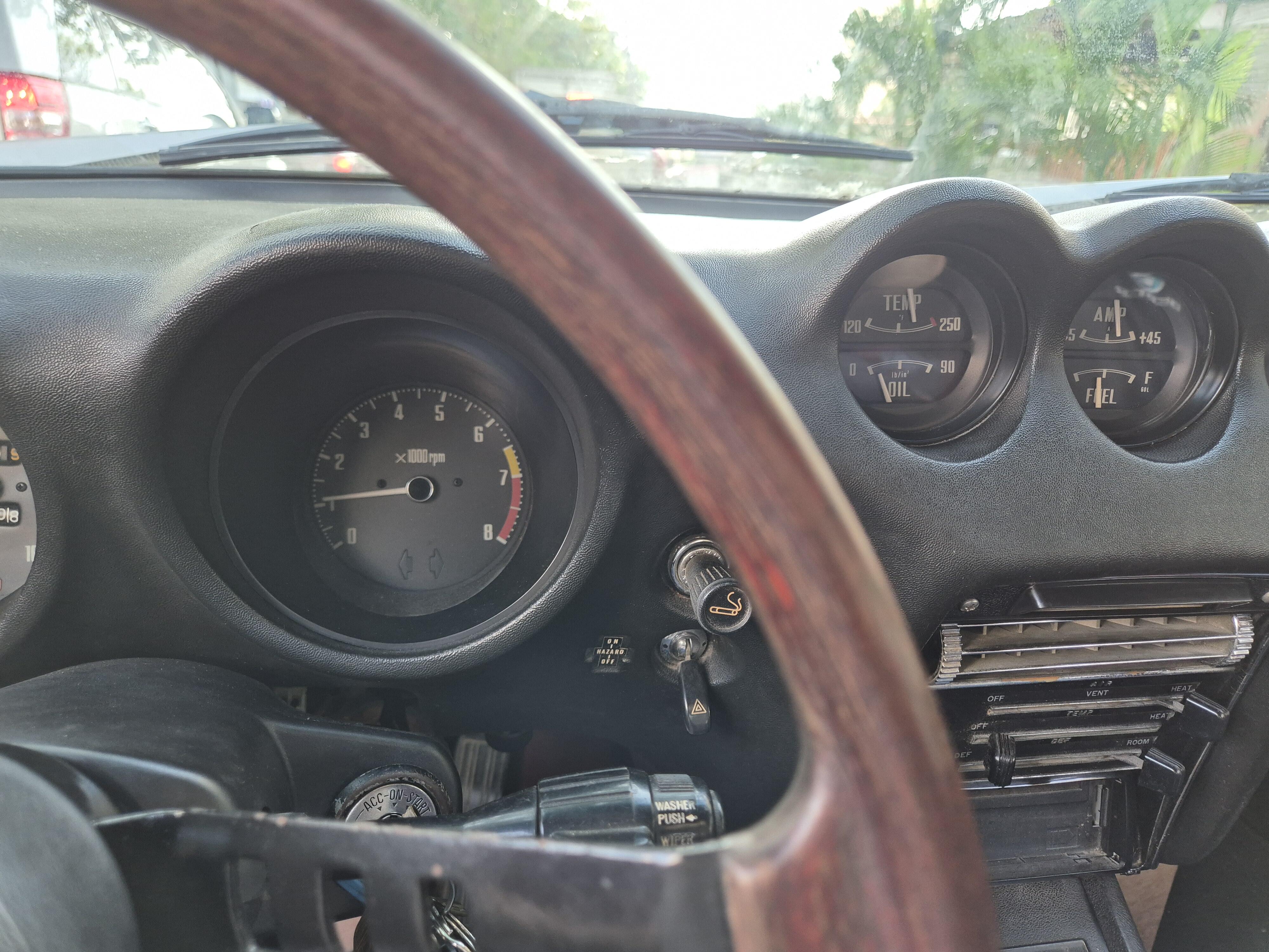

I see your choke light is off. Glad you got that fixed.
