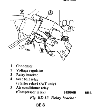

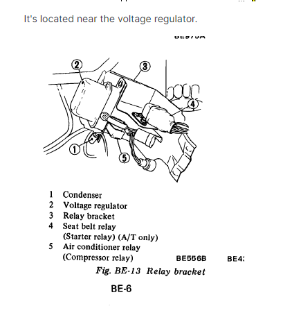

For the automatic, there is a relay in the circuit.
It's located near the voltage regulator.

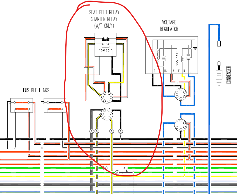

You may end up bypassing that relay if all else fails. You can also test to see if that's the problem by using a voltmeter.
Measure voltage to ground on each side of the relay. The black/yellow should be carrying voltage to the relay, and I think it might be a yellow wire exiting the relay. Anyway, that wire exiting the relay is the one that goes to the solenoid. The wiring diagrams I have aren't great about showing the wire colors there.

Where is this relay located?

Paid a bit more close attention this time. It was beeping as intended without the seat belt. With the seat belt it did cranks nicely. Relay turned up fine i think.
