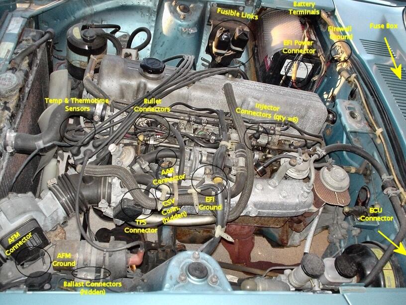

Here's my biggest time saver for my '77. He's done it all already. Click on "electrical" and also "efi and fuel".
Good stuff to read through and even better camera work.
Thanks @240260280
https://www.atlanticz.ca/zclub/techtips/
Those are good posts.  I was going to say "every electrical connection".  Be prepared to replace the injector connectors if you haven't already.  There are much better out there, available at any wrecking yard from Chevys, Volvos, BMW,s etc.
