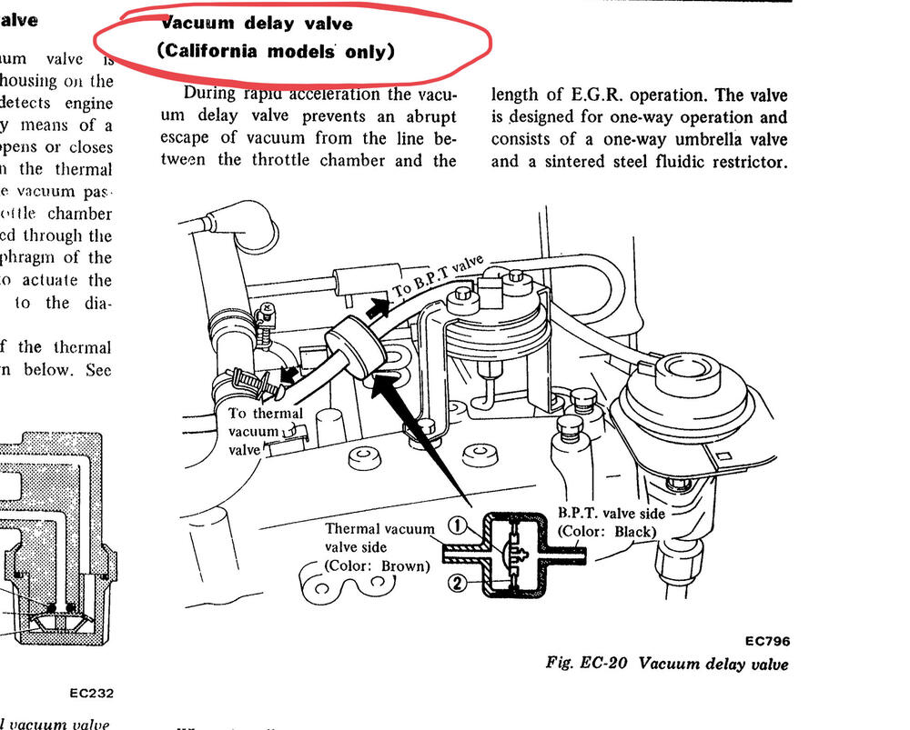

36 minutes ago, Captain Obvious said:
That's not the altitude compensator. That's a vacuum delay device for the EGR. The altitude switch lives under the dashboard above the driver's knees. But regardless... Other than wiring harness changes, the CA differences can be pretty easily removed if someone really wants to. But according to the FSM, the CA spec should be built into the VIN.

Thanks for making me smarter Bruce.  I didn’t really know what that device did just was my understanding that it was only put on CA Spec cars.   I really don’t think the guys working at the inspection garage will be able to tell of the car is CA spec anyway.

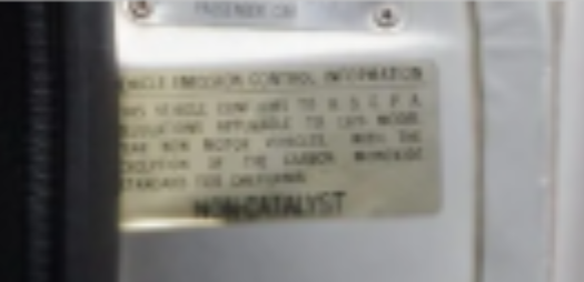

Cars that came with a converter have a sticker on the door jamb that says "Catalyst" or "No Catalyst".  Not quite the right word, but it's what they used.  I had to point it out to the guy doing my emissions testing in Oregon, while he was looking underneath for a converter with his mirror.

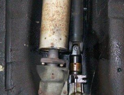

Thank you, I was thinking last night, and my Z was undercoated by the dealer, now if it had a cat and a heat shield, then it wouldn't have been undercoated where the shielding was bolted on, but as you can see, mine was undercoated all the way through the cars tunnel. So perhaps it wasn't a California car after all ?

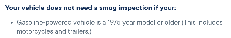

This looks like the Nissan (anti-) resonator.  Doesn't look like it ever had a converter, so it's federally legal, and are you sure that you have to get one?  Looks like you don't even need to get tested.  1975.
Wrong below...wrong state.
https://www.dmv.ca.gov/portal/vehicle-registration/smog-inspections/
Edited by Zed Head
No, I think my best direction is getting 'Classic' tags, that way I am not required to have the emissions test, but I still need to have the safety inspection done each year, which I find perfectly OK. It was last registered in 2012 in Michigan. So it has been sitting in a garage the last 10 years. Clean a whistle.
