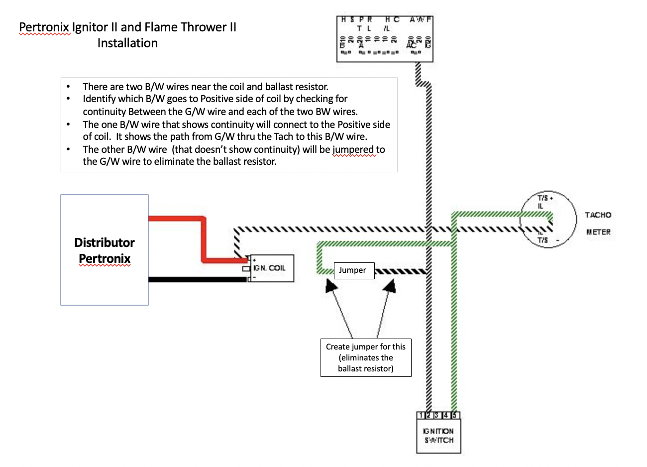

I just installed my Pertronix Ignitor II and Flame Thrower II.  I'm not sure of the differences, but this is how I wired it.  It eliminated the ballast resistor.  I got the information from the video @SteveJ posted above and then updated a diagram previously posted on this site.  I hope it helps.
My tach does work.
