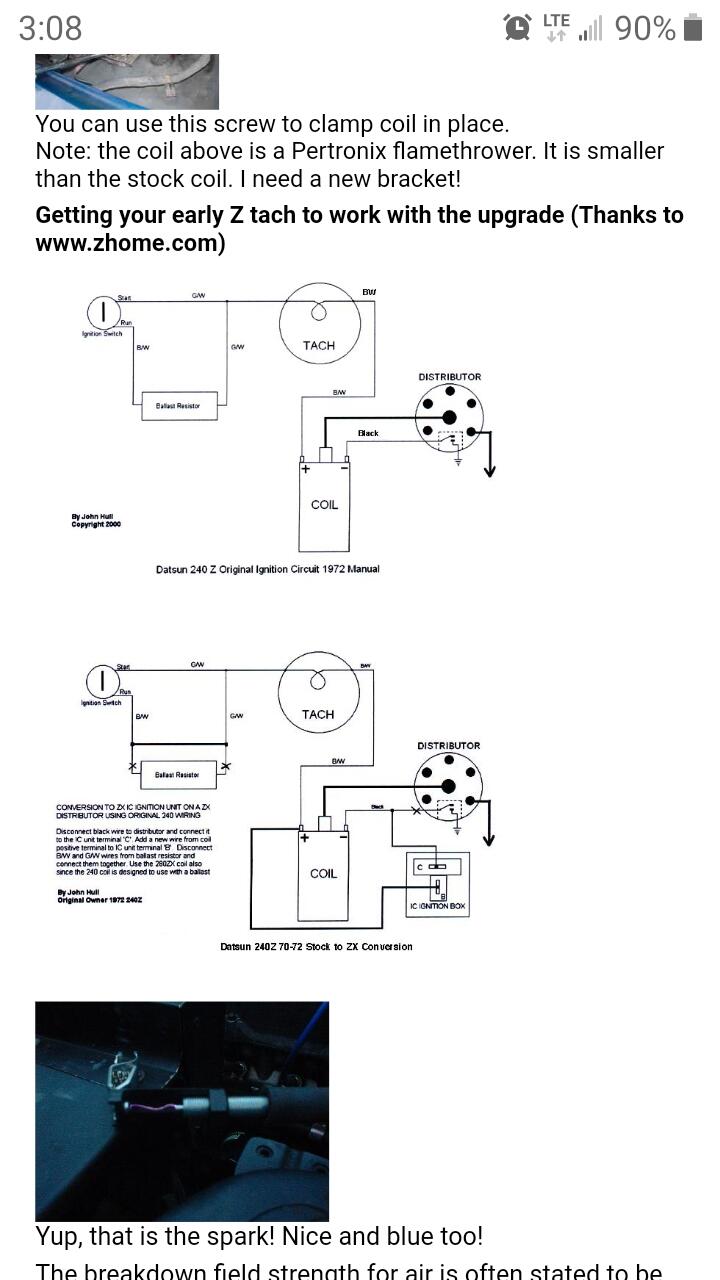

This one is a good start for the 240Z's.  Some people have tachometer problems when they switch to electronic ignition, but others don't.
Always a good idea to study the instructions and understand what each wire does before beginning.  It's tempting to just follow the instructions and match wire colors but often there is a step missing or just not quite right.
http://www.zhome.com/ZCMnL/tech/gmhei.html
I'm guessing that most of the tachometer problems people have is that they put both black/white wires onto the coil instead of connecting the black/white wire from the ballast resistor to the green/white on the ballast resistor. @beermanpete wrote that up about the Pertronix over at Hybridz.org.
I used this write up to put a '79 ZX distributor in my '72. It works great too.
Bought the refurbished ZX distributor off amazon.com
https://www.atlanticz.ca/zclub/techtips/distributor/index.html
The 240 wiring is close to the bottom of the write up.

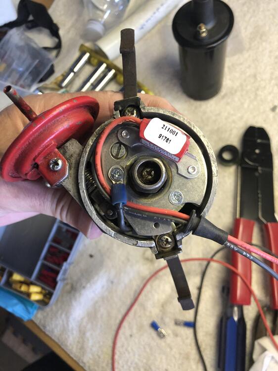

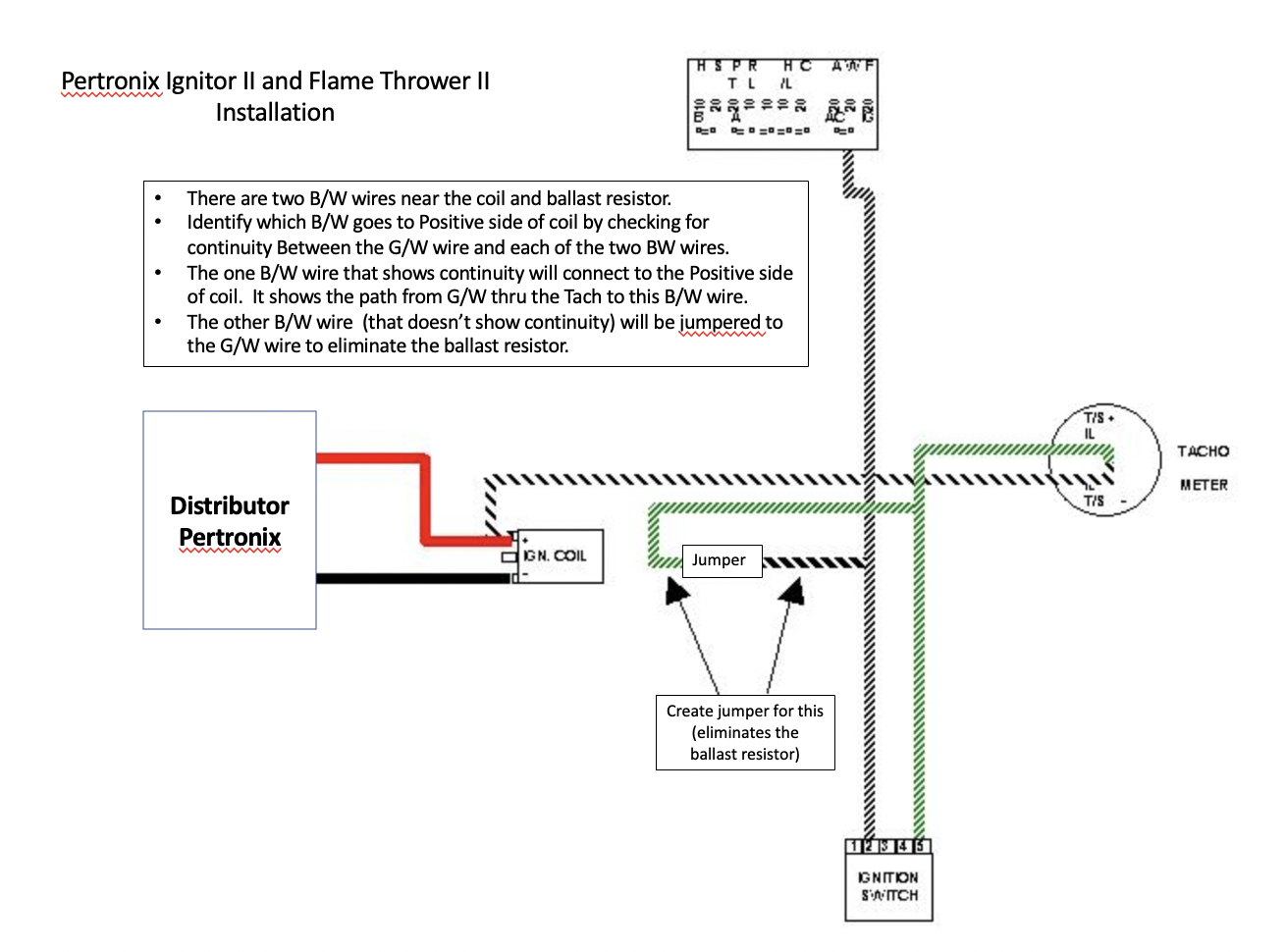

So, I cleaned up my points distributor and installed the Pertronix Ignitor II and the Flame Thrower II.  I read a number articles, comments, and watch videos. I updated a diagram posted on this site (sorry I can't remember the source) and wired it as shown.  My tach works and have good spark.  I haven't done any real testing yet.
Note to self...don't forget to install the rotor...your car won't start without it.
I hope the diagram helps.
Screen Shot 2022-02-22 at 8.31.48 PM.pngd
