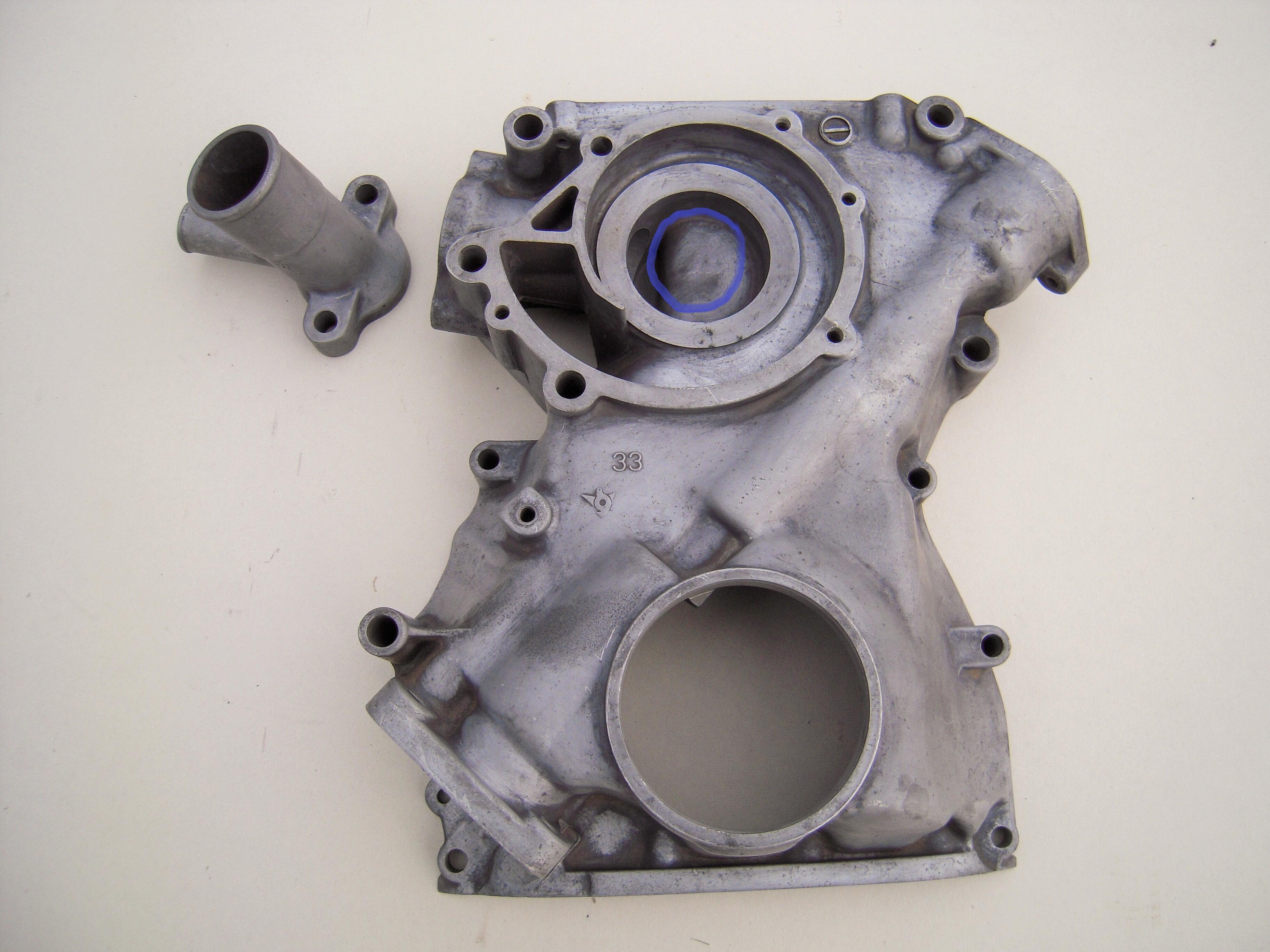

I have an 81 that had a bad head gasket (overheating). When I took the engine apart I found a considerable amount of corrosion in the head where the thermostat housing attached. I also found that there was corrosion in the timing cover water pump volute (blue circle) when I removed the water pump. When I sandblasted the timing cover, the metal was so thin that I blew a hole thru the cover behind the water pump. In time, it would have started to leak antifreeze into the oil on its own. I used some super industrial 2 part epoxy (Belzona 1111) to repair all of the corrosion in the water pump volute and cylinder head. 1539123574_DSCN0201(2).JPG.8cbb71268a1455eed1d04f81367acf23.jpeg.jpg.4f4ad4a40a6f9a908c3b2299a19bae40.jpgs-l1600.jpg

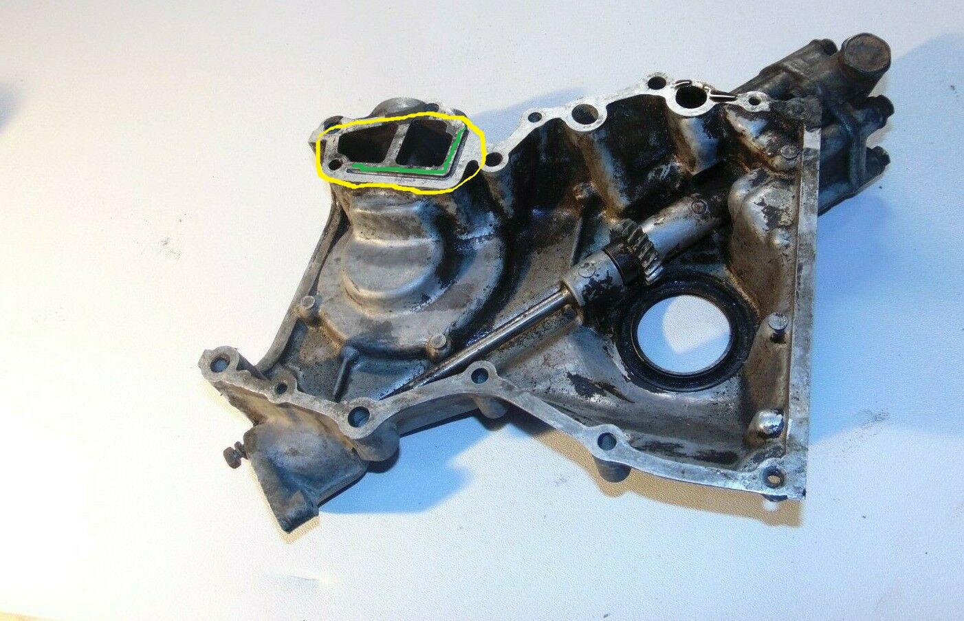

Did you pull the water pump when you had the timing cover off? You can also leak antifreeze into the oil at the water pump inlet/outlet of the cover where it mates with the block (yellow circle). The green line is the "tattle tail" grove. If your gasket fails, you should see antifreeze dripping on the ground, but over time this grove can get plugged with gunk and could leak into the oil. As mentioned above, there are a couple of timing cover/water pump bolts that extend into the coolant jacket of the engine that could also get antifreeze into the engine oil.
