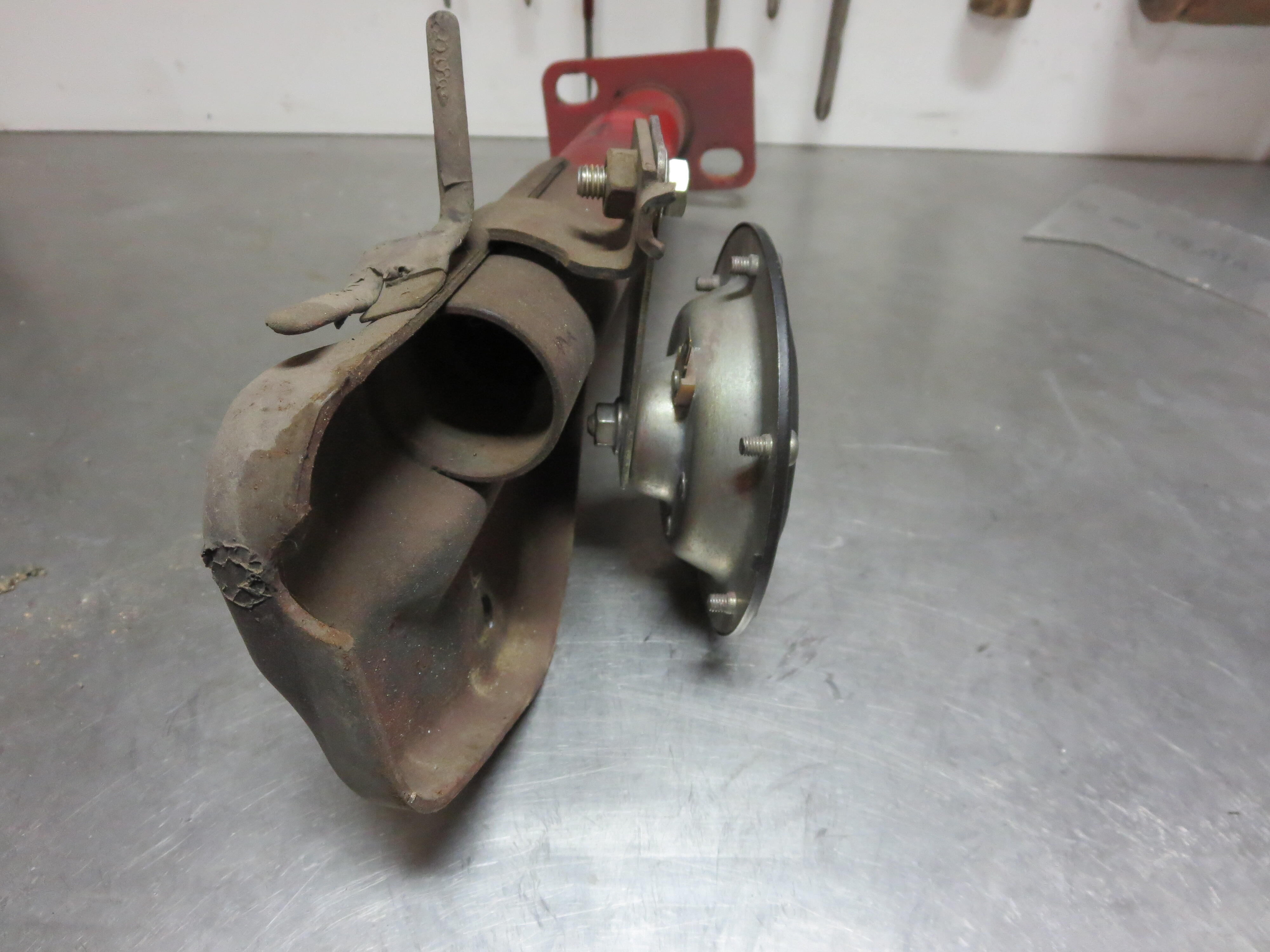

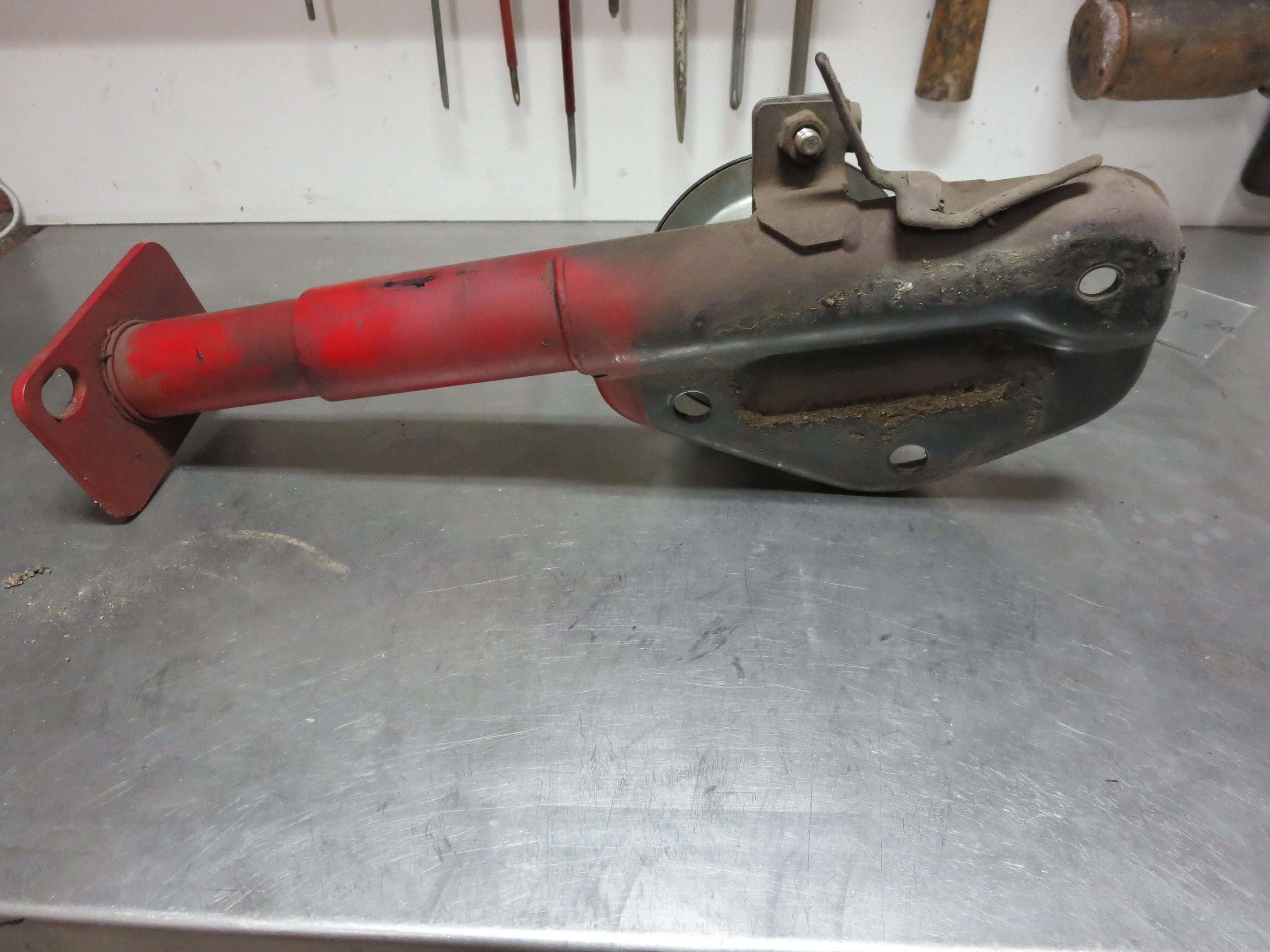

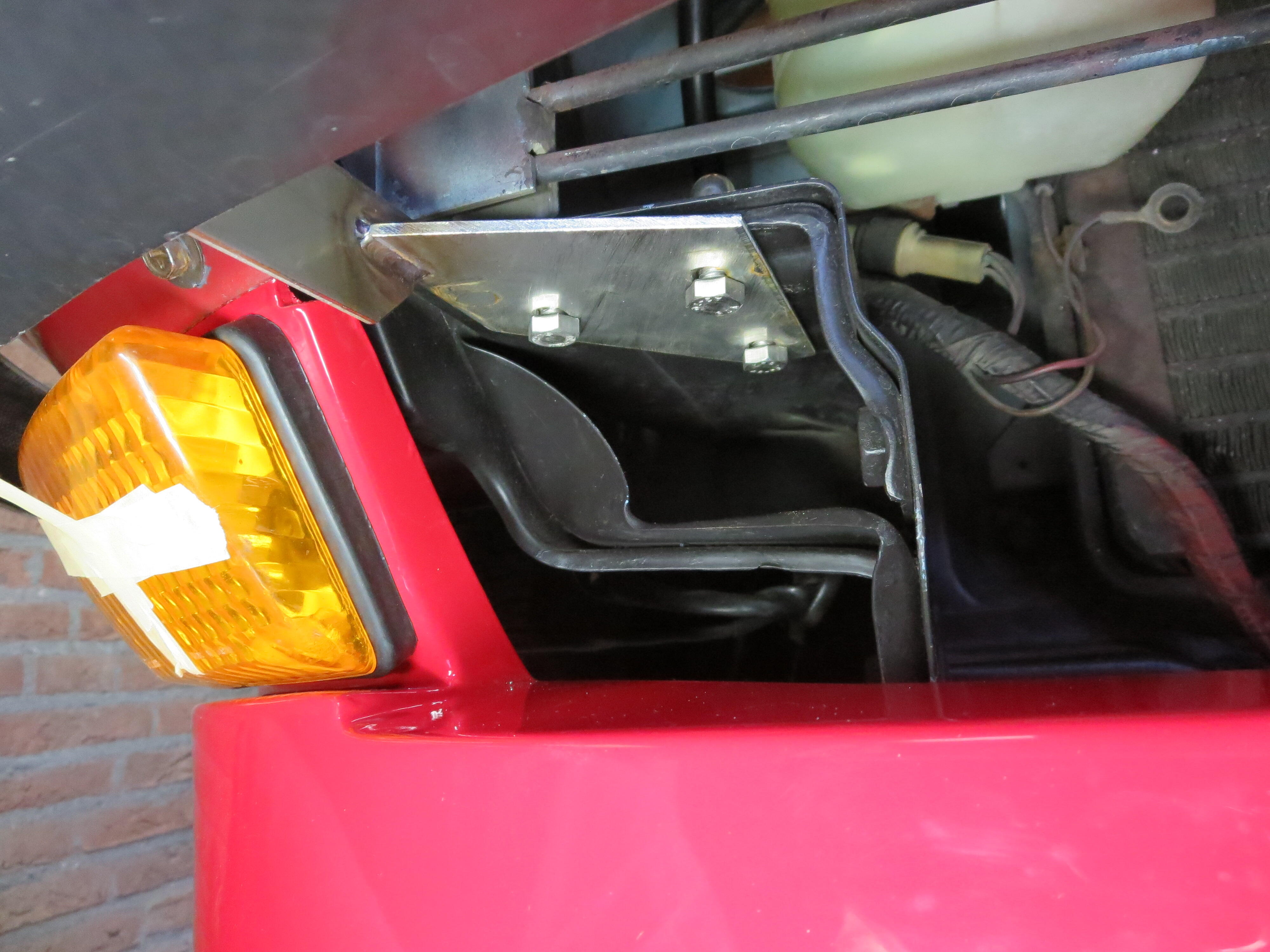

 Yeah , both shock to bumper and shock to fenderwell appear to have a different bolt pattern. If I was installing it, I doubt it would be much of a problem. If it was mine I'd be installing 240 bumpers. I wonder if this is one of those parts that changed mid-year? I think it's time to contact Redwing and ckurtz2 and compare the bolt patterns on the 76 chassis and the 77 bumper.
IMark, If you need photos of the 77 bumper shacks, I can take as many as you need. I still have the old bumper and shocks, but no ends. Gave them to the Captain. Jai could have it all for free, but shipping would be out of this world.

The bumpers are very different . The early pre august version does not compress as much as the later version. Thatis way the shockslook a lot shorter in carpartsmanual, the bumper does not push in as far.
That being said, you can change a later model 280Z back to the early version if you have all the parts. The bolt pattern for mounting the shocks are the same on bothversions. So if you have all the components from a early model it would work.
The bumper components are not interchangable. The shocks, chrome section and rubber ends are all different.
