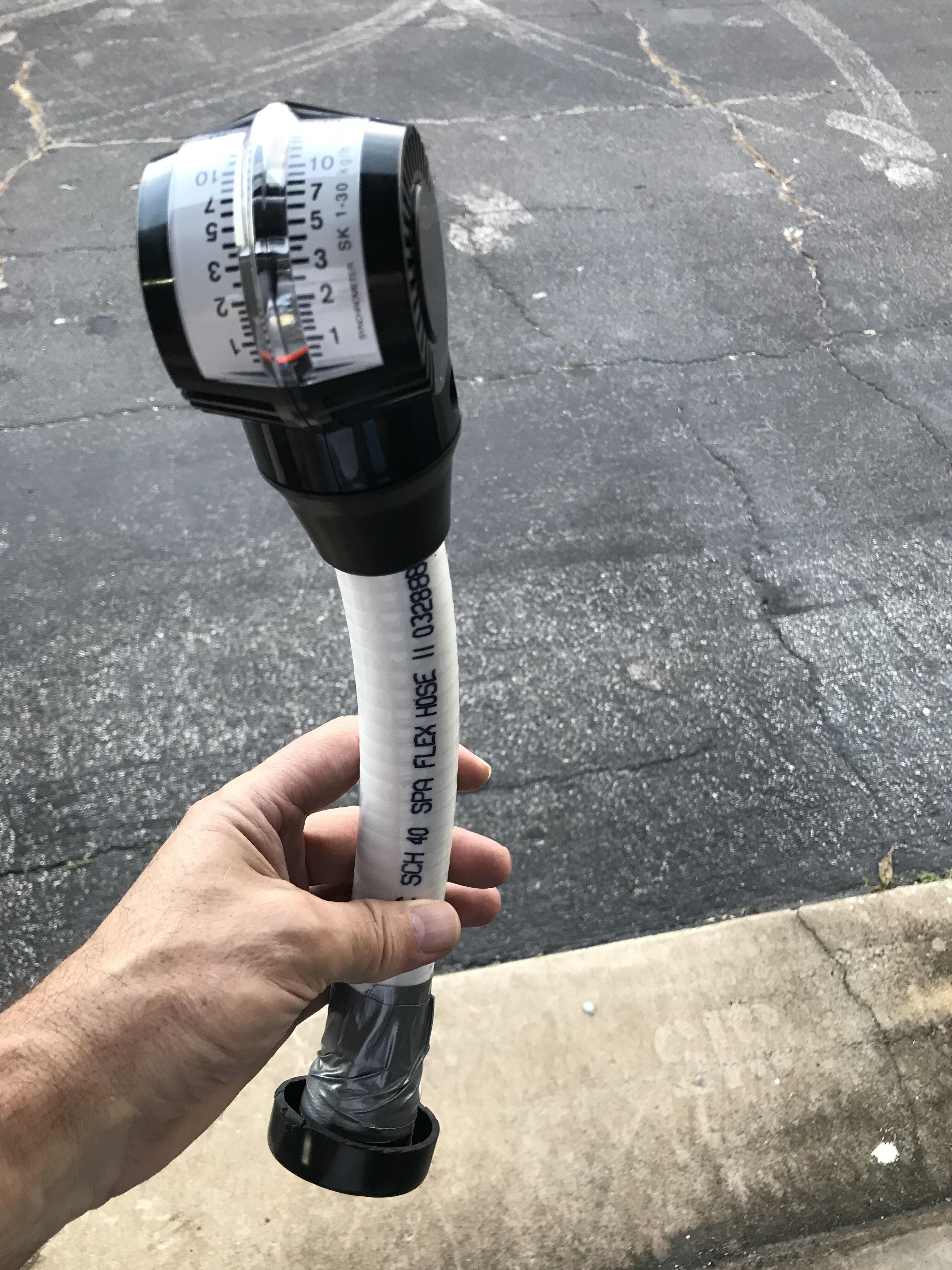

Have you a way to meter the air flow, balance that? These are great and fairly cheap.

  • Adjust the carbs - to include balance (with airflow meter) and Colortune.  The pic is a little device I rigged during my MGB days.  The end that contacts the carbs bends to accommodate tight spaces.
