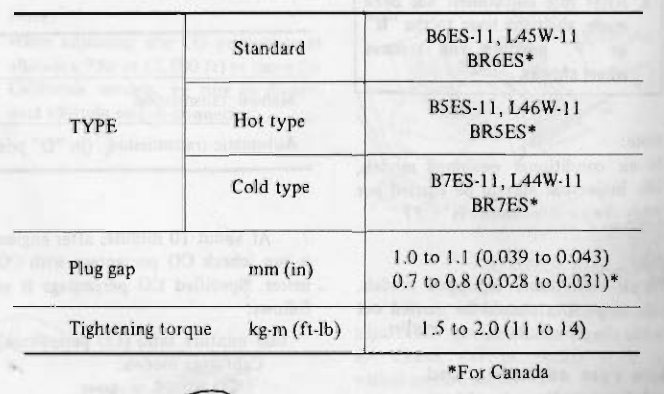

I have a 240Z with L28.  It has a  240Z distributor with electronic points and SU Carbs,
Do I install and gap plugs based on the 240Z ignition/fuel OR 280Z combustion?
I got the information below from zcarguide.com
ModelSpark Plug Gap (Range)
240Z 0.8mm-0.9mm, 0.031-0.035in
260Z 0.8mm-0.9mm, 0.031-0.035in
280Z 1.0mm-1.1mm, 0.039-0.043in
Edited by HappyZ
https://www.classiczcars.com/topic/66382-240z-with-l28-motor-spark-plugs/
The Ignitor II is an adaptive dwell system, AKA current-limiting.  If you use it with the low resistance coil they suggested, the FlameThrower II (primary resistance 0.6 ohms), you should be able to use the larger plug gap.
1978 had the first "adaptive dwell" system for the Z's, I think.  At least they trusted it enough to run enough current to open the plug gaps.  The 1978 spec should work for the Ignitor II.
Some people like to run the projected tip plugs but I'm not sure it makes a difference.  Not sure why Nissan changed, maybe due to detonation issues with the leaner EFI systems.  Just a guess.
