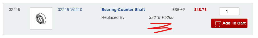

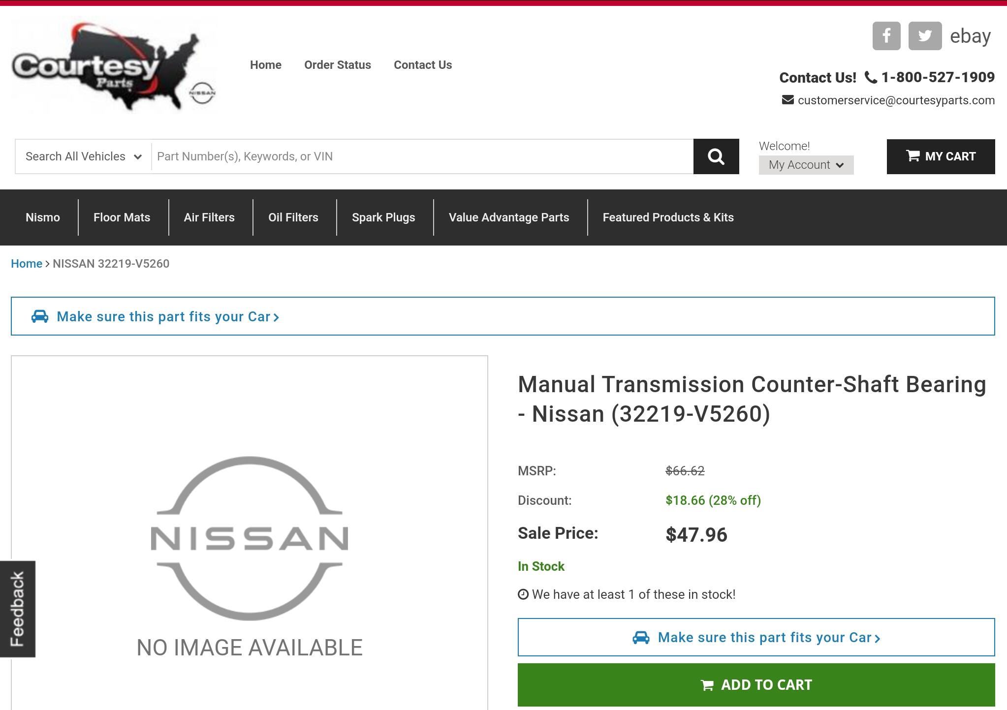

https://www.classiczcars.com/topic/66434-part-num-needed/
