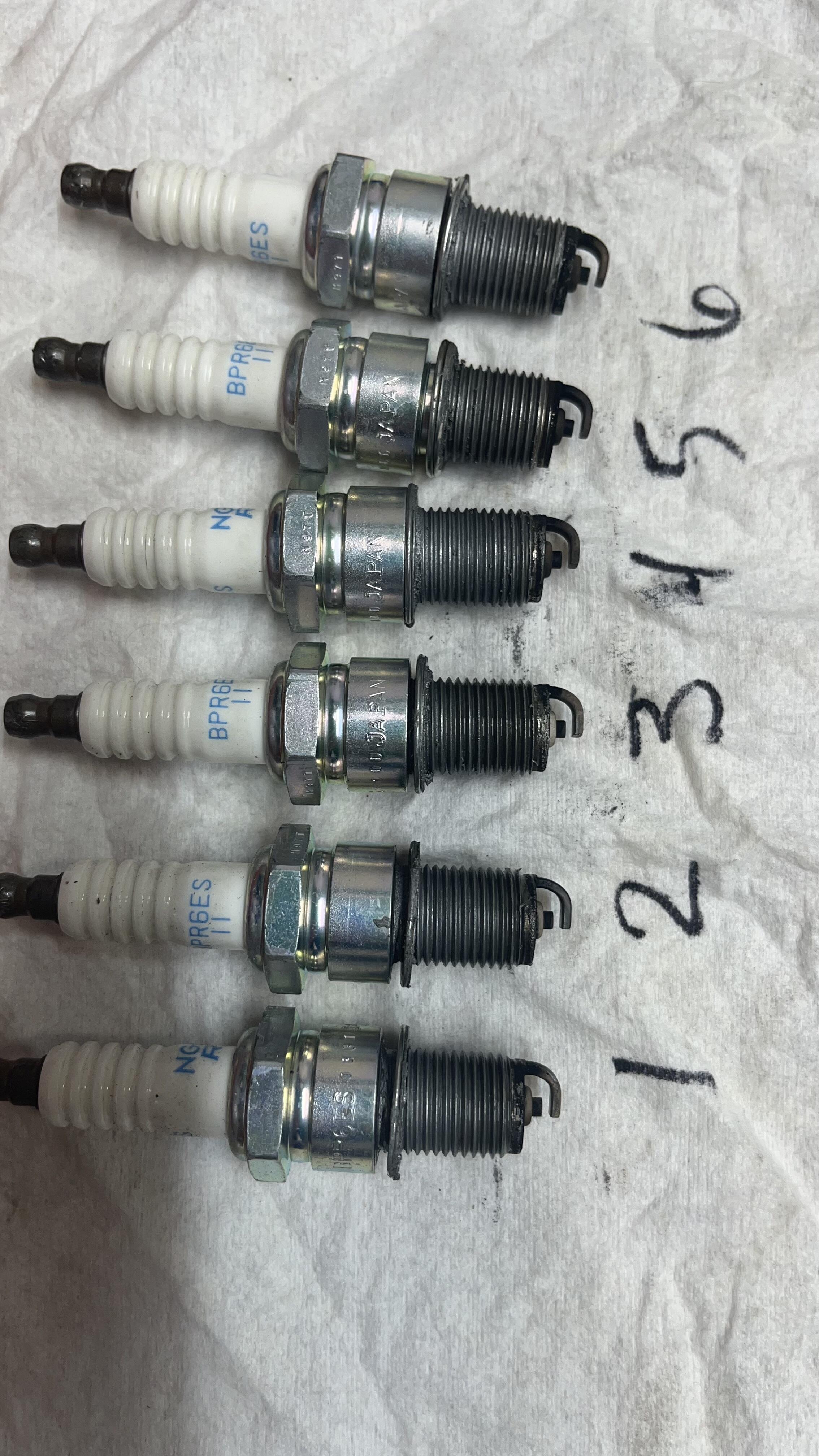

Today is test day.  I’m going to run the car around and see if I can shake out any more bugs.  Yesterday, I re-torqued the head bolts from the rebuild and about half of them did tighten a bit (set 60 ft lbs), adjusted the valve lash and replaced the spark plugs.  About 9 valves needed to be adjusted.  7 had too much clearance and 2 not enough but all were within .001 of the cold specs.  (my back hurts now from that)
The old plugs were fine but my local parts store had the NGK (BPR6ES11) in stock for $3 each so I grabbed them, only needed 4 because I had two remaining when I bought the 8 pack last time. Just doing my part to help the economy.
