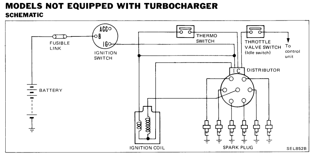

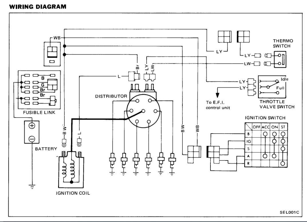

I'll just pile a couple more things in here for anyone with an E12-92 in the future.  Notice the idle switch and the thermo switch connected at the "IC".  Somebody with electronical experience might have fun figuring out what Nissan was doing here.
