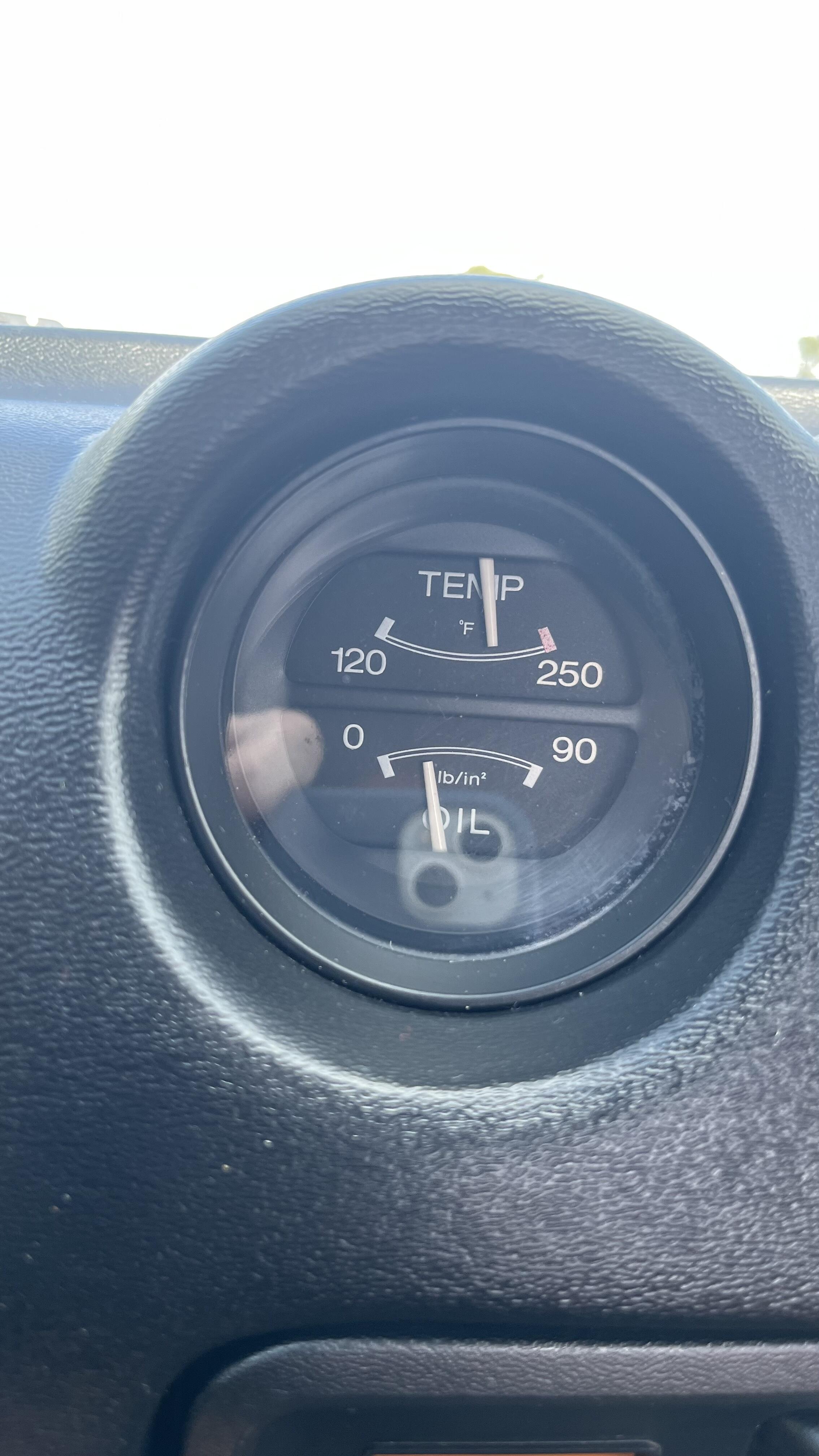

Okay, I get what you’re saying and yes it appears the timing has changed with the HEI on.   Warmed it up and put my timing light on and it was off about 3-4 degrees (retarded) at 800 rpm.   I reset it to 10 deg and she’s now even running smoother,   I took it out for a 30 miles drive and had no issues.  Well, I thought I had one but I’m coming to believe my temp guage or sender  it’s very accurate.  I bought a radiator cap with a thermometer in it as a back up and it was showing much cooler than the temp guage.   Took my son through a drive through  for lunch and them temp gauge really creeped past mid range.  I pulled over and the cap on the radiator was reading about 180 ish.  So I’m missing the lower half of a fan shroud and don’t currently have the lower skid plate installed, not sure if that’s a factor.   I’ve kept it off until I take the car to a shop to make sure the alignment is good.   I did it the good of’ boy method.  Eye ball it while drinking a beer, but she tracking  perfectly.  Maybe I should drink beer more when working on the car.  It got even higher than this pic my son took.

just curious is then temp sending unit the one piece type or the two piece? I recently installed the 1 piece and it seems to indicate higher than the actual water temp using a thermometer.
Well when typing in a small phone with big fingers and “auto correct”  turned on mistakes are made.  I🤓
Dave the sending unit is a single female type bullet connector.  Is this the one you’re talking about?
