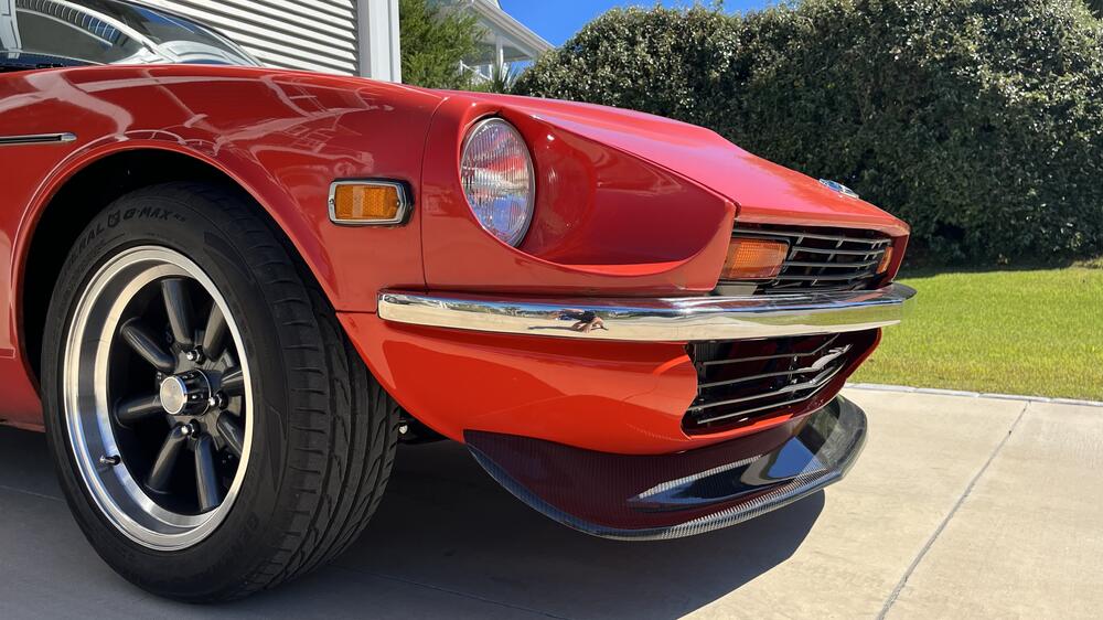

Nice 280z you got there!  I think i need such a spoiler/front lip too..  At 210 on the german highway the car wants to take off a bit hahaha.. yeah kilometers.. not miles!

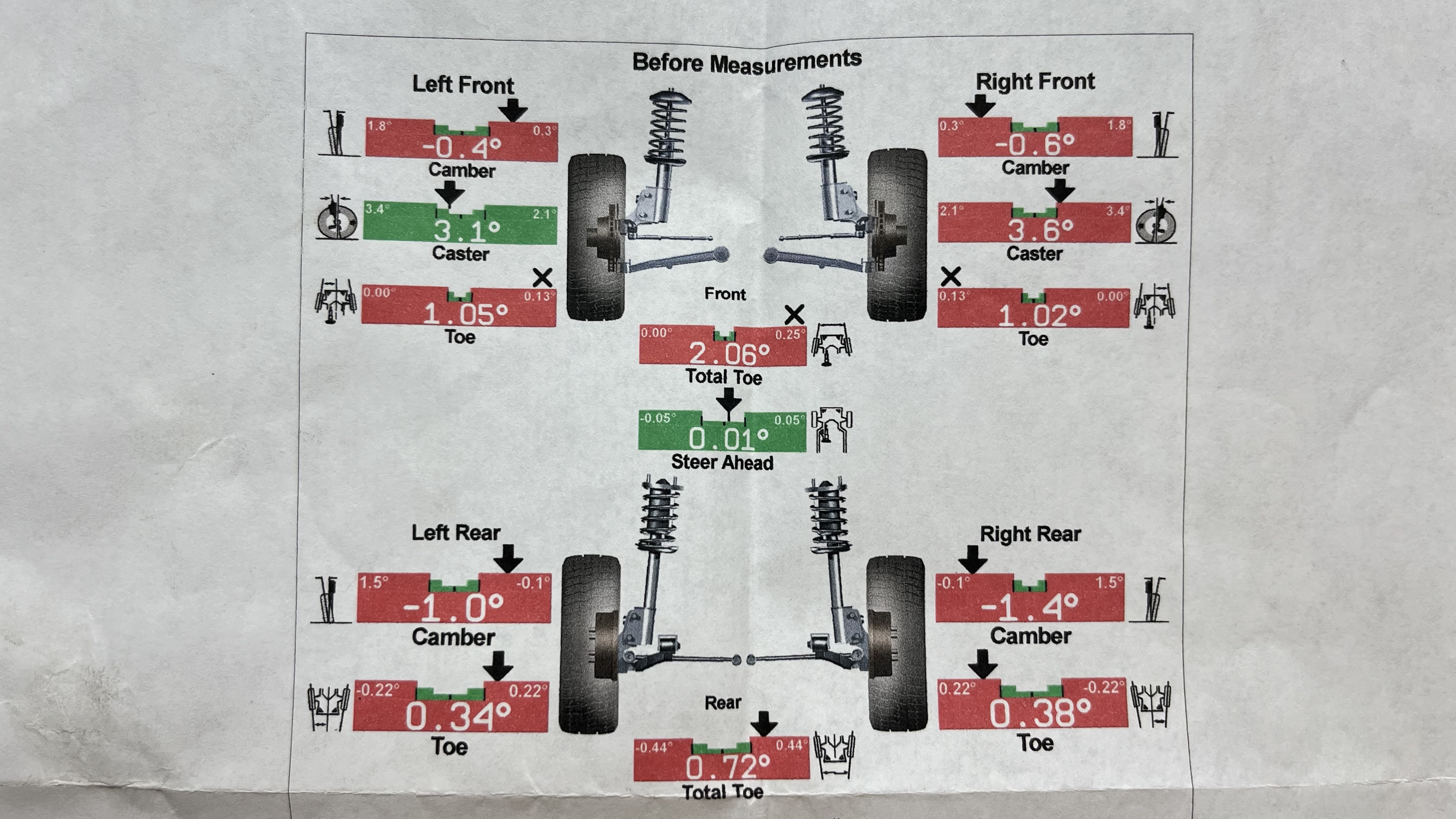

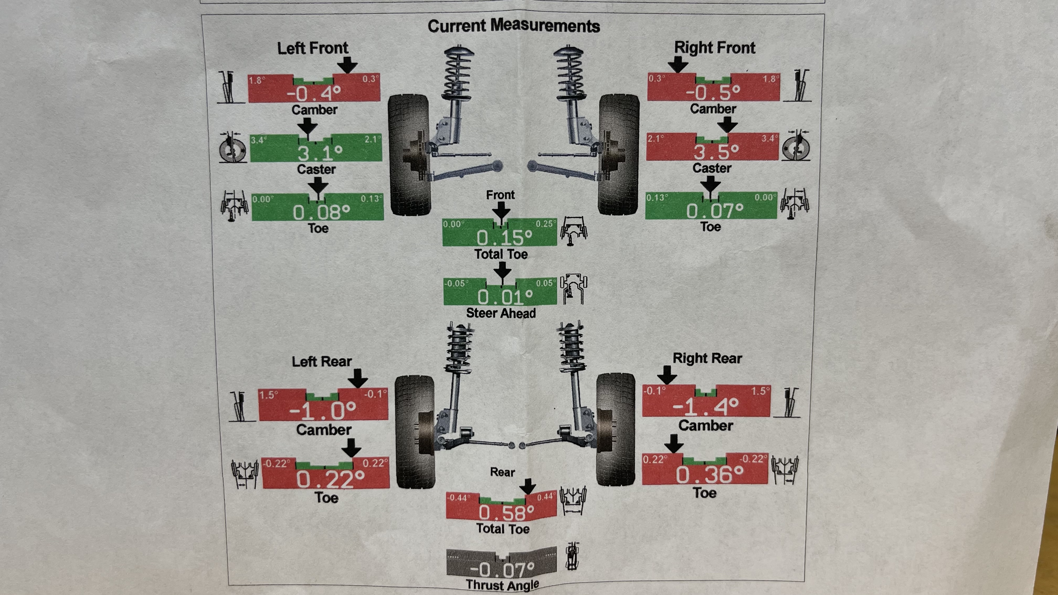

Wanted to share my experience with getting my front end aligned.  So I took the car to a local shop with a great reputation, had them do other work before on my other vehicles.   Anyway dropped it off yesterday morning and it sat there all day and they didn’t finish it until this morning (had a sick mechanic).  I really wanted it done yesterday because the East coast got hammered today with a big storm today and I didn’t want to drive in the pouring rain.   Once they finished the work they parked it outside in the downpour.😞
So the alignment was was out of whack, which I expected since I rebuilt the entire front end and reconditioned the steering rack.   Here are the before and after, you can see the camber numbers..   Of note for those using lowering springs that your camber will be off.   He said I was in the limit but said it would be fine.   Attributed it to my lowered springs.   Drove it home in the rain like so stole it.   Driving so nicely, but nos she’s all dirty.   😩
