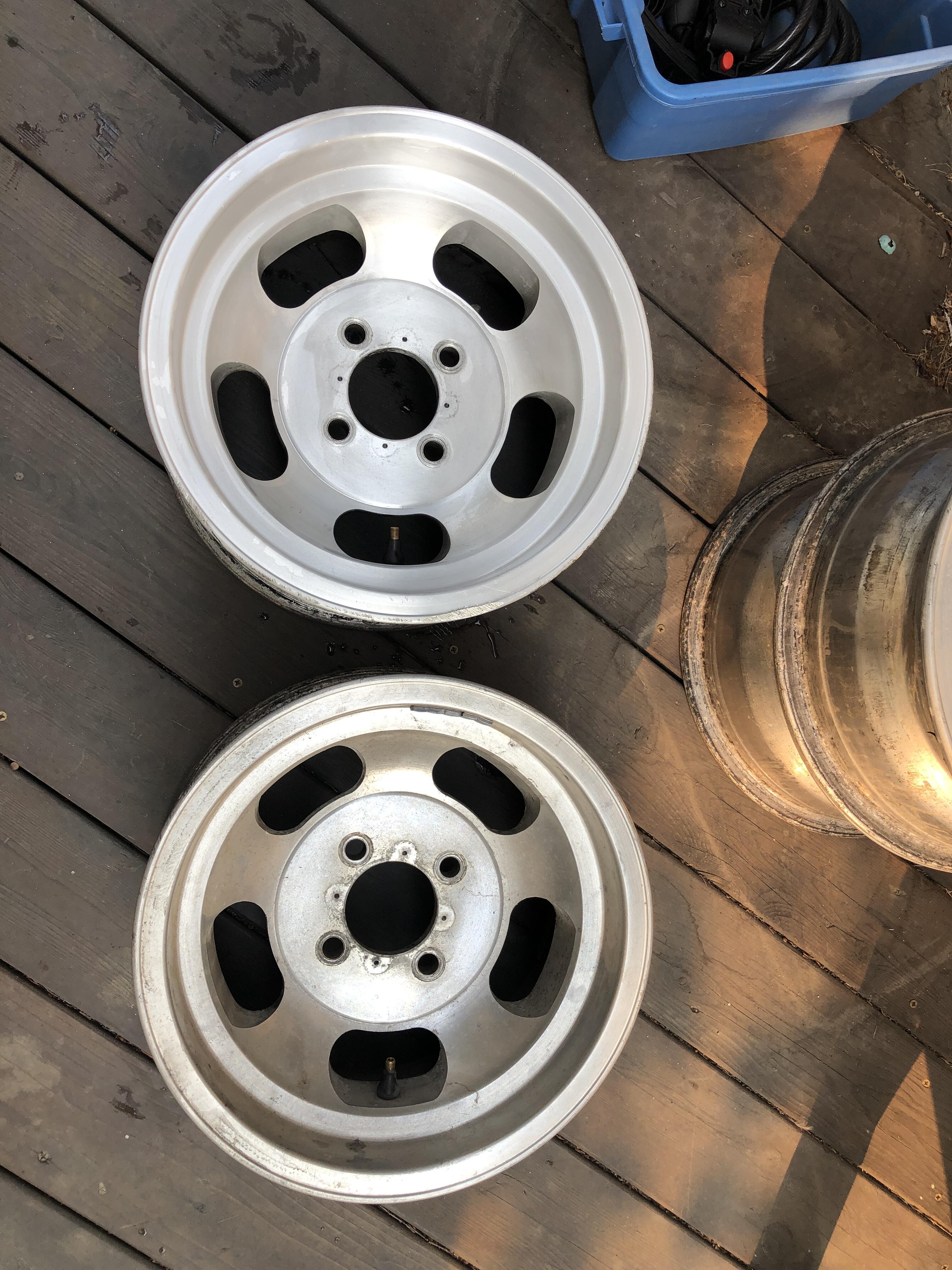

Hi all!
I have these on my 240 and was hoping for some advice on cleaning these wheels.  I would hate to ruin them by using the wrong cleaner.  Some say Simple Green, others say a harsher chemical.  Some say steel wool.  Any advise is appreciated!
Thanks!!
Bill

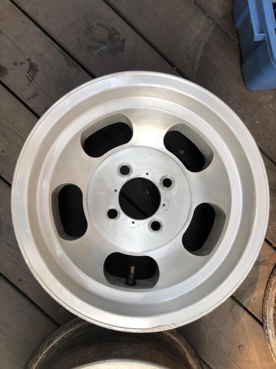

I have a set of lovely original D-slot mags on a 71 that I’m restoring, and this stuff took them from grim to perfect in the fastest easiest way I’ve ever imagined. This stuff is seriously bad for you, the instructions have scared me away from even trying it until today, but damn, it does what it says it will do. Just ragged it on, scrubbed the grime with same gray scotchbrite scrub pads then rinsed it off. 15 min per wheel tops. Obviously you have to the clear coat off first, not sure these ever had any.
