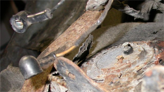

Luckily, I have pictures of just about everything I've taken off my car. Attached is a closeup of my fuel sending unit, and the two wires. I intentionally pointed one of the connectors toward the camera, since I was very surprized when I took it off. I figured that the plastic cover was covering up a nut, kind of like at the alternator. Anyway, the connectors are kind of like a spade, as kmack suggests. The posts fit up into the connectors, and are trapped between the two edges. Hopefully the picture shows it better than words...
