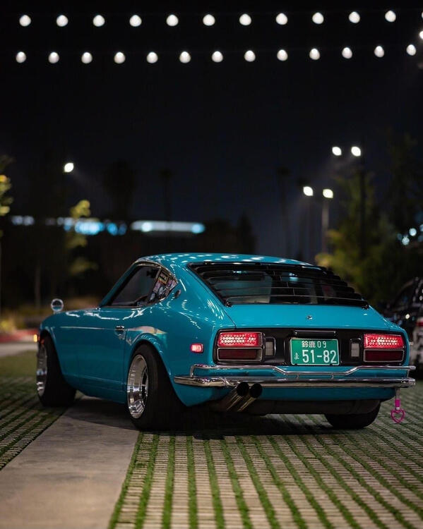

What wheel tires combo is this? (Mine 77 280z)

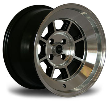

I run 15x8 zero offset on the front and 15x9 -15 offset on the rear with 1 inch spacers on my ZX. I have T3 coilovers.  It is my understanding that most fitment specs are the same across the S30-S130 range.

And what tire specs do you have here?
