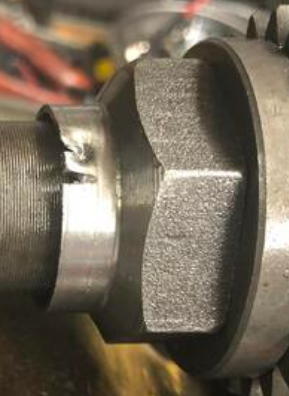

1. my trans doesn’t have the oil gutter. Should I put one in?
2. Only able to find cluster hex nut https://www.transmissionpartsdistributors.com/fs5w71-transmission-nut-for-cluster-shaft-fits-86-nissan-nis-220/?gclid=EAIaIQobChMIkavUq9ag9wIVPg2tBh3-hAYFEAQYAiABEgJR4vD_BwE
3. it sounds stupid to reuse the main shaft nut if I cannot find replacement.
both hex nuts are normal, right hand threaded

4 hours ago, 240zadmire said:
Few other questions.
1. YES. You should fit a gutter.
2. ?
3. Not sure which transmission you have. Have s look in the document in link.
Not sure if this transmission is worth rebuilding with the costs of a new input shaft, main shaft, 3rd/4th hub and bearing kit. Might be better to find snother and pick the best parts of the two and add a bearing kit.
I believe the 27mm RH thread nut is NLA. There were a few offered here on the site by members that had some machined up

You could reuse the nut if you didn't destroy it when removing it.  Just peen over a different spot or use red Loctite.

Thats what I fear the transmission is unsalvageable…. The most damage is the main shaft’s end where the pin bearing caused havoc.  I use 500 grits and it feel reasonably smooth.   The synchro hub is ordered and on its way.
