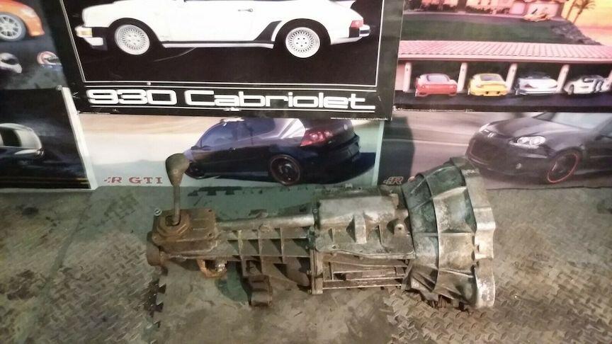

240zadmire Posted April 20, 2022 Author Share #54 Posted April 20, 2022 I can identify the 2” shifter mount, the output shaft with shorter shroud. The diamond shape reverse lock. The single exhaust mount point. The 6 o’clock speedometer nut. The housing seem to be correct unless the internal gears are swapped to wide ratio, I’d say this is closed ratio. What do you say? of course I still keep other options available too Link to comment https://www.classiczcars.com/topic/67383-1977-280z-with-fs5w71b-transmission/?page=5#findComment-639551 Share on other sites More sharing options...

240zadmire Posted April 20, 2022 Author Share #56 Posted April 20, 2022 I think the transmission above is still FS5W71B close ratio rather than FS5W71C. Am I correct? Link to comment https://www.classiczcars.com/topic/67383-1977-280z-with-fs5w71b-transmission/?page=5#findComment-639554 Share on other sites More sharing options...
Zed Head Posted April 20, 2022 Share #57 Posted April 20, 2022 1 hour ago, 240zadmire said: I think the transmission above is still FS5W71B close ratio rather than FS5W71C. Am I correct? Do you know what vehicle it came from? There are truck transmissions with similar features. It definitely looks from the 280ZX time frame. The only words you've supplied are "82 71C" though. What is the full description? Link to comment https://www.classiczcars.com/topic/67383-1977-280z-with-fs5w71b-transmission/?page=5#findComment-639560 Share on other sites More sharing options...
240zadmire Posted April 21, 2022 Author Share #58 Posted April 21, 2022 He is not 100% sure whether it's a '82 or '83 280zx and provided the pictures above. Sorry for the confusion that I keep refer to the close ratio transmission as FS5W71C. The photos above seem to suggest it is a FS5W71B close ratio, if I'm correctly match up the characteristic as @EuroDat PDF. regards Link to comment https://www.classiczcars.com/topic/67383-1977-280z-with-fs5w71b-transmission/?page=5#findComment-639561 Share on other sites More sharing options...
Terrapin Z Posted April 21, 2022 Share #59 Posted April 21, 2022 82 and 83 are the same, 79-81 were more like the earlier 280Z optional 5 speed. Different gearing. The C looks very different around the shifter and has a lot more strength ribs on it. See pic from eBay. The one above^^ looks like an 82-83 version. Link to comment https://www.classiczcars.com/topic/67383-1977-280z-with-fs5w71b-transmission/?page=5#findComment-639565 Share on other sites More sharing options...
EuroDat Posted April 21, 2022 Share #60 Posted April 21, 2022 (edited) On 4/21/2022 at 2:04 AM, 240zadmire said: He is not 100% sure whether it's a '82 or '83 280zx and provided the pictures above. Sorry for the confusion that I keep refer to the close ratio transmission as FS5W71C. The photos above seem to suggest it is a FS5W71B close ratio, if I'm correctly match up the characteristic as @EuroDat PDF. regards It's a FS5W71B close ratio. The speedo bolt is located downwards, one exhaust hanger ear on drivers side and reverse lock out on drivers side. The 71C would have a completely different gear selector on top. The ebay photo above is not a 71C. Looks similar, but it's a BW T5 Edited April 23, 2022 by EuroDat 1 Link to comment https://www.classiczcars.com/topic/67383-1977-280z-with-fs5w71b-transmission/?page=5#findComment-639569 Share on other sites More sharing options...
