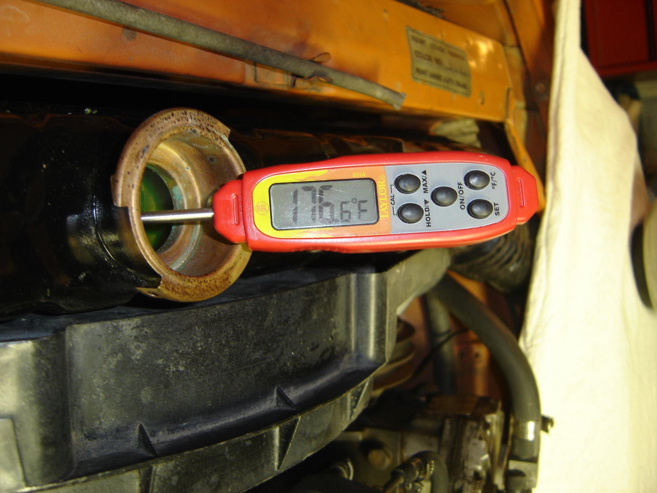

kully 560 Posted April 22, 2022 Author Share #7 Posted April 22, 2022 I just picked up a digital cooking thermometer and placed it in the radiator under the cap and the fan come on at 172 degrees.I purchased a 200 degree on and a 185 degree off , I can not believe for the life of me that is off by 30 degrees . it is made by american volt company. go figure I guess I will look on amazon for a different brand . I did try to buy usa go figure. when the new sensor come here I will post my report thanks kully 1 Link to comment https://www.classiczcars.com/topic/67426-cooling-help/#findComment-639609 Share on other sites More sharing options...

kully 560 Posted April 30, 2022 Author Share #11 Posted April 30, 2022 just for an update, I did install the new sensor switch which is 200 on and 185 off in the thermostat cover. with a digital probe in the top of the radiator the fan turns on now at 209 degrees but does not turn the fan off with temperature down to 174 degrees, that was tested in my garage. now driving around town and highway the fan never kicks on at all and my temperature gauge is at the start of the m in the temp word. I did order 2 sensor switches at the time to compare them both and both have the same results. the outside air was dry and around mid 60s. I would like to have been closer to the 200 degree on, and even 180 off would have been nice. I guess when it does get warmer here like 90s I will see what happens. I may have to go to a adjustable controller. but I really like just having just 1 relay, 1 sensor switch, and a bypass turn on switch in the cabin . all of the fan adjustable temperature controllers that I have seen are not waterproof and need to be installed in the cabin. the car never see the rain unless I get caught in it. Link to comment https://www.classiczcars.com/topic/67426-cooling-help/#findComment-639861 Share on other sites More sharing options...

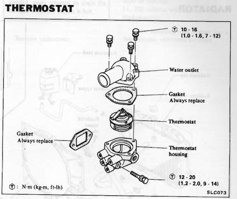

Zed Head Posted April 30, 2022 Share #12 Posted April 30, 2022 Pictures would be neat of the cover Sensor part numbers or links too. I can't find any sign that Nissan made a thermostat cover tapped for a switch or sensor. 1983 Link to comment https://www.classiczcars.com/topic/67426-cooling-help/#findComment-639863 Share on other sites More sharing options...
