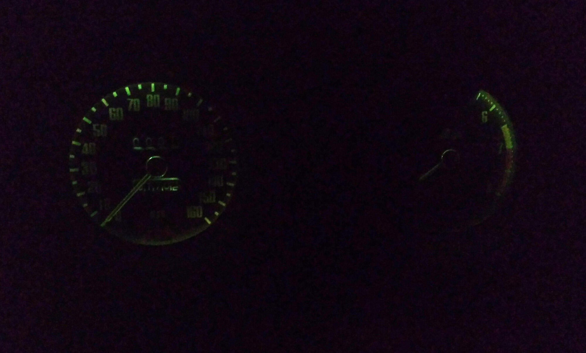

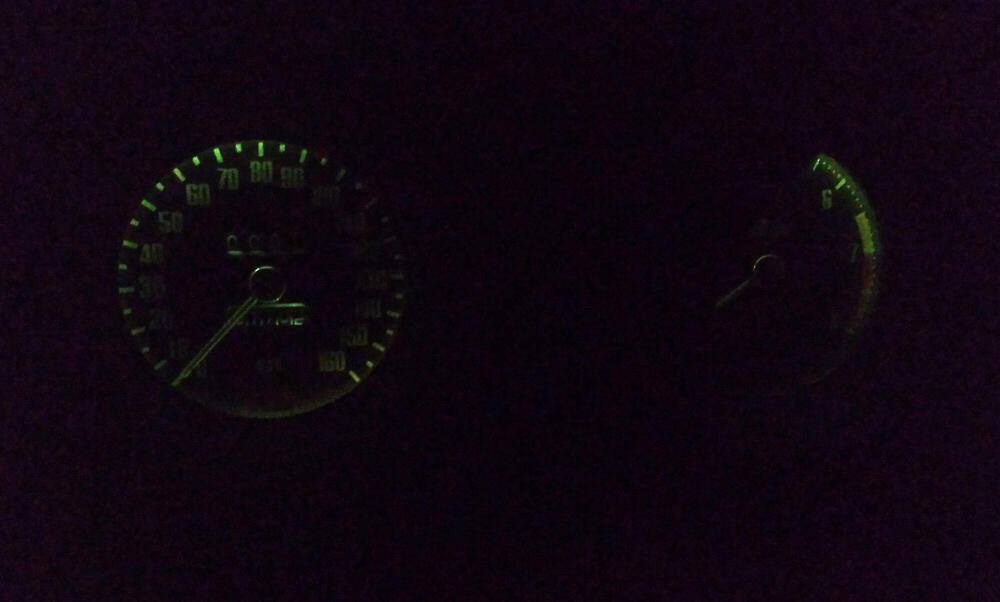

You love to see it...
(I promise the rest of the tach lighting is on—just didn't come through in the pic—as are the 3 dash-top gauge lights)

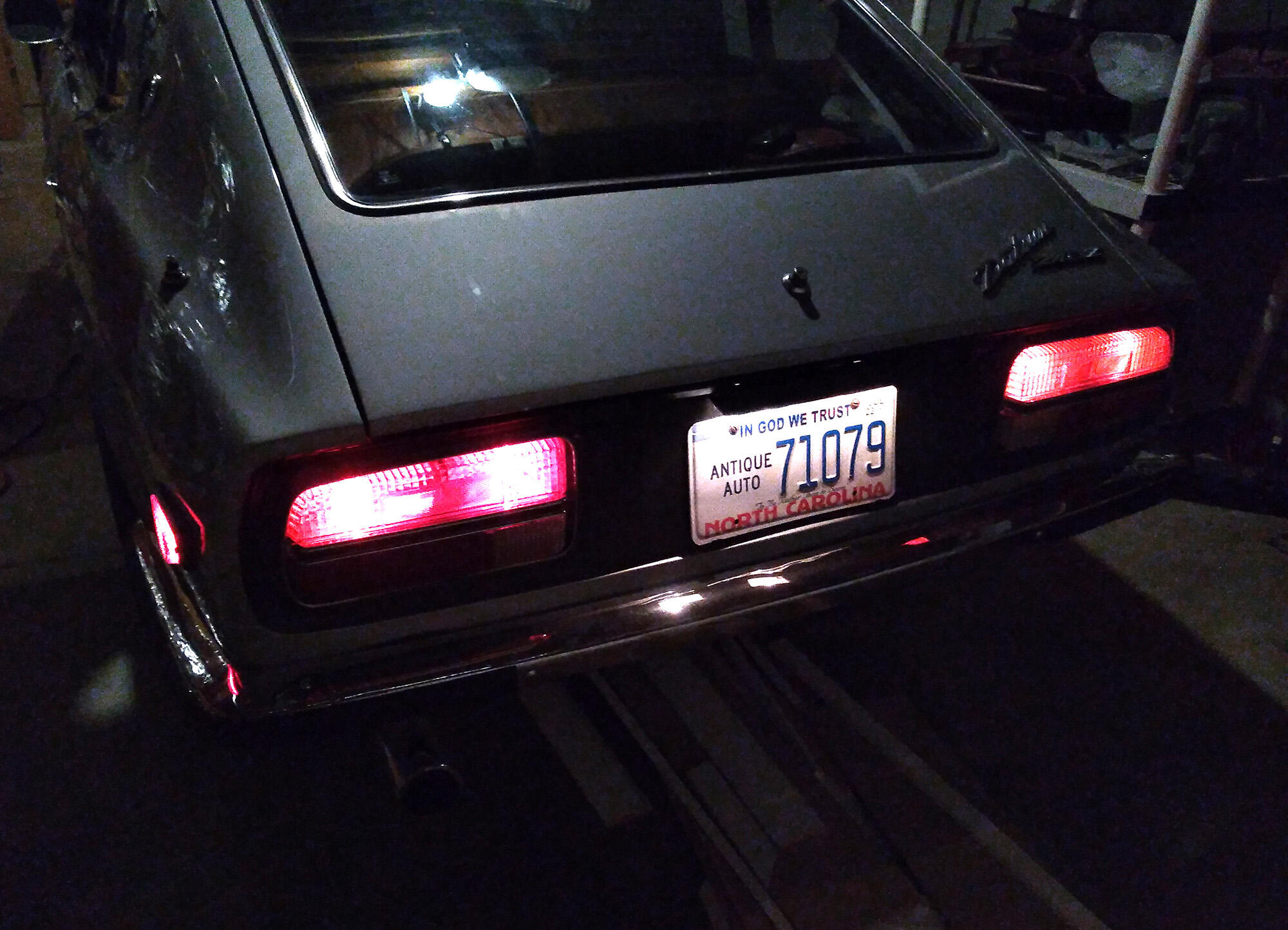

So that's done.  Still no brake lights though, and while the turn signals work on the right side, only the front left works.  I've checked and re-checked the wiring; will keep at it tomorrow.  Just wanted to share progress and a couple of pics.

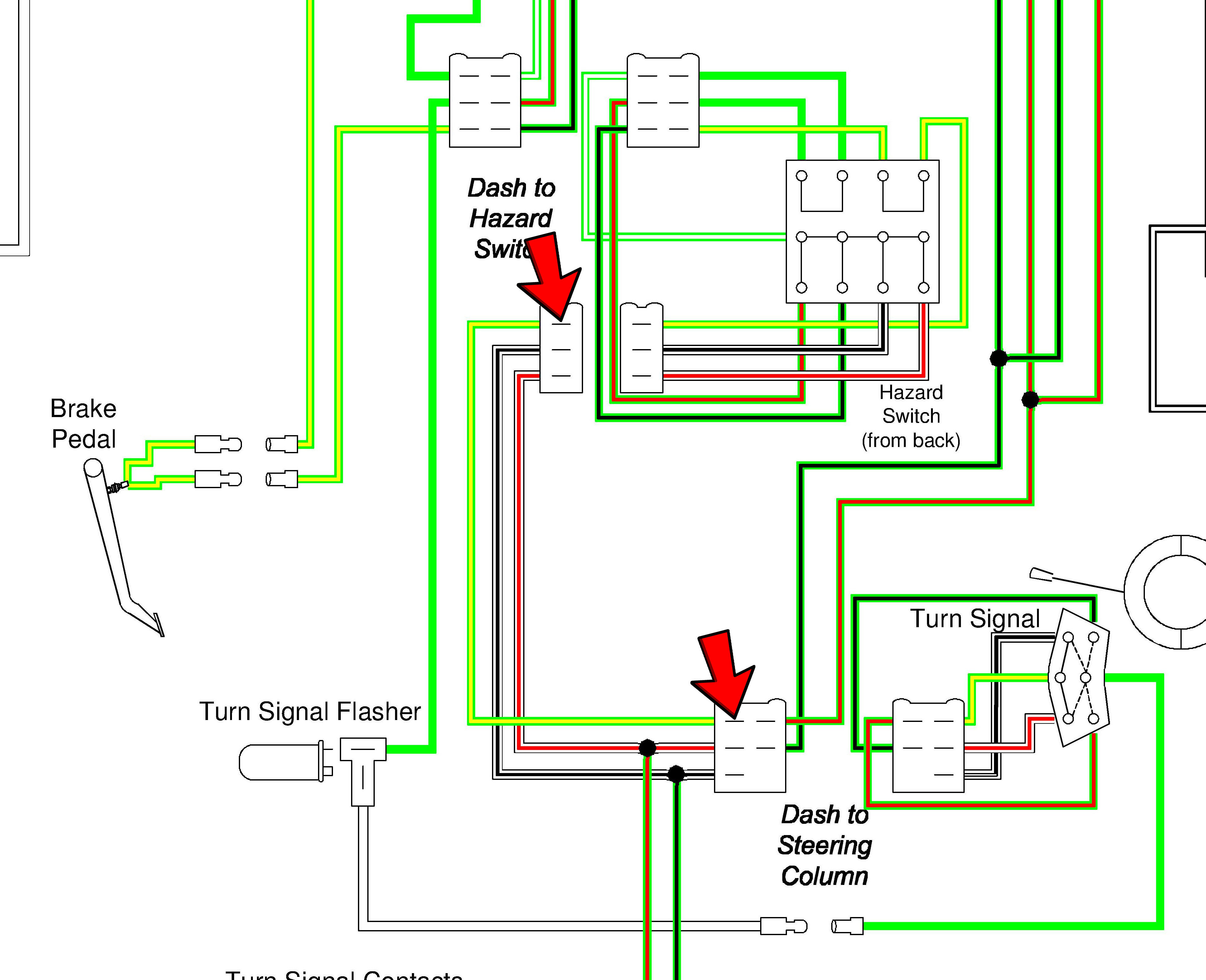

Using the below as a reference (thanks so much Steve!) I checked the continuity of each taillight-related wire from connector to connector:
Continuity was good between everything EXCEPT for the below:
I ran a wire between the connections and the brake lights came on when I pressed the pedal!  However—when I tried the turn signals, both lit up when I turned to the left, and the right one illuminated (correctly) when I turned to the right.

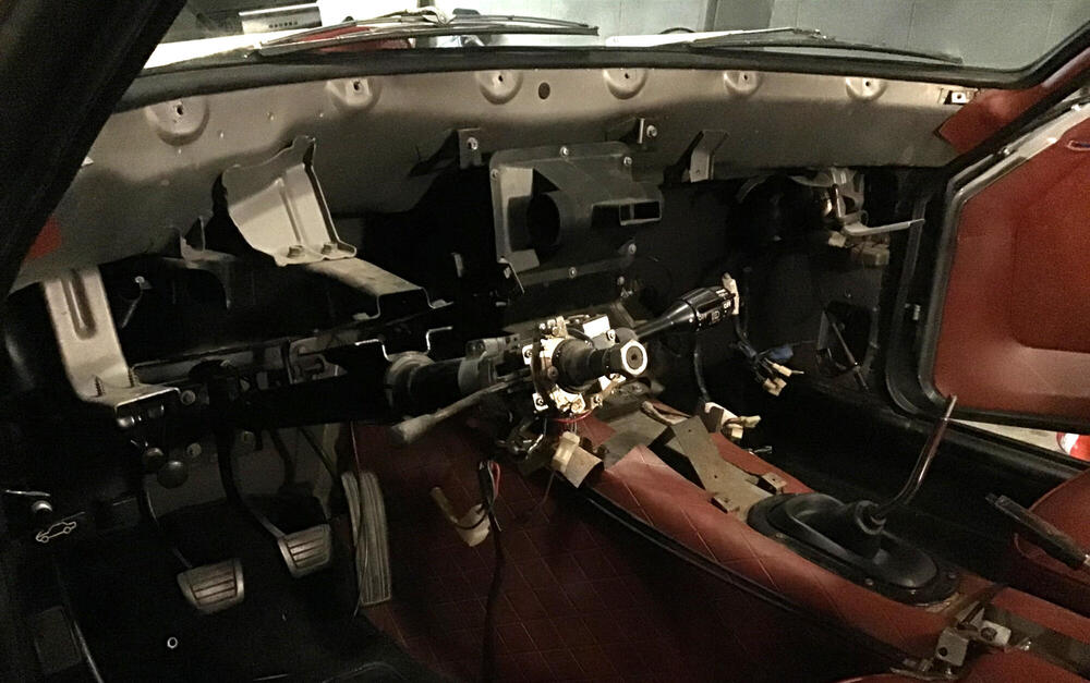

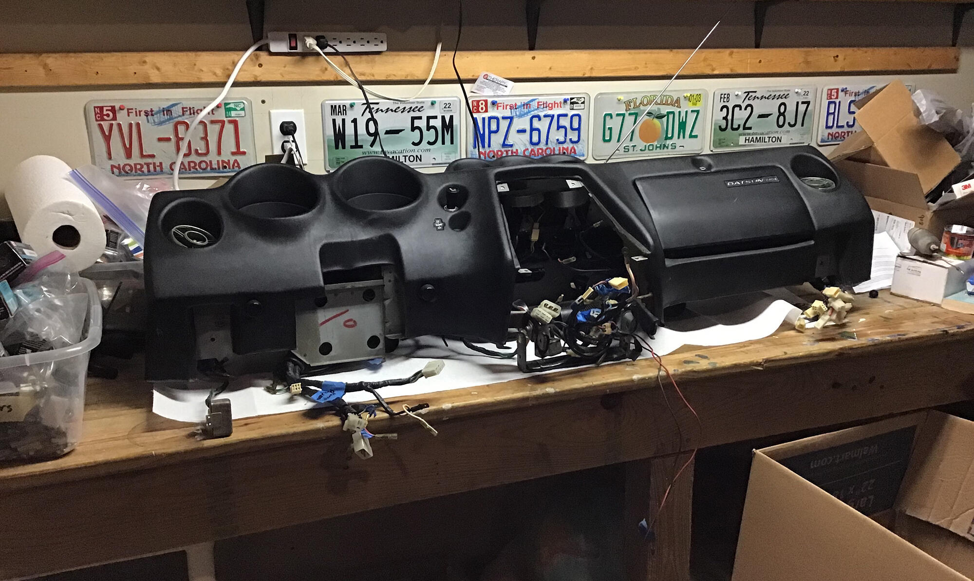

25 minutes later, and...
Dash is out.  (sorry about the mess)
Going to flip it over tomorrow and see what's what.  Will report back.
