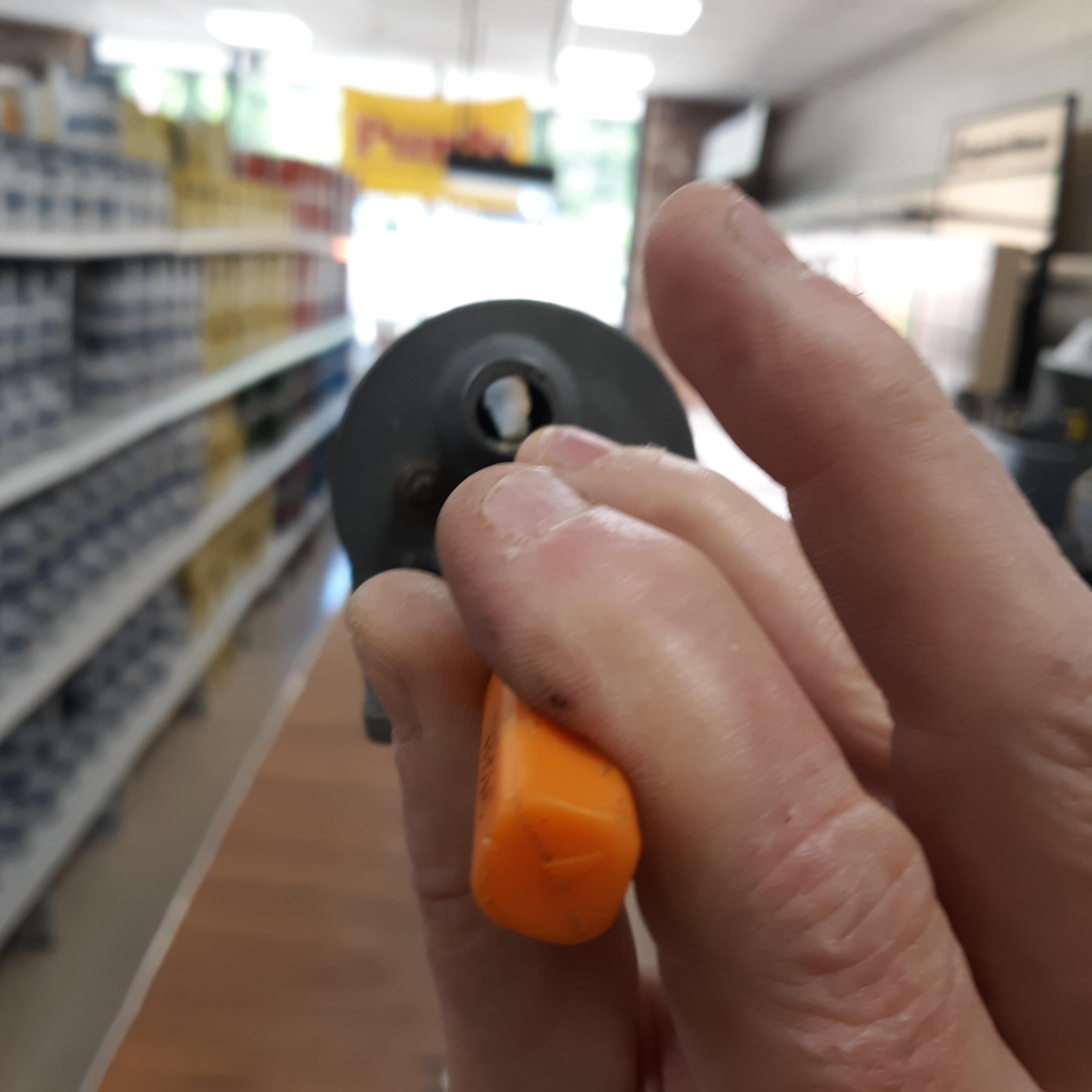

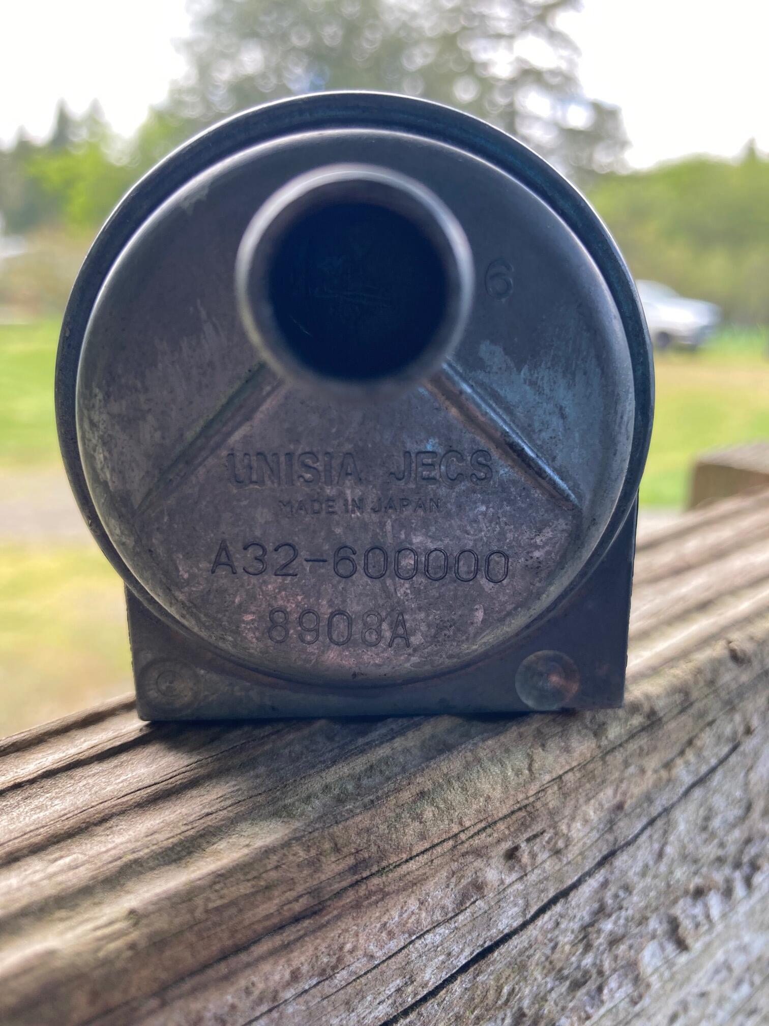

4 hours ago, siteunseen said:
I guess it twist when 12V hits it?
It bends (the two different metals expand at different rates) and pushes on the edge of the metal plate, causing it to rotate.  You can see that the bimetallic strip is not in line with the passage, it's next to it.  If you dropped your orange screwdriver down to the next hole you'd see what gets pushed when the strip bends.  I can't remember exactly how the parts fit together.
Couldn't tell where the blade was.  Anyway, a picture through that hole would show what the bimetallic strip pushes when it bends.
All interesting stuff, digging in to the guts of the parts.  But, with no power through the circuit, he'll have to wait for engine coolant to heat things up and cause the strip to bend.

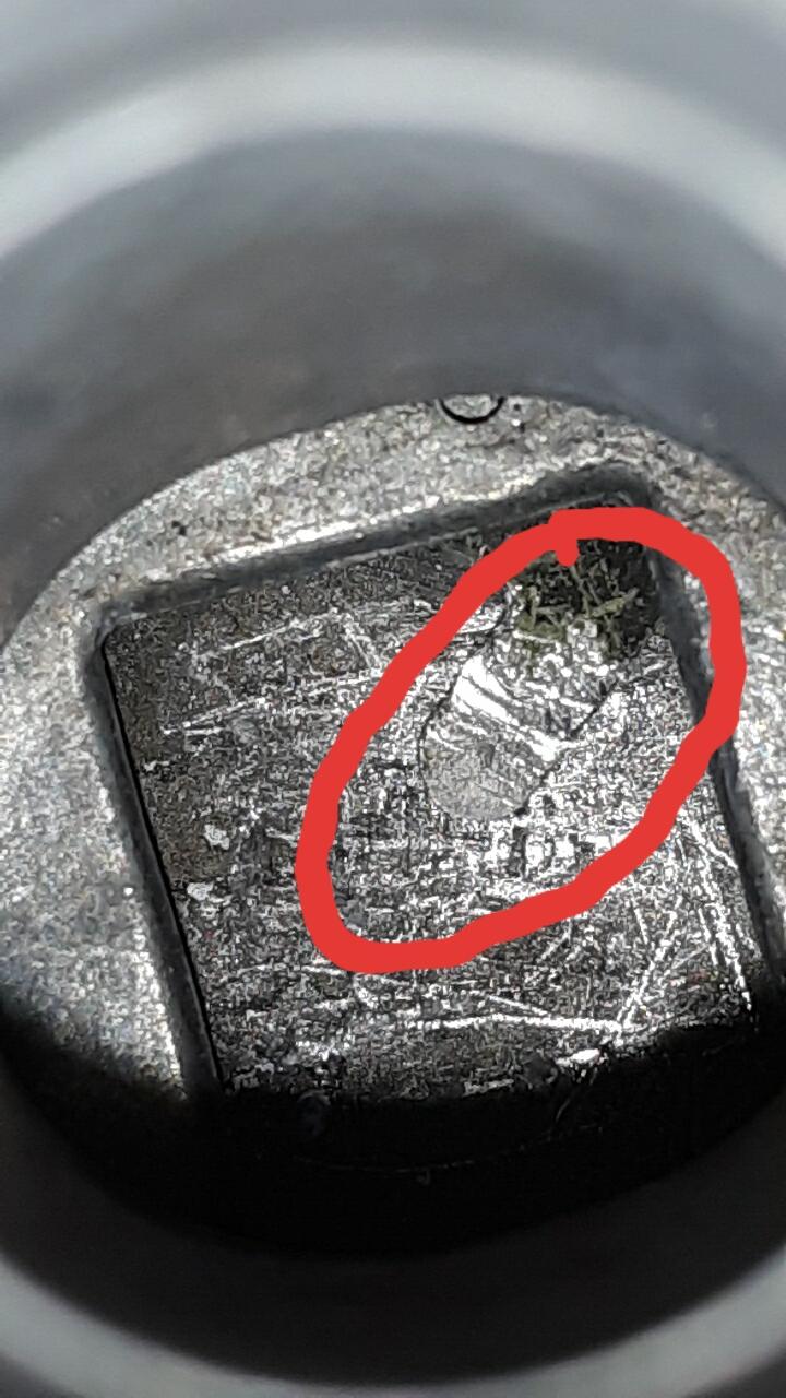

We're almost om the same page. LOL
This is a magnified picture into the larger bottom hole. Inside this red circle is a little arm that moves clockwise to open the blade in the smaller top hole about halfway to let air through, raising the rpms.
It's hard to see but it's there. Looks like a flacid penis pointing to the left. ROFL
I'll put 12V on the blade later and see what happens. Must mow grass and drink cold beverages first.

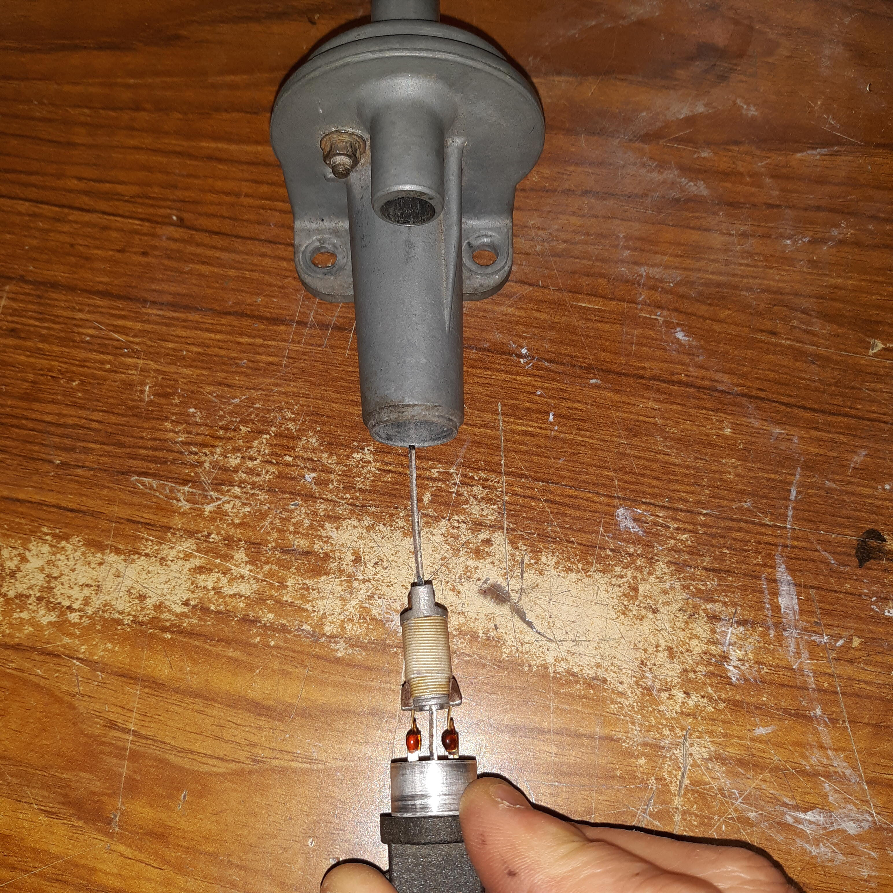

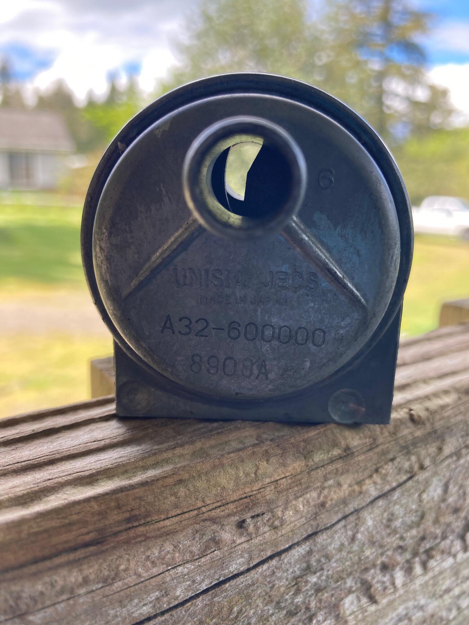

On 5/10/2022 at 9:30 AM, siteunseen said:
Here's some pictures I made this morning of one I had
 It's closed at 60F. The red circle is what opens the top hole by way of the blade with the windings on it. I guess it twist when 12V hits it?20220510_075609.jpg

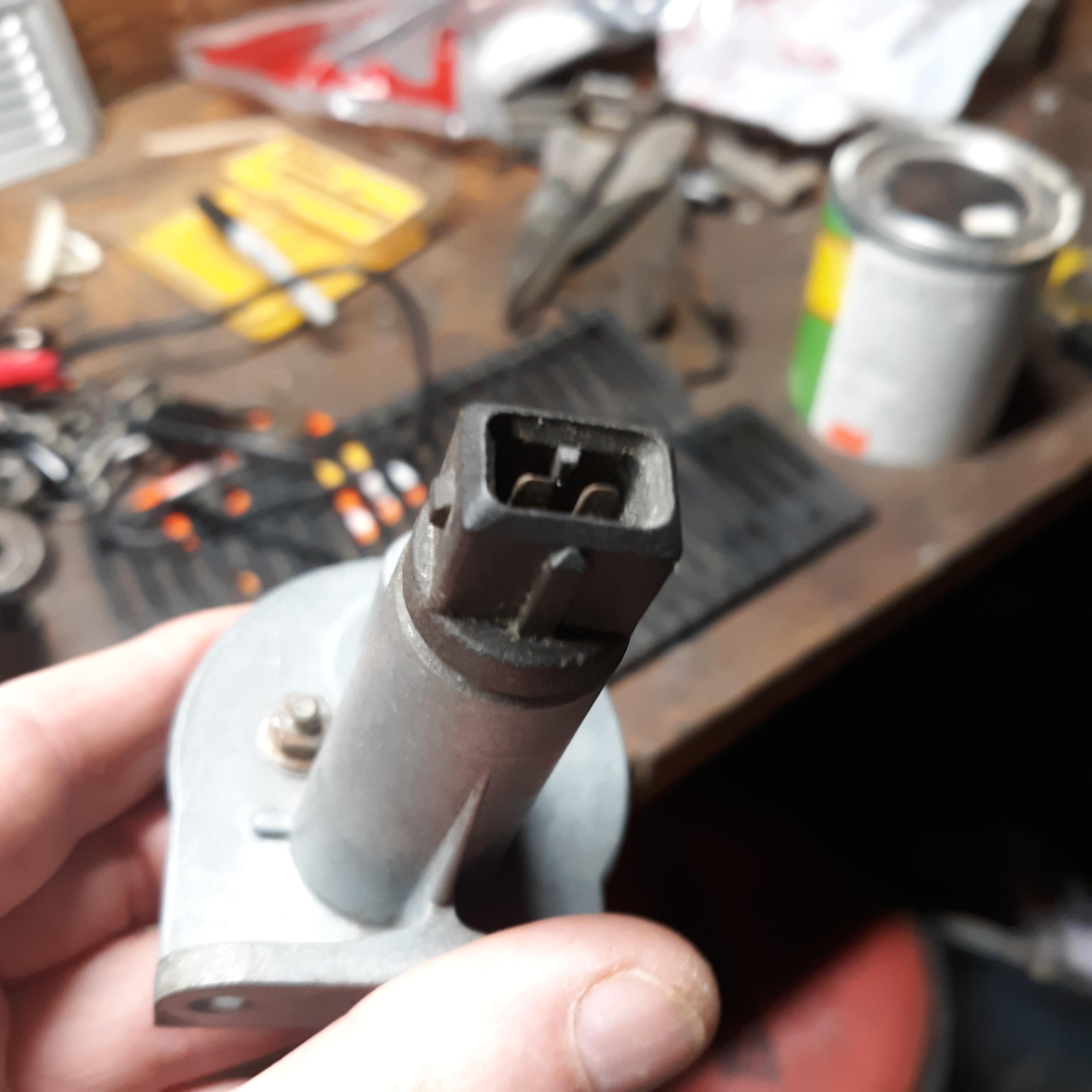

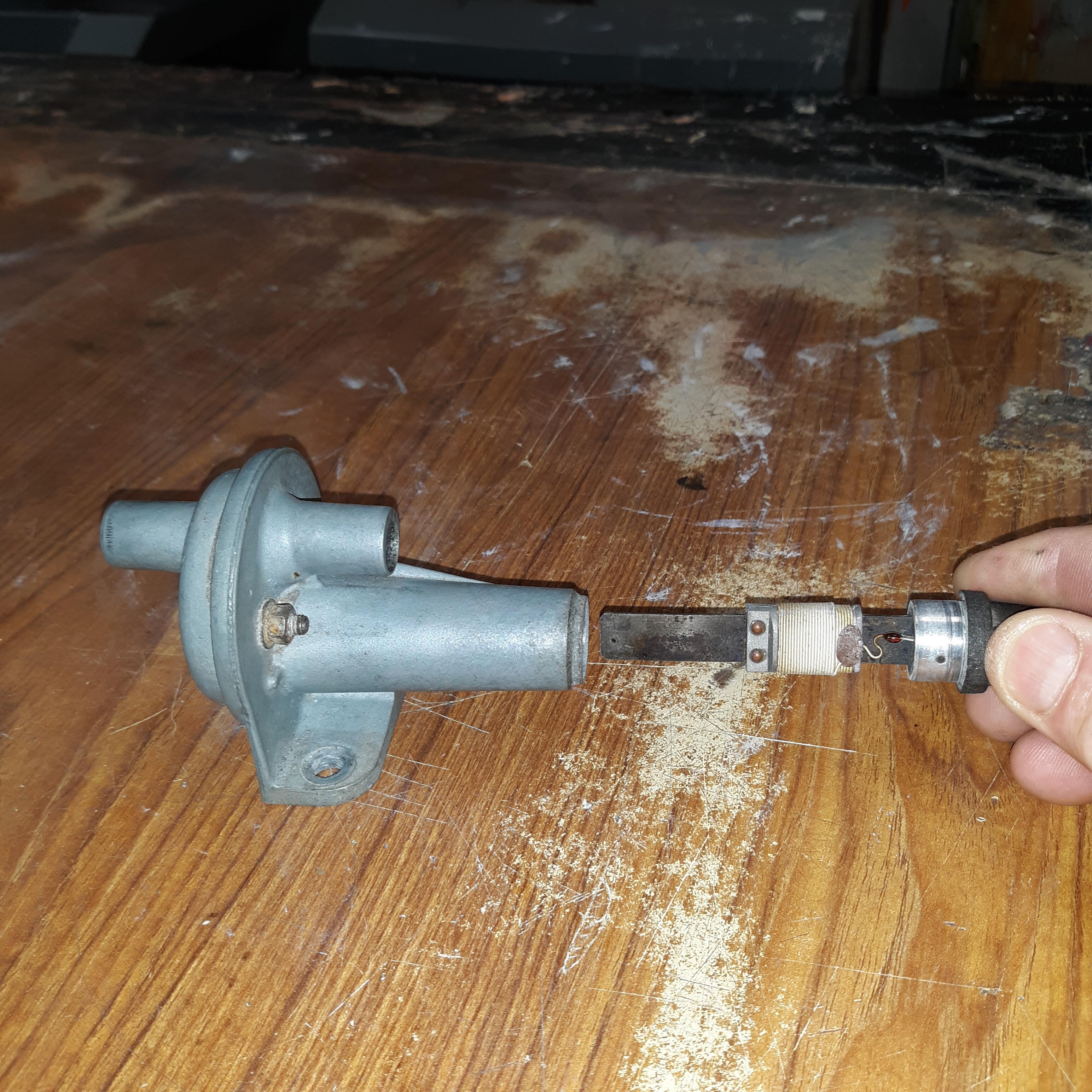

Hi All, I was able to get a used Air regulator valve, but when it got here the black electrical element had pulled out, I was able to push it back in but I don't know if it is in correctly, is there a special position for it to sit ? I had to turn it slightly but it did go back in flush with it's flange ?

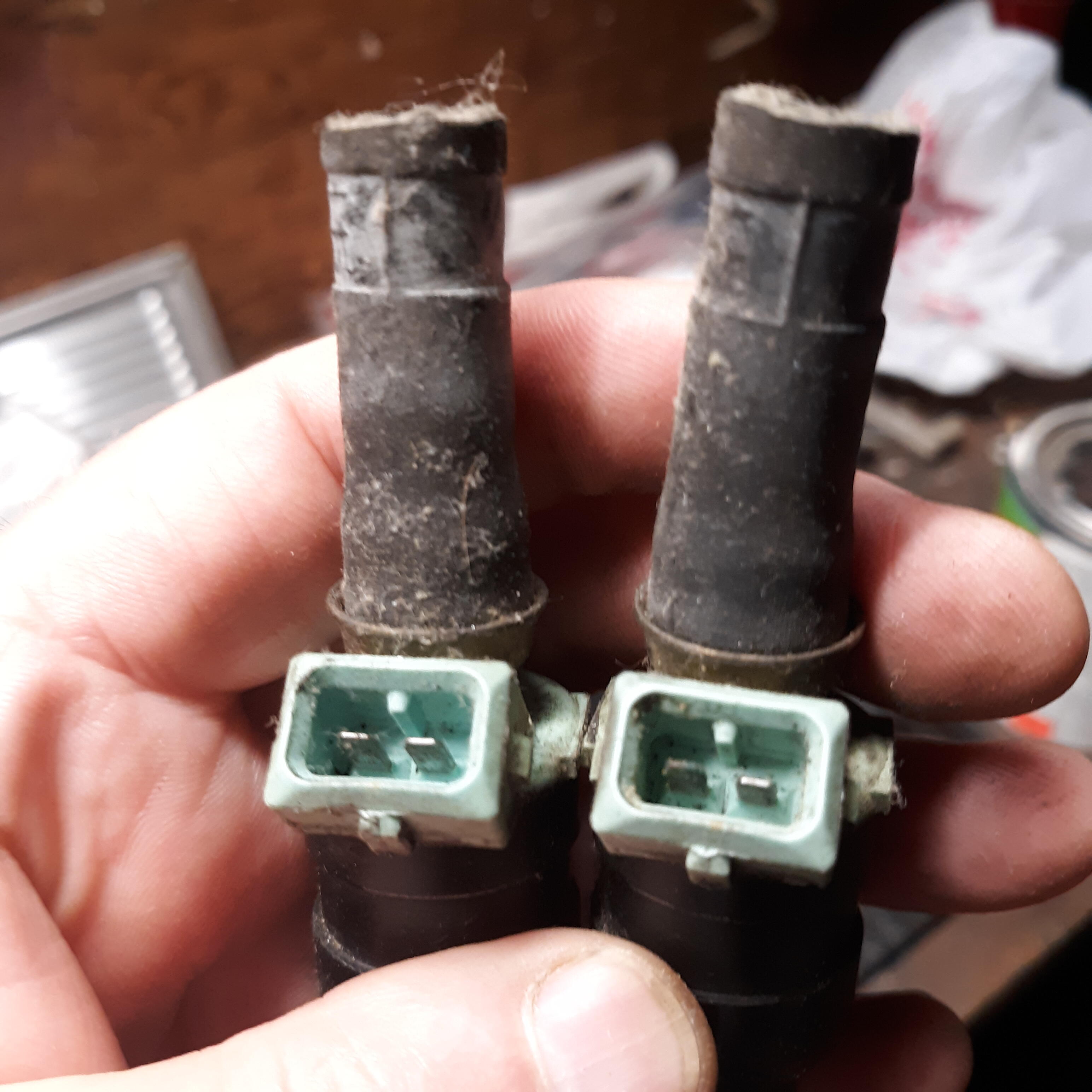

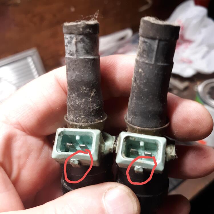

On my 280, if I remember right it's been some years, when I replaced all the connectors the raised up little channel runs on the bottom of the component. I.E the aar, the injectors etc.
Heres some pics of some stuff I had downstairs for reference.
