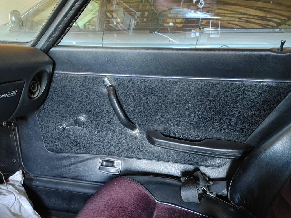

Second question, the interior door pull handles - should my '71 have both, none, or just one on the passenger side?

HLS30-28726 would be a 4/71 manufacture date.  You'll want to check Carl Beck's site Zhome.com for particular dates / serial numbers of changes.  Sounds like you have the correct ash tray and lighter arrangement on the console and the hole in the dash is just bare.  Pull handles on both sides is fine as would be just the passenger door.  Jute and carpet under the seats / tool covers.

I have HLS30-29817, which was also 04/71. It's in a state of disrepair/disassembly (that may be both chronic and permanent). As far as I know the interior is all original. Here are some pictures that I think cover your questions. Aside from the front floor mats and the carpet/jute for the hatch, I have the pieces shown, which I believe go behind/under the seats. If there were other pieces, I don't have them. Armrests are on both doors, but the pull is only on the passenger side.
