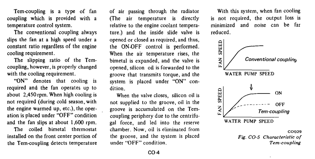

This is something you guys already talked about I'm guessing but I finally read what explains it to me in simpleton speak.
  • Thanks 1
