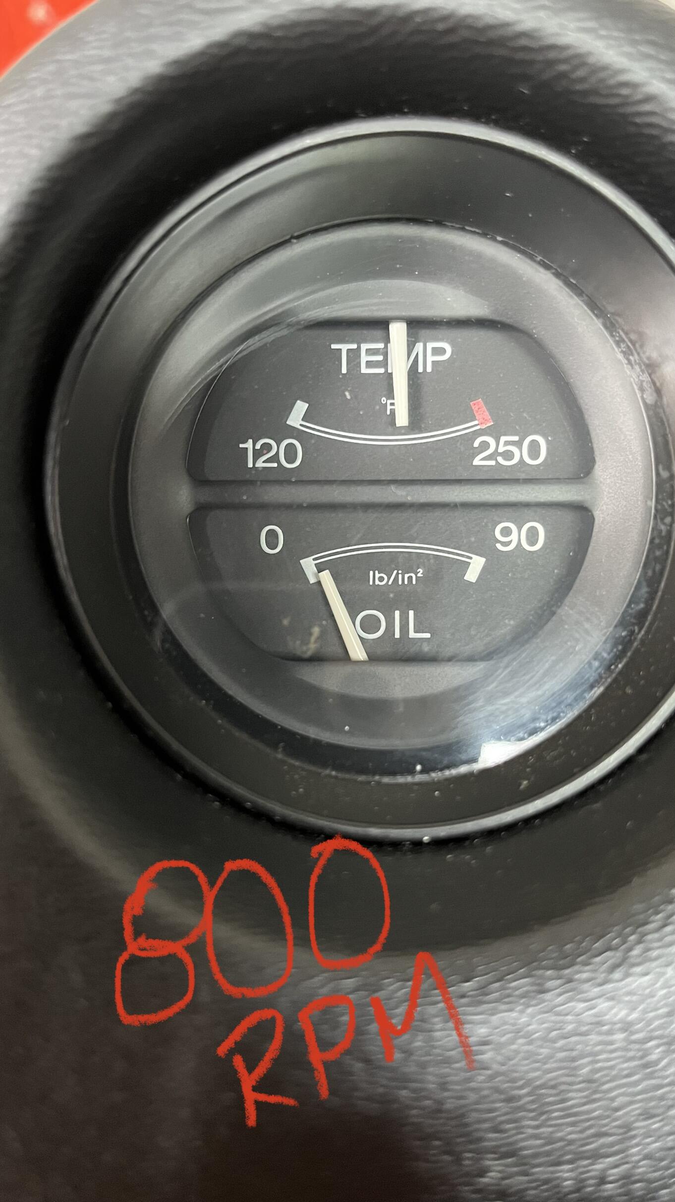

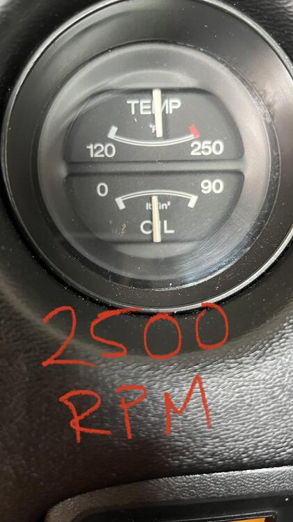

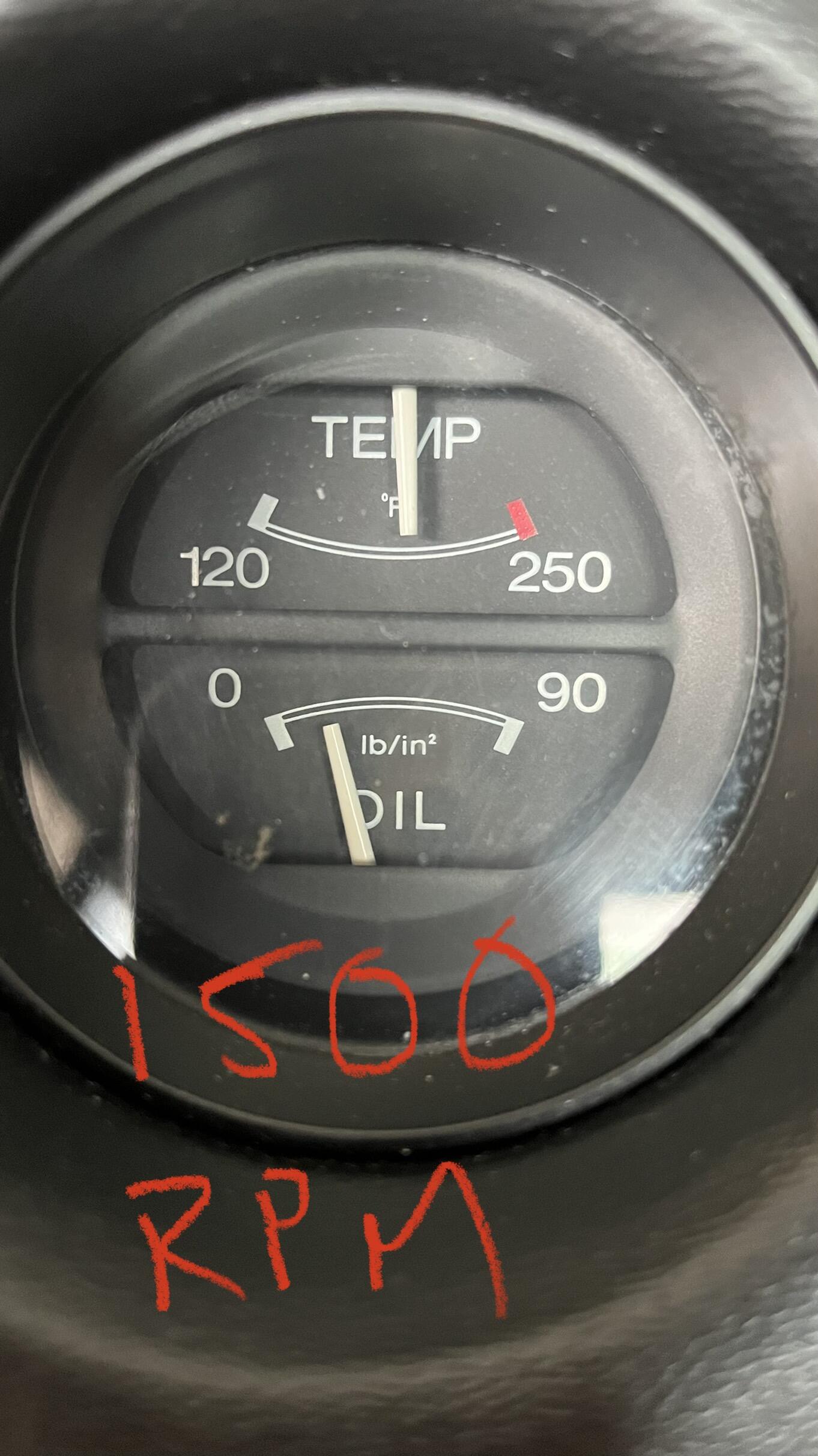

Today, I had to reset my timing after removing the distributor yesterday to test of my ignition unit.   While at it I tested my engine intake vacuum which was perfect so no leaks.  Wanted to confirm that before putting in my rebuild brake booster.  I also replaced my oil pressure sending unit after driving it last week.  Pressure seemed low sometimes.   I replaced it because I  thought maybe it was defective (was a new unit).  The replacement is made by Beck Arnley.   I still feel pressure is lower that I think is right but maybe I’m wrong.  I have a new oil pump (not turbo version) which I probably should have used.   BTW, I opened the oil cap for a peek at idle and I can clearly see oil coming out the cam lobe .
Here’s what if read at different RPM
First pic is a idle (800 RPM)
Second at 1500 RPM
Third at 2500 RPM
Is this pretty normal?
The rule of thumb I heard is 10PSI per 1K RPM. Of course, without a mechanical gauge, it's difficult to know for sure.
If you're worried enough about it, you could get an adapter like this: https://www.pegasusautoracing.com/productdetails.asp?RecID=11217 and add a 1/8 NPT mechanical gauge.
No worries mate... (souds australian hey?) 😆   I always say: when there is oil coming for the cam lobe it's okay.. you could test that when the engine is lowered to 500 rpm's and when you still see oil coming out the lobe that would be okay!
Thanks gents.   I went ahead and ordered that adaptor and and a Marshal 1.5” oil pressure gauge that I’ll mount down by the pressure sender.    Sounds like it’s not a problem but it’s a easy pease of mind fix.
