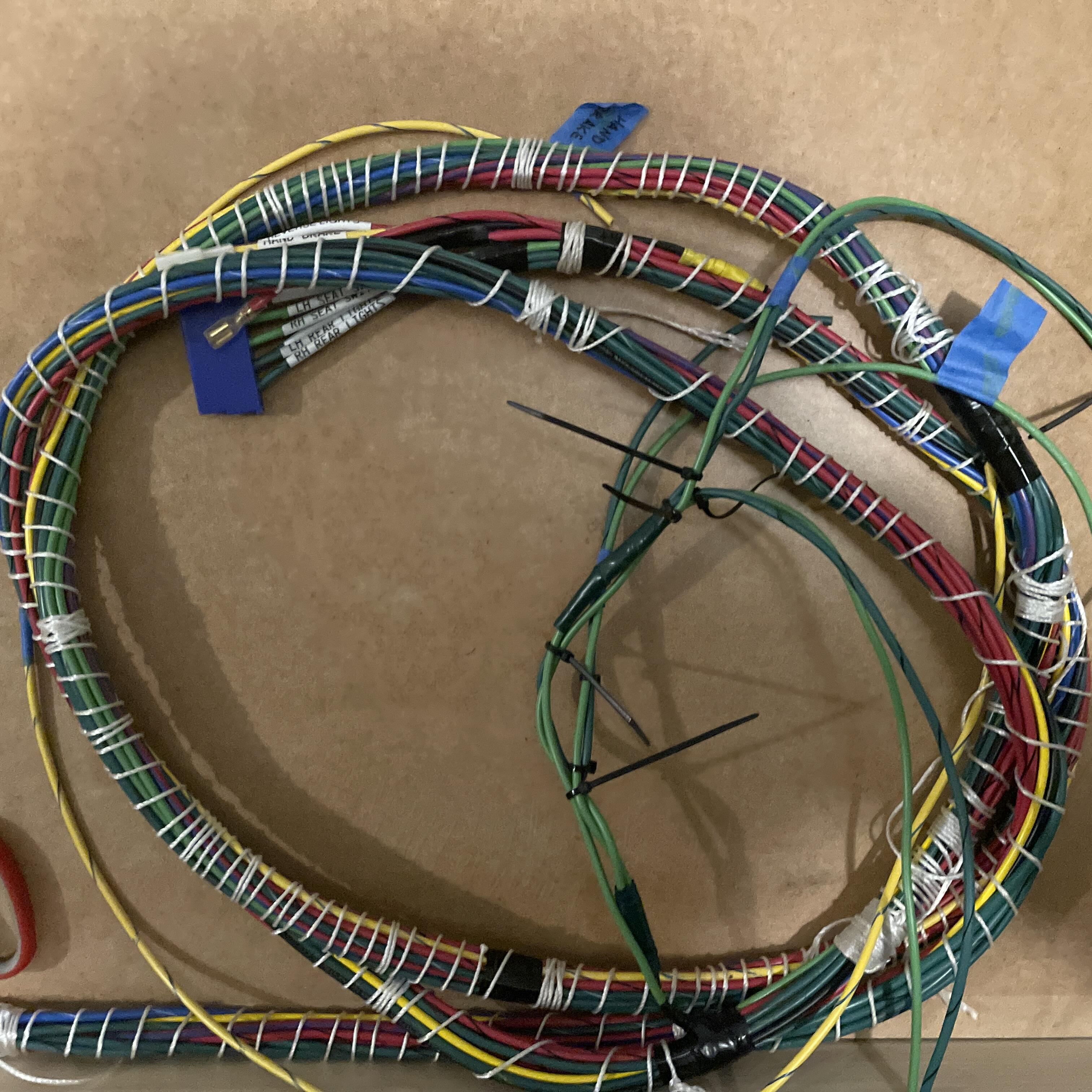

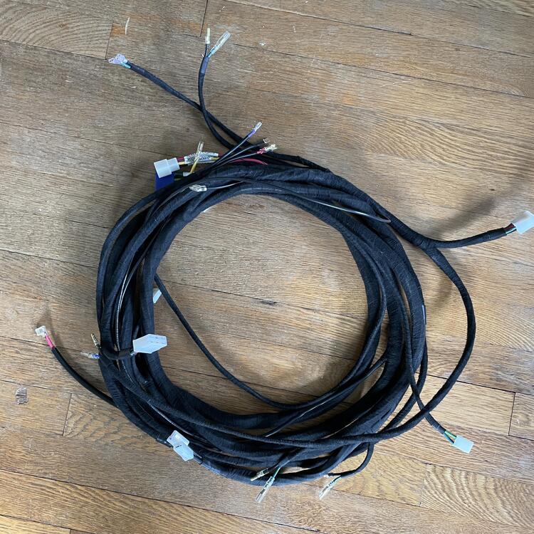

Making a full harness from scratch is a big undertaking, it looks solid, professional.
I've used the Tessa tape on a couple projects, it looks great, is good protection for the wires but awful to remove if you screwed up.
Thanks!
Yeah, I discovered that a couple of times. It also can’t be restuck. Once you pull it off it’s shot.
By the way, @SteveJ, I found that it’s possible to lessen the effectiveness of the plastic that catches the tab on the 1/4” connectors, so be careful when you pull off those colored connectors. I had to fix a few spots, particularly where a 12 or 10 gauge wire had been removed.

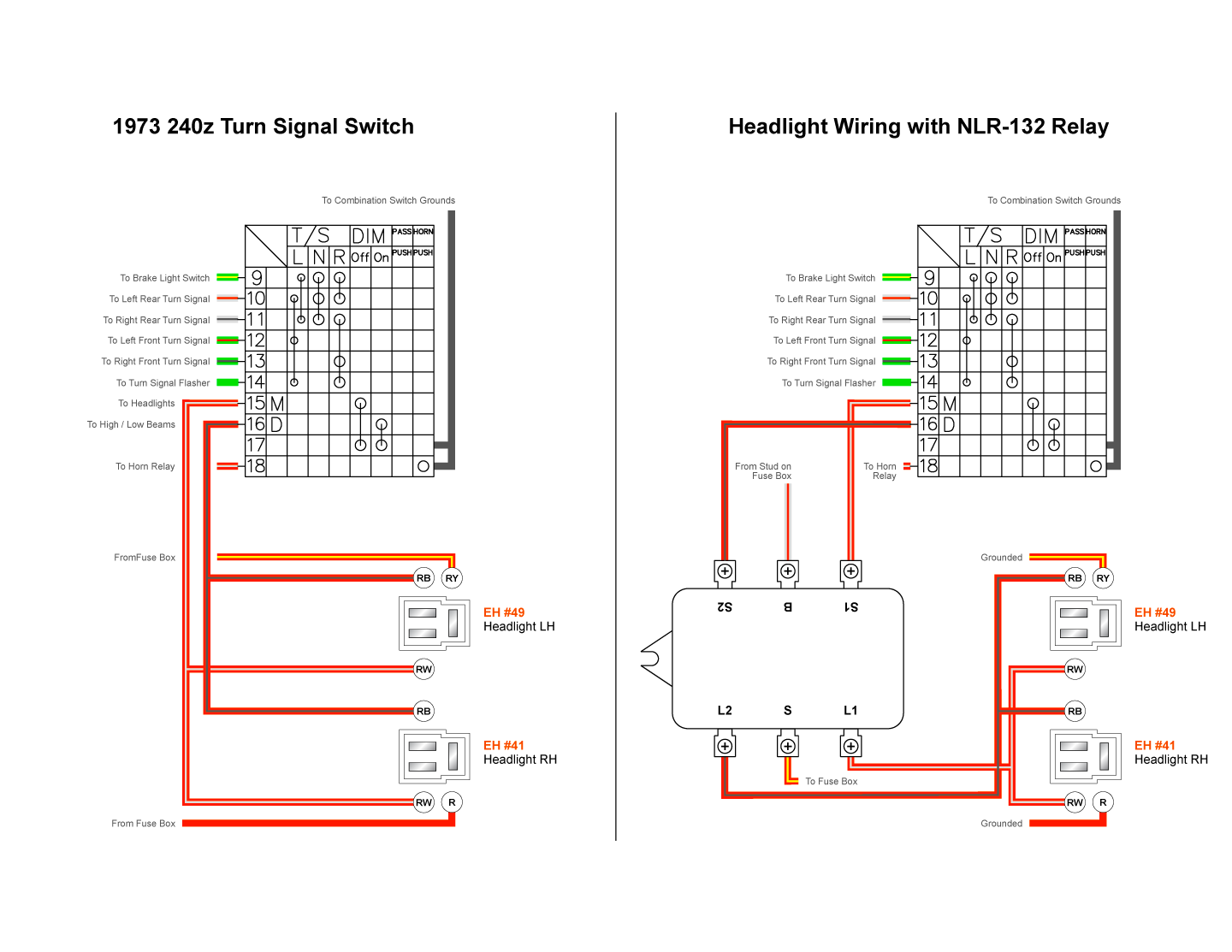

@SteveJ,
I'm working on my dash harness and want to check with you to make sure I am wiring up this headlight relay correctly. Is it okay to run those to wires from the headlights straight to ground?
Also, I could run a wire directly from the alternator to the B terminal instead of coming off the fuse box stud, right?
It took me a few minutes to reconcile things since you are only showing one part of the circuit. Yes, that looks correct to me.
Since you have pulled the ammeter out, yes, you could pull the power for the B terminal from the B terminal on the alternator. I suggest putting a 10A inline fuse into the circuit near the alternator to protect the wiring if that's the direction you go.
