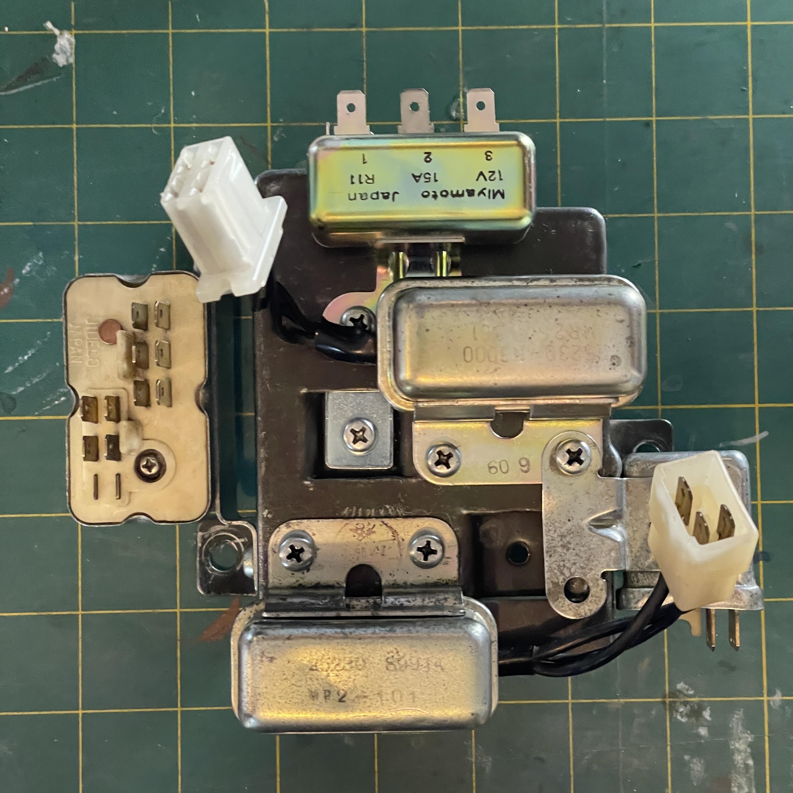

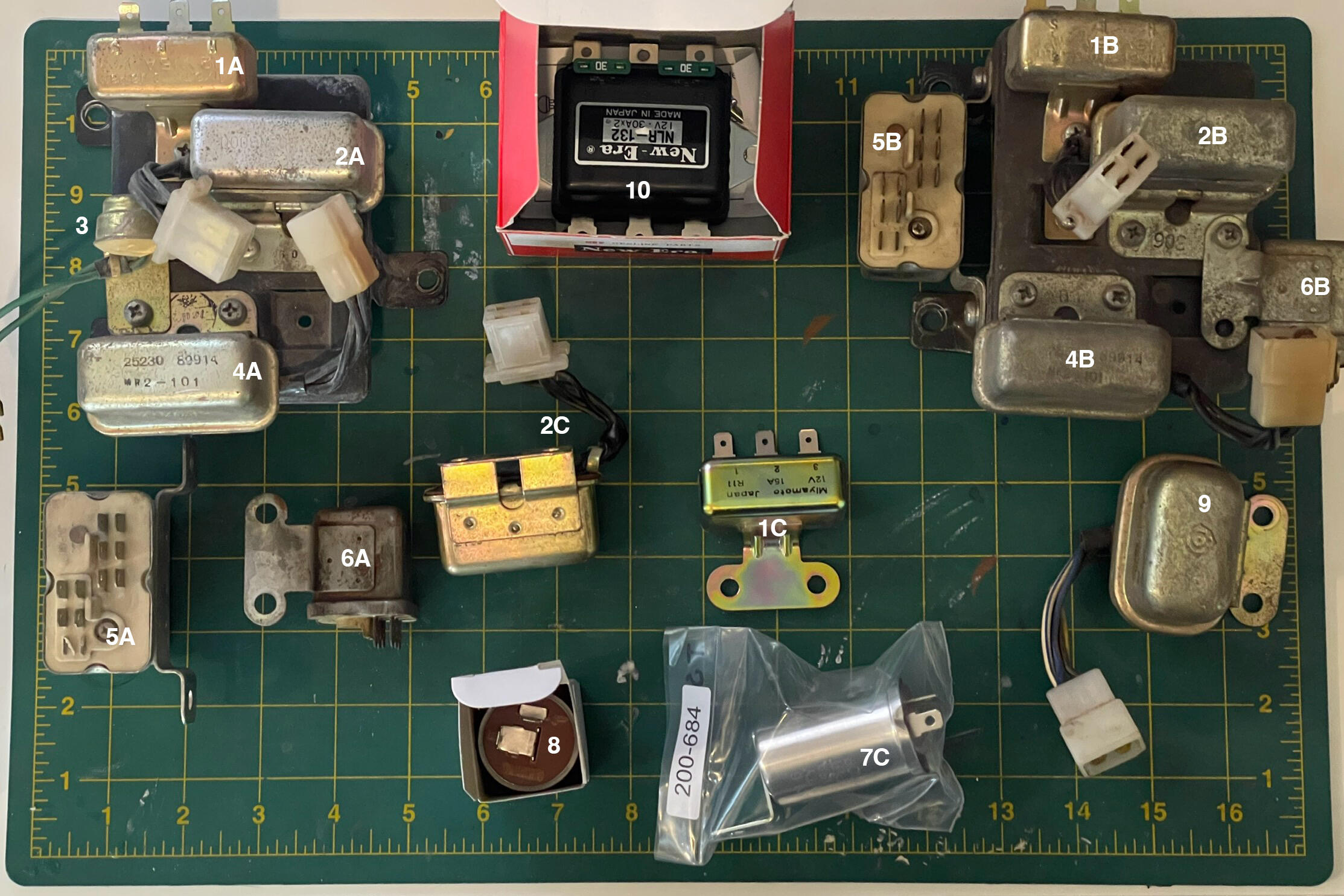

Can you guys help me figure out which relays I’m missing?
This is what I’ve found in my boxes:
1 - Horn Relay 26320-89905
2 - Defroster Relay 25230-N3000
3 - Thermostat Switch 22110-E8000
4 - Air Conditioner Relay 25230-89914 (the internet also says heater)
5 - Intermittent Relay 28820-N3300
6 - Fuel Pump Relay 25230-89915 (the internet also says headlight)
7 - Hazard Flasher (A & B not shown)
8 - Turn Signal Flasher
9 - Fuel Pump Relay 25235-P0101 (the internet also says fuse panel voltage regulator; I’ve seen a different relay with the same number)
10 - NLR-132 will be used for headlights
I have a key-warning buzzer coming in the mail for when the door is open and the key is in the on position. And I will not be using the Throttle Opener Relay that goes on the engine side of the firewall.
I have a 4-pin connector on the front fuel pump harness that I figure goes to a relay if you have an electric front fuel pump. I’m keeping my mechanical one for now because it is NOS. If it gives me issues I’ll switch over. I am assuming not having this connected doesn’t mess with anything since that was stashed away with blue tape from the factory.
I’ve also seen things about a “heater / choke” relay, but don’t see anything for that in the diagram. I found a relay numbered 25235-P0110 on a Datsun 1200 wiki, but can’t find anything for Z cars.
I think I’m all set. I don’t think I need to retain the thermostat switch (#3). I think this might be unique to 1973-4 automatics.
Can anyone identify that thing or think of anything I might be missing?
