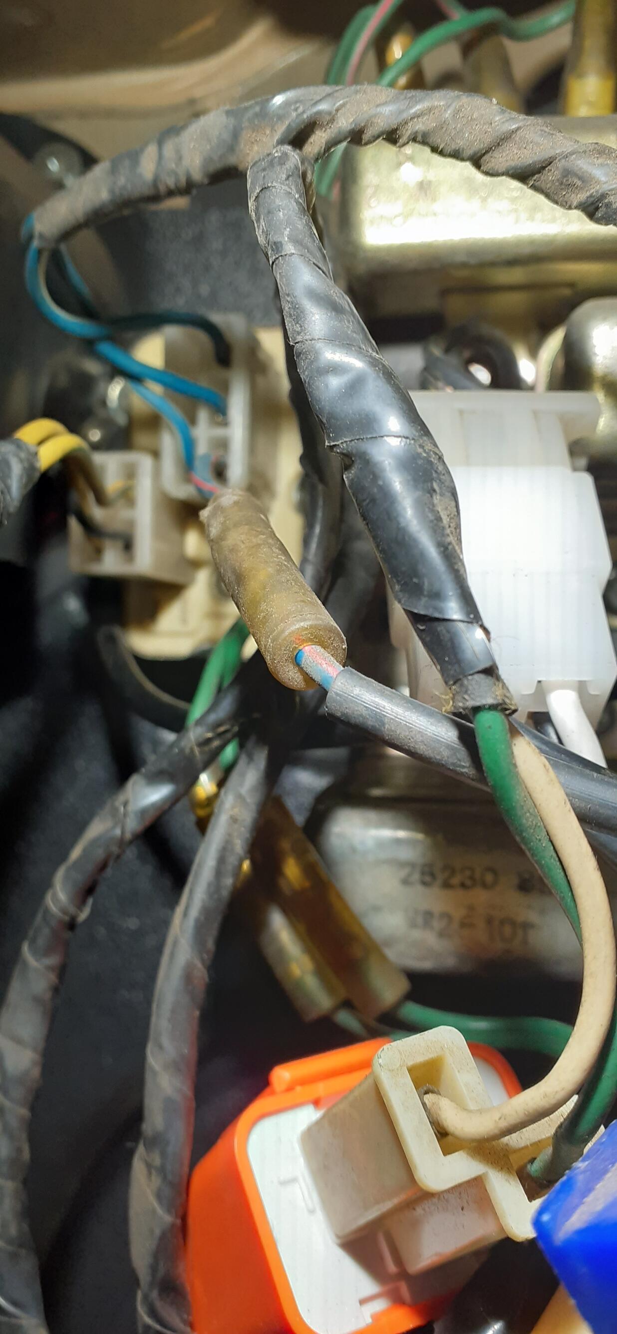

The position of the blue with red stripe wire at position #7 is right out the big colored connectors. It is spliced to a blue / red wire that goes to the fuse box and another one of the same color for the junction connector that comes out at the ignition switch.
It has something to do with the wipers. The wiring diagram shows 3 blue w/ red wires: one going from the ignition switch to the fuse box, one out of the fuse box to the wiper motor, and one from the combination switch and connecting to a yellow / white wire that goes to the wiper fluid bottle.
Edited by Matthew Abate
So for #7, the LR wire coming off the fuse box goes in several directions.
  1. It turns into BY and goes out to the washer
  2. It goes to the Intermittent Relay for the wipers as LR
  3. It turns into R and goes out to the reverse switch (and inhibitor switch on the automatic).
There is another LR wire that goes from the defroster switch to the defroster relay.
I think there is a mistake on the wiring diagram for the intermittent relay. It shows the LR wire from the fuse box turning into BY when it gets to the intermittent relay, and another LR wire on the intermittent relay that goes to the wiper motor as BY. My guess is that BY and LR are swapped on the intermittent relay.
Can you post a photo of #7 with a little more context in the wire bundle? That may help narrow it down.
Here you go. It's the one in the black sheath with a female bullet connector pointing to the top of the photo (between the blue wires and the white wire w/ the red stripe).
Perfect. Now I can look for it in my car.
Found it
Here are wires going to the intermittent relay:
Obviously, the wiring diagram in the FSM isn't quite right for the intermittent relay as it shows 9 wires. There isn't a BY wire going to the relay, and there is only one ground wire.
Amazing!
So not only does that solve #7 in harness #1, it solves for position #5 in harness #2, which you would not know because I have not posted the table for yet. The only mysteries I will have left are the 4 wires that are missing (2 from the dash and 2 from the engine) and a blue connector on this harness I am chasing now, which might be to the radio lights. Maybe I can find those using the diagrams.

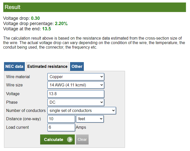

Just be aware of what gauge wires your terminals are designed to take.
Doing some quick resistance calculations, you are upsizing a lot of wires with little to no benefit. You may end up with an issue getting your engine harness through the hole in the firewall. (Keep in mind that it will probably be easier if you put the pins in the connectors after you get the harness through the firewall.)
You may want to check out a voltage drop calculator like this: https://www.calculator.net/voltage-drop-calculator.html
Choose estimated resistance. I did a quick calculation for the headlights with a swag for the distance and used incandescent sealed beam ratings. The voltage is 13.8 because that is toward the low end of operating voltage while the car is driving.
Many of your circuits for the engine harness are grounded close to the load, so this calculator would overestimate the voltage drop.
The battery/charging system are your highest current circuits, so the larger gauge can easily be justified. No other circuit comes close especially if you change the parking light circuit to LEDs, as that is probably the biggest continuous draw you would see.
Other high draw circuits:
Fan (14 AWG is fine, but you might be better off with 12 AWG)
Fuel pump (This is about 10 A or less. 14 AWG would work.)
Headlights (depending upon whether or not you switch to LEDs. LEDs would drop this circuit to about 3 A.)
Edited by SteveJ
Fixing grammar
I plan to use LEDs but I want to wire the car so that I don’t HAVE to use LEDs, particularly for the headlights.
My thoughts on having 14 AWG be my smallest wire was coming from a few things:
First, the amount of fried wiring I found. It’s possible the heat came from outside but in places like under the dash I don’t know what would cause that, so I was assuming that it was overload on the wiring.
Second, the general use of 10-amp fuses for everything that wasn’t one of the fatter wires, plus the gauge charts I’ve been using. However, I suspect the dash maybe could come down a notch for all the instruments and save me some headaches with fitting all that stuff in there.
Third, just eyeballing stuff looks like a lot of 14 AWG. Maybe I’m off base and It's smaller than that. Tough to tell since it's actually Japanese (square millimeter?) wire and not AWG. need to go back over it more carefully.
I would love to plug all the numbers for everything in the car into a calculator, but I just don’t know where to find that information.
