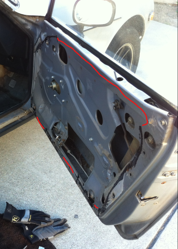

When I disassembled my doors, I just ripped all the plastic sheeting away, and assumed the FSM would help me with reinstallation photos.  The FSM only makes mention of a 'water seal screen', with no diagrams or photos.  The parts suppliers don't seem to offer any replacements.  If it's just mylar sheeting, I can cut that out myself if I know what size it should be and where it should go.
My doors also had individual thicker plastic covers over the individual inner door openings.  It's possible that I added those myself, but I don't think so.
Thanks in advance...Robert

From the factory there is a sheet of plastic between the door and the door card. It basically goes around the perimeter of the door where you see the red and black line below.

Take a large sheet of 5 mil or thicker and adhere it to the butyl tape.
Trim.
My painter had a sort of 2 foot wide sticky plastic and were this should NOT be sticky because of moving parts i put some of that plastic inside (against) the sticky plastic! workes very well! (then you don't need any butyl and make NO mess!!)

The 'water seal screen' means 'vapor barrier' and it was 6mil PVC "visqueen" plastic sealed to the door with white polyurethane sealant.  The sheet had cutouts like this but as I recall, was clear, not black.  https://www.ebay.com/itm/265471089859

Well, you can cover it up however you want but from the factory it was just a single sheet of fairly thin plastic glued on at the edges by that black goop with round cutouts for the bolt locations... It doesn't really "seal up the door" but it does give the door card - which falls apart when wet - some protection for those of you that live in places where it actually rains and snows.
