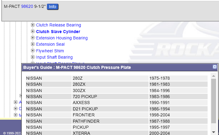

Looks like the vendor might be right.  The 240 mm pressure plate does fit many different applications.  I think I might have known that once in the past.
https://www.rockauto.com/en/catalog/nissan,1990,300zx,3.0l+v6,1209686,transmission-manual,clutch+pressure+plate,1988
