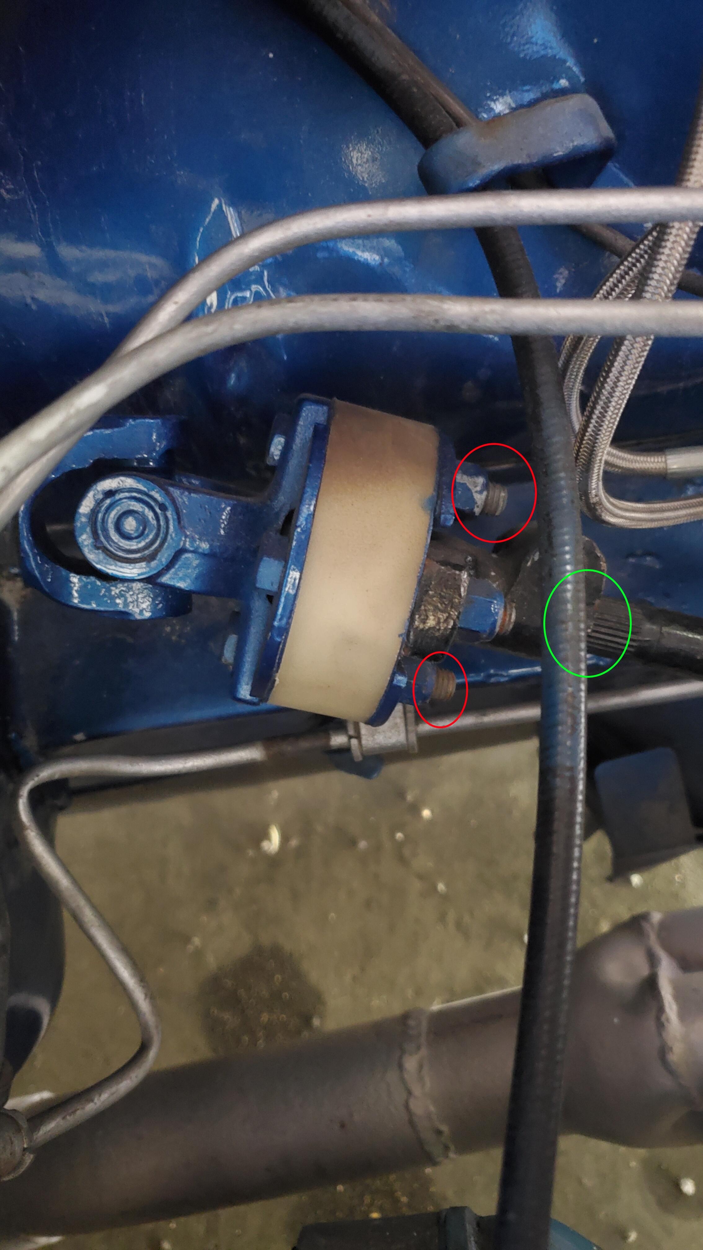

I was poking at the steering coupler and the column does have continuity through the coupler but it doesn't have continuity to the input shaft to the steering box (that does have ground though). I'd guess it's because a bunch of this stuff has been painted over
I've attached a picture to try and help. The red circled bolts have continuity with the steering column. The green part has continuity to ground. I think there should be a connection between the two where the steering box input shaft is bolted to the H section of the coupler. The H plates have been painted blue so I'd guess that's why there's no continuity there.
I think the "proper" solution is to probably take those coupler plates off and make sure there's not paint preventing contact, but the easier solution (and what I'll probably do) is just buy a short grounding strap and connect them that way

I definitely thought the same thing but it looks like that coupler is a pretty common ground approach for 60s/70s vehicles (American ones at least). The column might get ground from where it's bolted to the firewall as it looks like the steering column bearings aren't rubber coated like some other steering columns from the period so there should be some contact there

I connected a ground strap to the ignition switch and that grounded the column and the horn worked then (which is how I ID'ed it being a grounding issue).
I also agree in that I'd expect the center shaft to be grounded via the bearings since they are metal. American cars of the period would use a metal bearing in a rubber sleeve so it makes sense why those needed a grounding strap. I don't know if the housing was painted or what as it doesn't seem to be grounded through the housing
