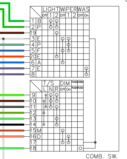

1973 240Z Horn signal wiring/relay location
73 shows similar but they actually show a connection between the ground circuits.  Seems like there would be a sliding contact like for the turn signals, to ensure a ground circuit.  Just offering another possibility.  There might something buried under the mechanism.  I had mine apart long ago but can't remember what was underneath.
Whatever it is would not pass much current.  Just enough to trip the relay.
