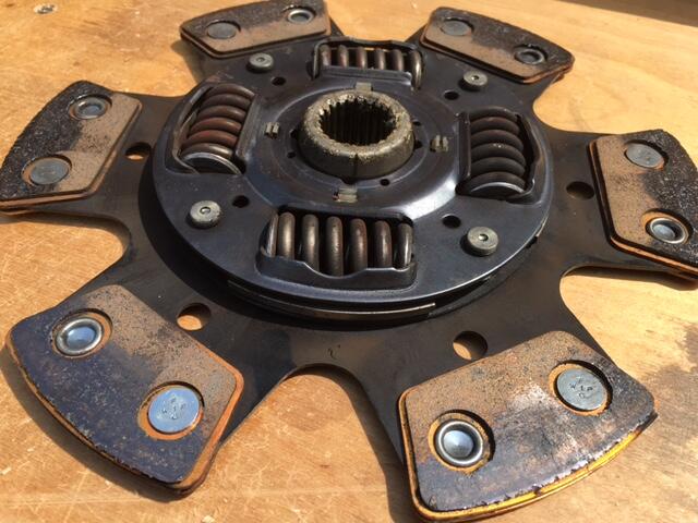

I had a McLeod clutch kit installed about 5-years ago but only put maybe 2-3K miles on the car and it is shot. That was using my 5-speed transmission which I just switched out to a 4-speed last year. Hopefully, whatever caused the issue with the clutch will be corrected now. From the looks of the wear, it seems that the disc was cupped slightly.

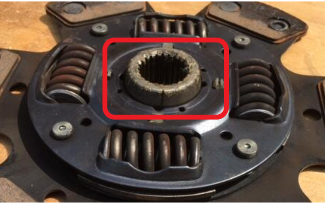

This was McLeod part no. 763701. The TSR at McLeod said it was an installer issue. : \

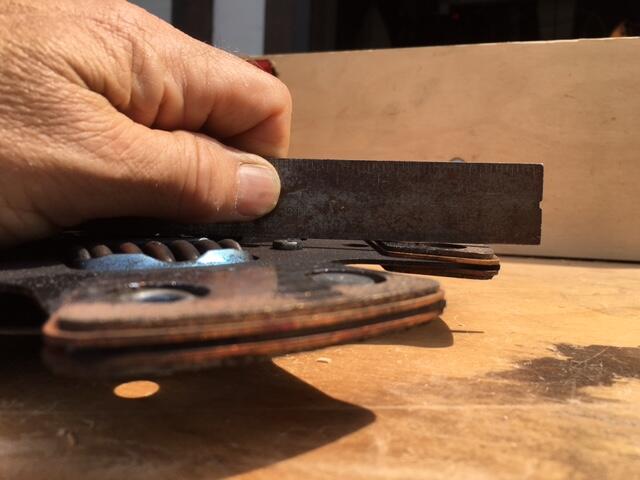

In the pics you can see the outer edge is glazed on one side and the inner edge is glazed on the other side. Holding a straight edge across the pads shows that the disc is cupped.

No, not beat up. Just some grease, grime, bad picture. I won't say I didn't install it backwards. I cannot recall which way I installed it.
This was the first time I installed a clutch so maybe I screwed up. I have a lot of firsts with this car. I'm getting really good at replacing transmissions (unfortunately).
We all have done something wrong i think to our cars in time..  i think you installed it the wrong way (?) ...   The part does not look very used.. could be that if you sanded the pads a bit you could use it for many more miles as it did not make a very well contact to the rest of the clutch parts!
The cupping will go away once the clutch is installed in the right way.. i think/hope.. (Use also some degreasing stuff because a clutch HATES grease!!)
