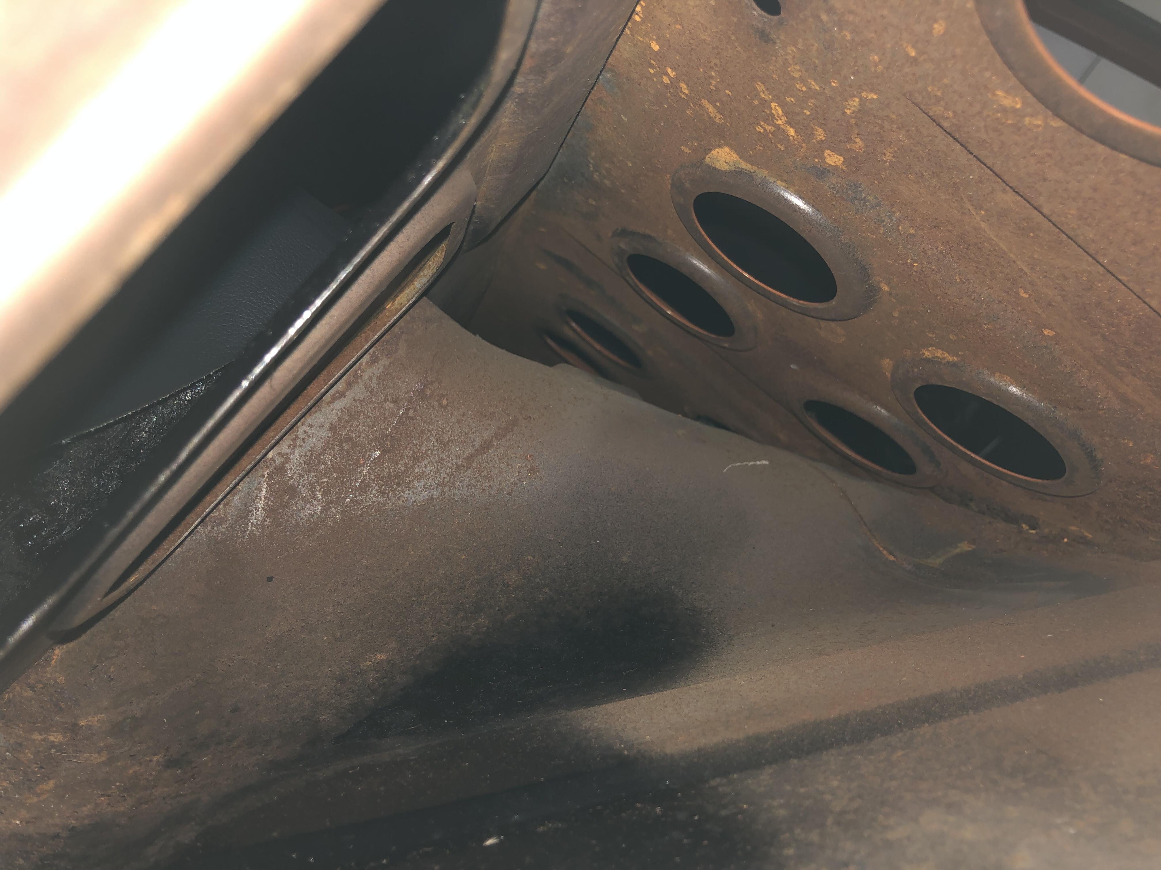

Here's a fun little detail seen on the early cars.  The rear light pods were affixed from the rear of the car (sometimes using sheet metal screws?), so they could be removed from behind and outside.  I imagine there were several reasons for this: surely, to facilitate the changing of a bulb without having to open and unload the trunk.  Perhaps also: to provide an easy way to swap out the entire assembly, should it be damaged during the rally.
I'm not entirely confident that the lights were always affixed with screws, as I have not seen them affixed this way on another car.  For example, the included picture of an earlier car does not appear to have screws, but it does have the quick-change rear panel installed.  From what I can see with my car: they appear to be original to the car, or at least installed in-period.  That said, it's possible that the lights were held in place using other means, such as being just loosely glued in place, and could therefore be pulled off by hand, without tools.  But this is just a guess.
From what I can tell, all the rally cars campaigned in 1970 and 1971 had this feature.  I don't exactly know with what car the practice ceased, but around late 1971, Nissan stopped fitting a rear panel which could accommodate this feature. I assume they also eliminated the "external-change" feature along with it, but perhaps they just eliminated the custom rear panel. Another possibility is that the feature remained, but that Nissan perhaps altered the lenses to be removable from the housing. Again, this is just speculation. If someone is willing to go tug on the rear lenses of Nissan's cars and see what happens, perhaps we can get a few answers!

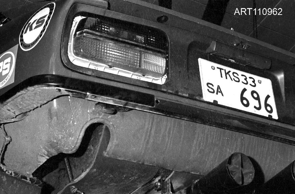

Here's a picture of my car during MC '71, showing the same rear tail panel, featuring enlarged holes for the tail light assembly. (credit: Nissan Global Media)

Yep, an enlarged tail light opening in the rear exterior panel, thru some time in 1971, I believe.
In fact it seems it was restricted to the 1970 RAC Rally and 1971 Monte Carlo Rallye batches of Works cars, as the 1971 East African Safari Rally batch and onward batches of cars didn't have the cut-away finisher panel holes.
There was clearly - as is so often seen on these cars - an evolutionary process going on here. The very first batch of cars sent overseas - for the 1970 RAC Rally - featured the cut-away finishers, but not the extra self-tappers. Instead they had threaded studs inserted where the normal fixing screws would thread into (those pesky...) captive nuts in the plastic lamp housings, and butterfly nuts were used to hold them in place. This allowed the lamp units to be removed fairly quickly without having to take off the finishers:
Obviously the 1971 Monte Carlo Rallye batch (an event where rear quarter damage was more likely) improved on this with the addition of spring nuts on the body and self-tappers passing through the plastic lamp housings, so it was no longer necessary to fiddle around undoing butterfly nuts inside the car. Better!
However, for the 1971 Safari they reverted to uncut rear finishers. The finishers were secured by self-tappers (rather than the stock plastic rivets) so could at least be removed fairly easily.

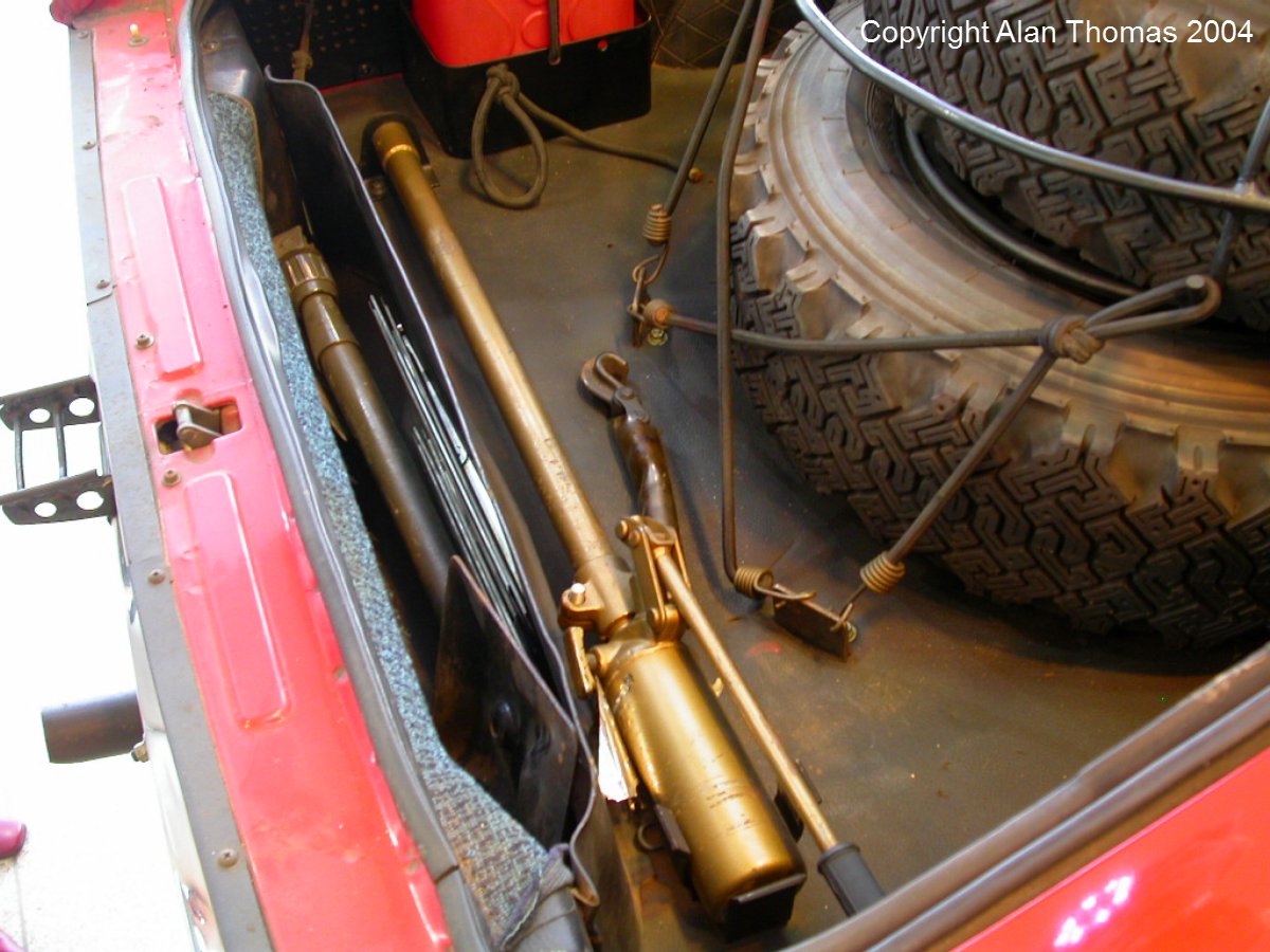

That area of the car was a good place for storage. They tended to store the onboard jack near there, as well as a host of spares, ropes, jack base, shovel etc housed inside a fabricated pocket. LOTS of storage on these cars:

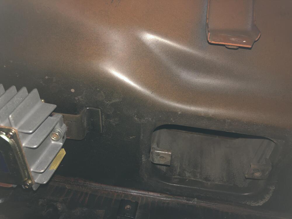

A view of the rear interior of the car.  There's a few things to see here that are not frequently seen- I won't go into all the minutiae, other than to point out a few obvious features: a few of the features which I'd label "stock PZR" from the parts manual (for lack of a better description) include the spare tire cap and 4-point seat belt shoulder strap mounts. Then there are a few obvious Works features, such as the roll bar mounts, some drilled access holes, and a Works fuel delivery system. There are several more details that enthusiasts can spend the weekend spotting!
Also visible is a rusted rear quarter panel, which helps make this Lightweight Spec even lighter today than when new.  Most of the trunk area appears quite servicable, but that rusted area will need to be fixed, with new metal.
Of note, the 4 silver rivet nuts now occupying the existing spare-tire hold-down mounting holes on the spare tire cap are my "quickee" addition to the car- that's unlikely to be how it was done in period. I had a show deadline, and I needed to affix the spare tire bungee brackets using the same existing holes. The only options that I could see were to either remove the gas tank to access that area, or add a few rivet nuts - a 2 hour job vs 5 minutes. Done and done!
Also, the fuel pumps are obviously brand new - a prior owner had installed later pumps of a non-original make and type, probably decades ago, so I put these on the original brackets, so the car could be displayed.

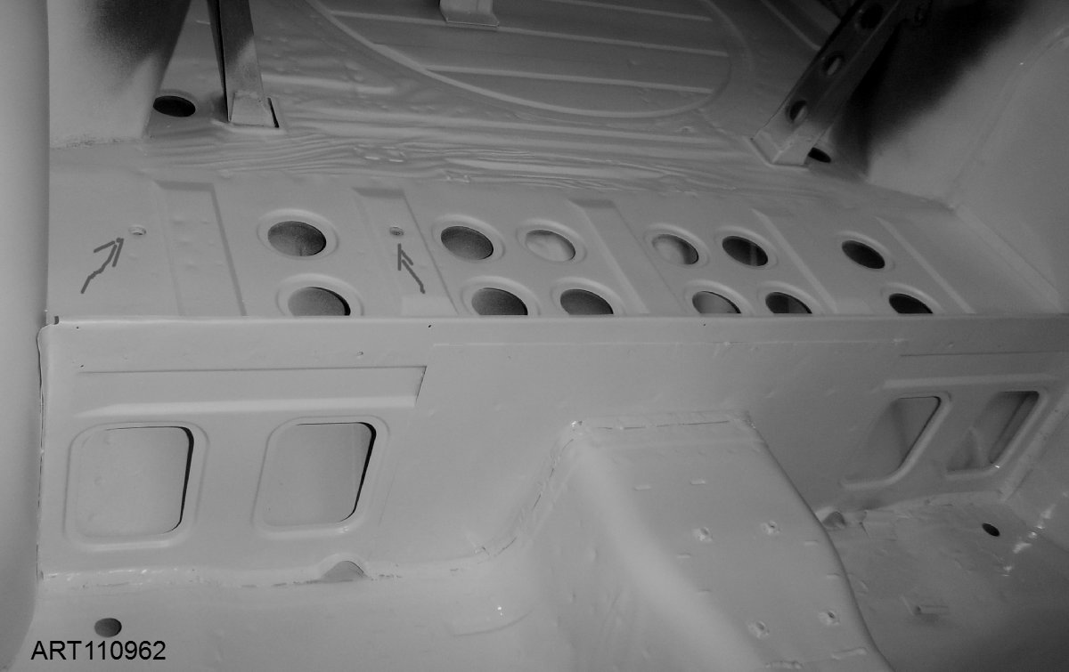

Yes! 432-R was certainly 'driver focused' and standard equipment 4-point Takata harness was only provided on driver's side. Similarly, 432-R only got a headrest on the driver's side.
Early Works rally 240Zs were a kind of 'hybrid' of 432-R bodyshell parts mixed with upgraded details, Sports/Race Option parts and hand fabrication. The bodyshells were built in small batches designated as rally cars and therefore could incorporate a little extra attention and detailing on the line at Hiratsuka (such as the extra doublers for the passenger side four-point harness shoulder strap mounts under the 'cheesegrater' deck panel) before being transported as bare shells to the Works rally shop at Oppama where the build-up could begin.
Attached photo shows stock 1970 432-R rear 'cheesegrater' deck with shoulder harness mounts on driver's side only:

You would only have been able to fit 4-point harnesses on the driver's side, as there were no shoulder strap mounts/anchor points on the passenger side. Mounts could feasibly be added after the fact (I've done this on my 432-R replica project car because I wanted both sides the same) but they need a doubler underneath or - preferably - the welded-in L-shaped factory reinforcements and captive nuts as seen on the driver's side.
So this is another one of those Works rally car-specific differences. The Works rally team fabricators were able to specify non-standard additions and modifications literally before the bodyshells were welded together.
