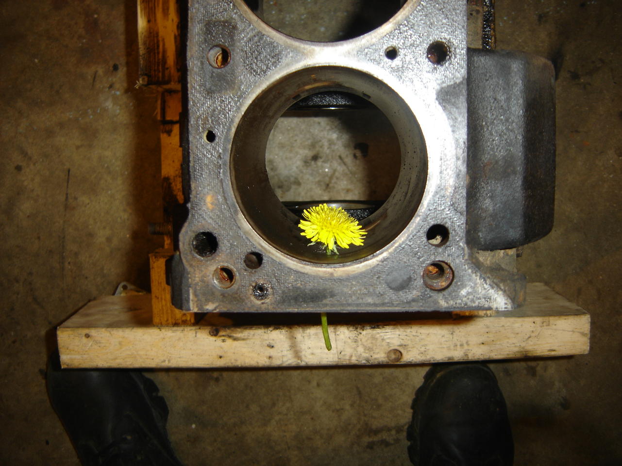

I drilled through mine (very carefully paying special attention to when the drill broke through the other side) and then I tapped the hole and used a piece of threaded rod attached to my slide hammer to yank the plug out.
Looked like this:
