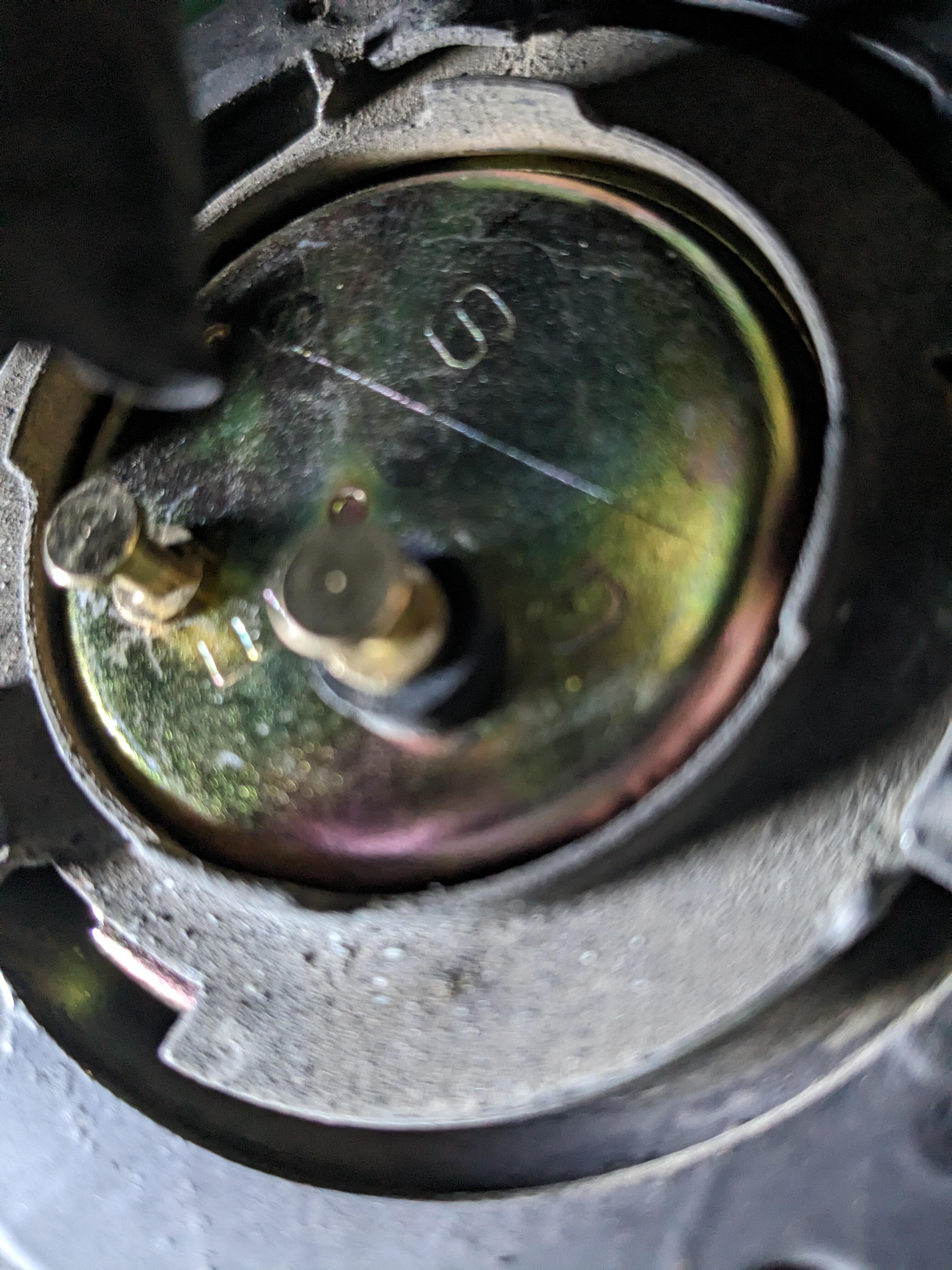

Figured I'd continue posting pictures on this journey. Took the time to adjust the fuel sending unit while I had slightly easier access to it:
It actually works very similar to a toilet bowl float valve. There's an electromechanical connection, that moves up and down a set of progressive longer to shorter wires which adjusts the resistance, which is then used to determine the fuel level.
There are 3 levels of adjustment: bending the float rod itself, bending the high/low tab stops, and unscrewing and adjusting the contact pad location. I ended up needing to adjust the tab stops (to allow a little more travel) and the contact. I tried adjusting the rod a bit, but not sure I actually made any difference.
The tab stops:
The eletromechanical slider with it's adjustment screw:image.jpeg
Just gotta be mindful that you don't want it reading "Empty" when there's literally no fuel left. You want a little head room there.

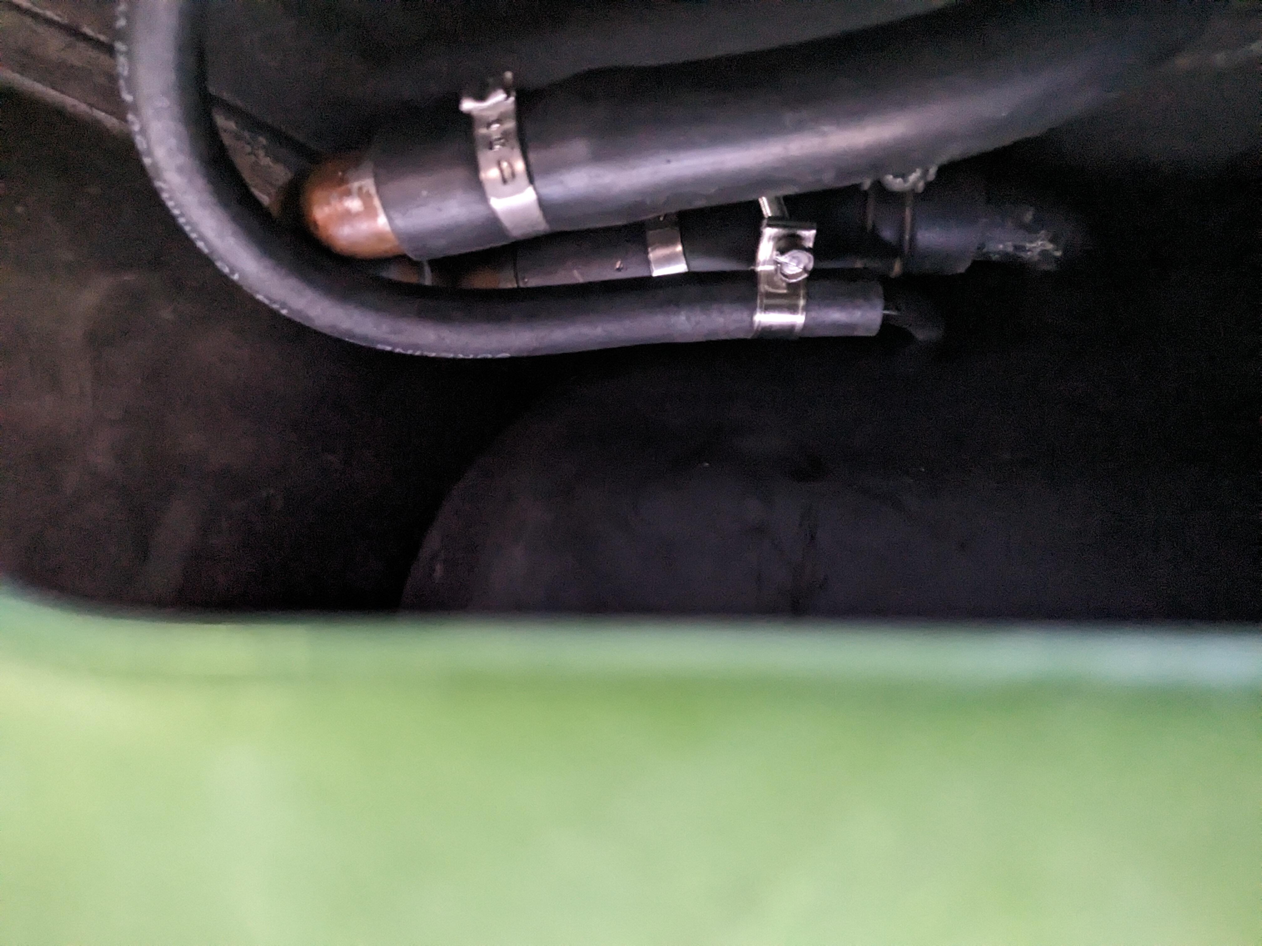

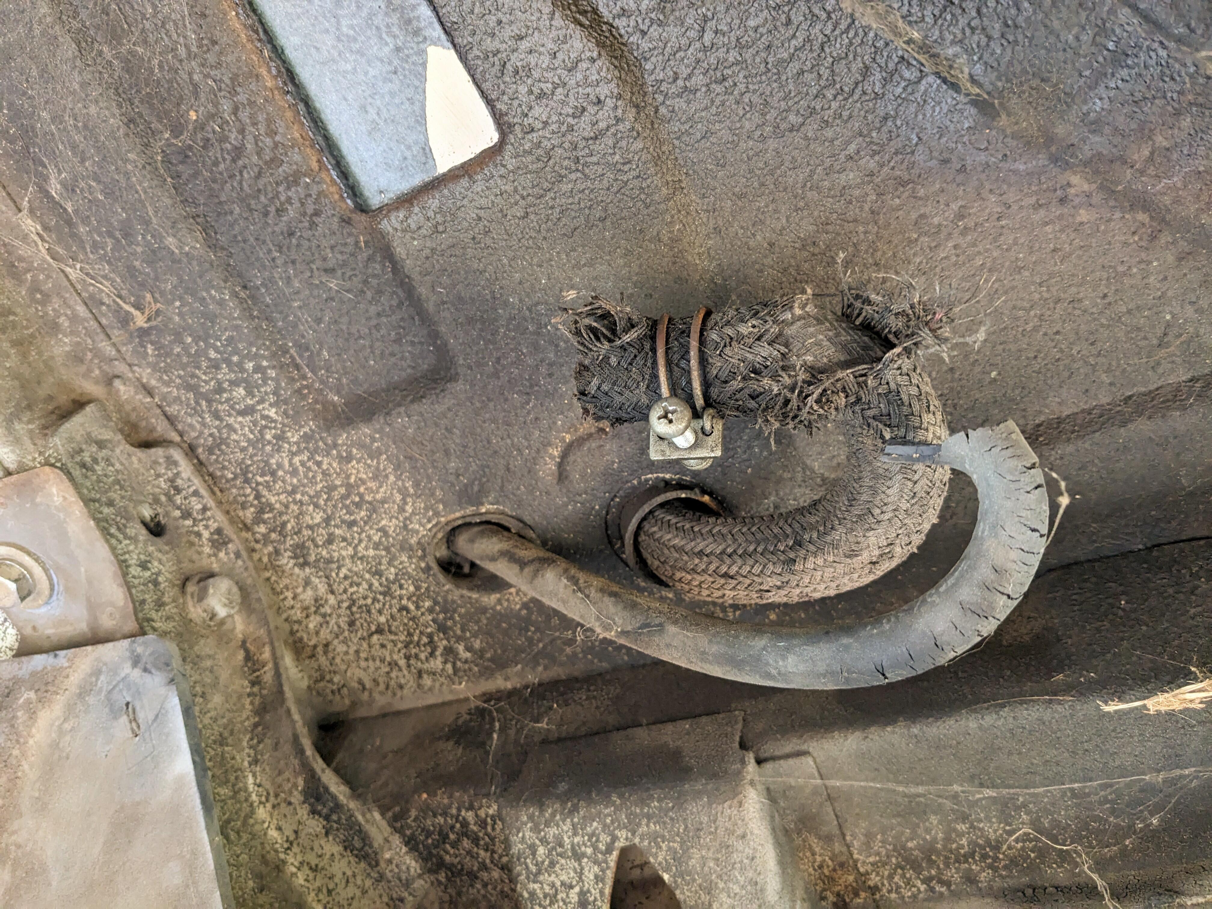

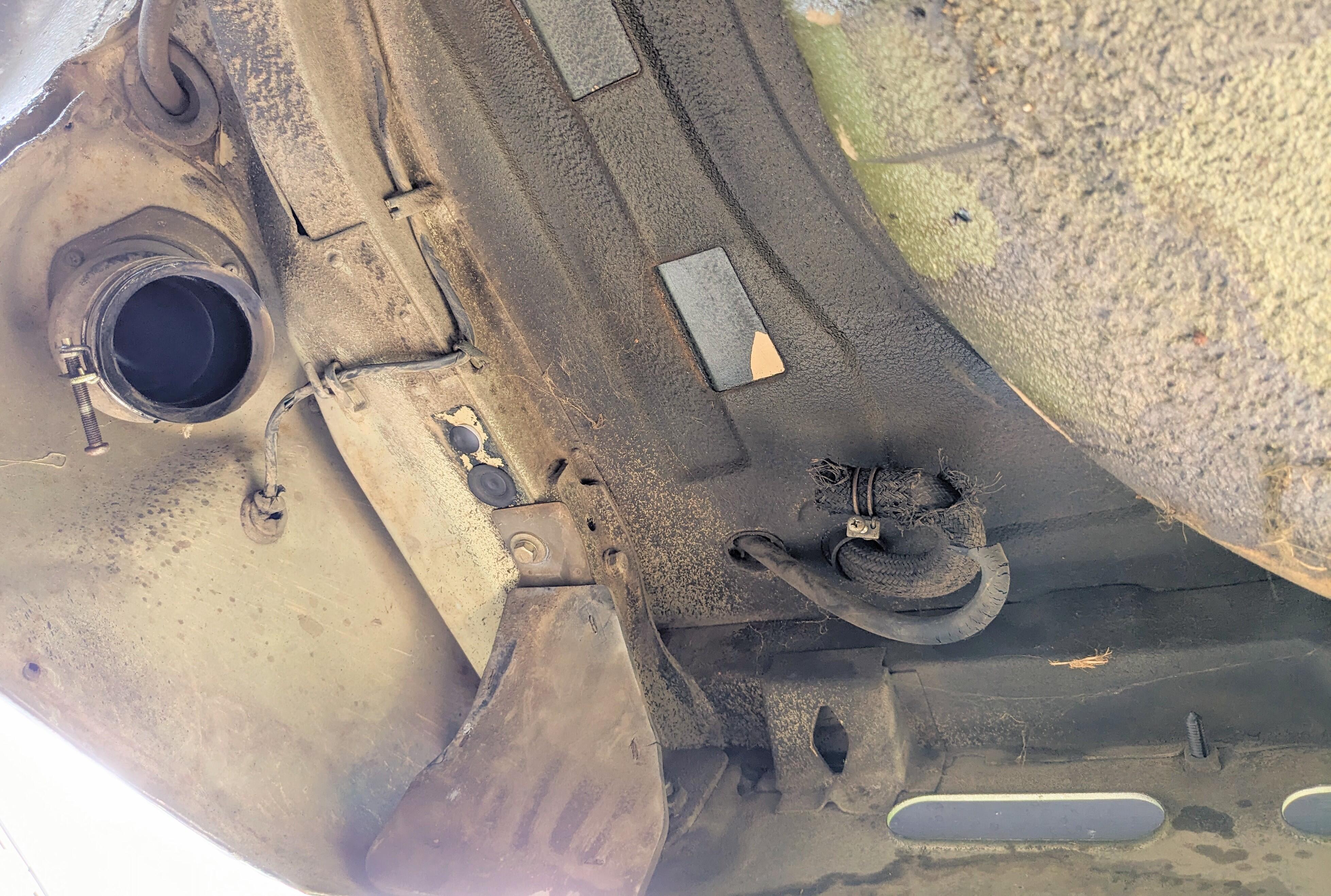

Drop the tank, and found the source of my gas fumes/overflow when filling. Smaller vent line off the tank was ruptured. I actually realized I could have seen that if I looked through the louver slots in the tail panel

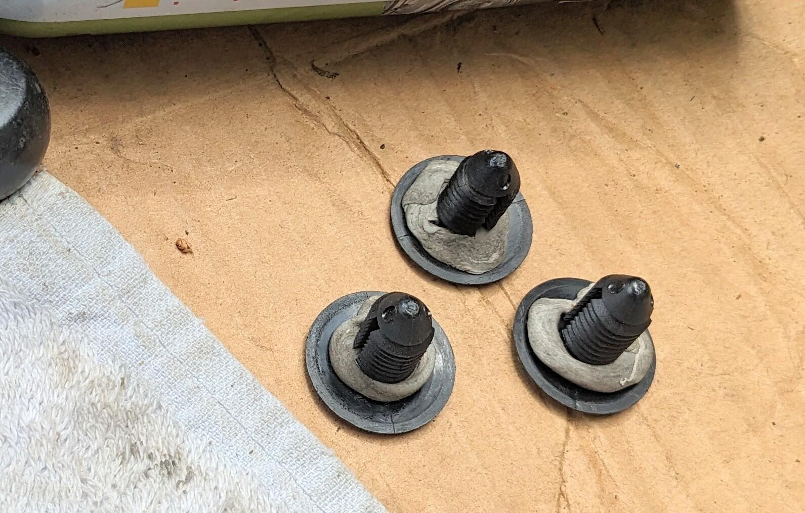

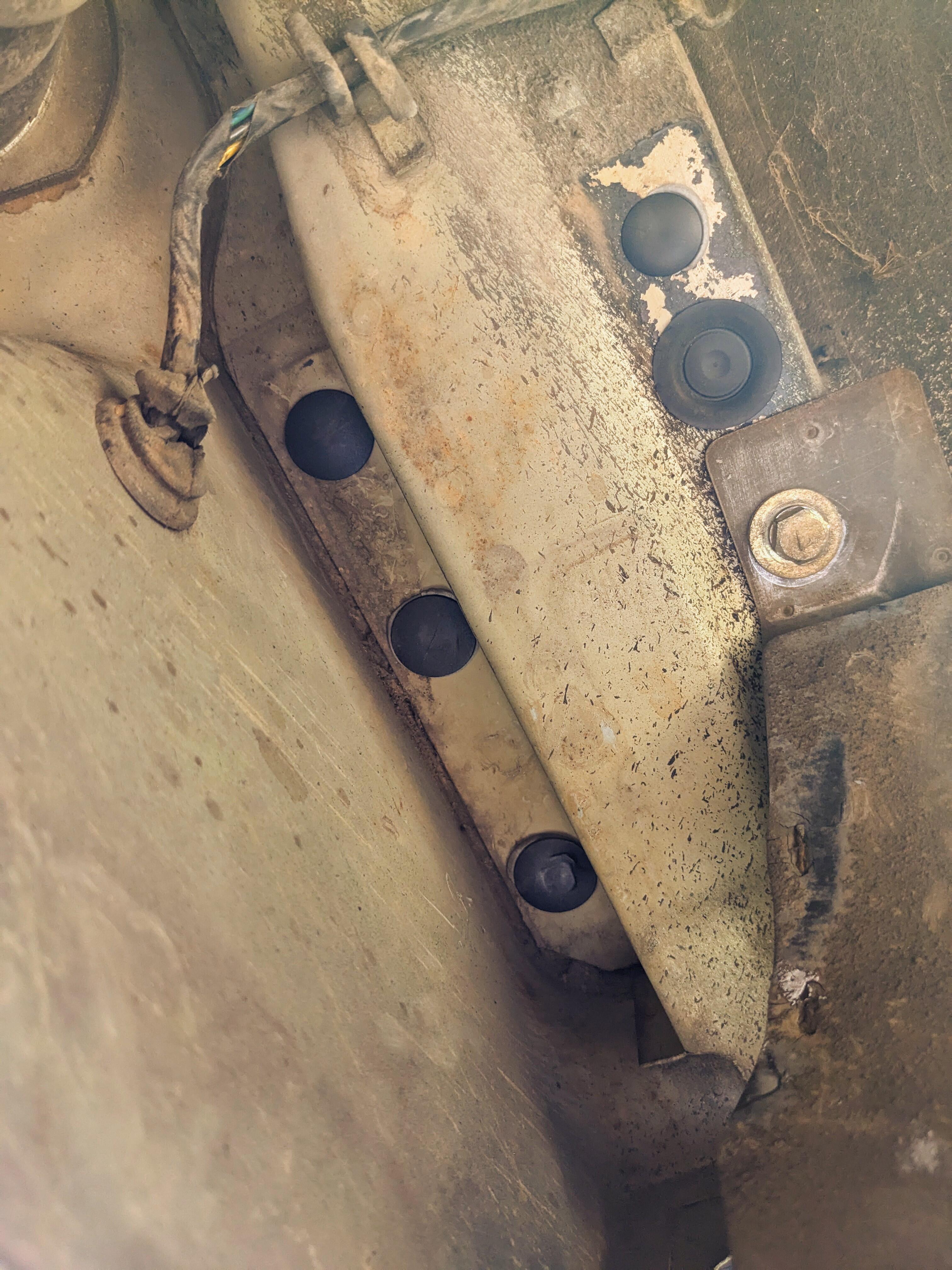

Removed the remnants of the right side bumper shock, and plugged all the holes. Added butyl to ensure a seal

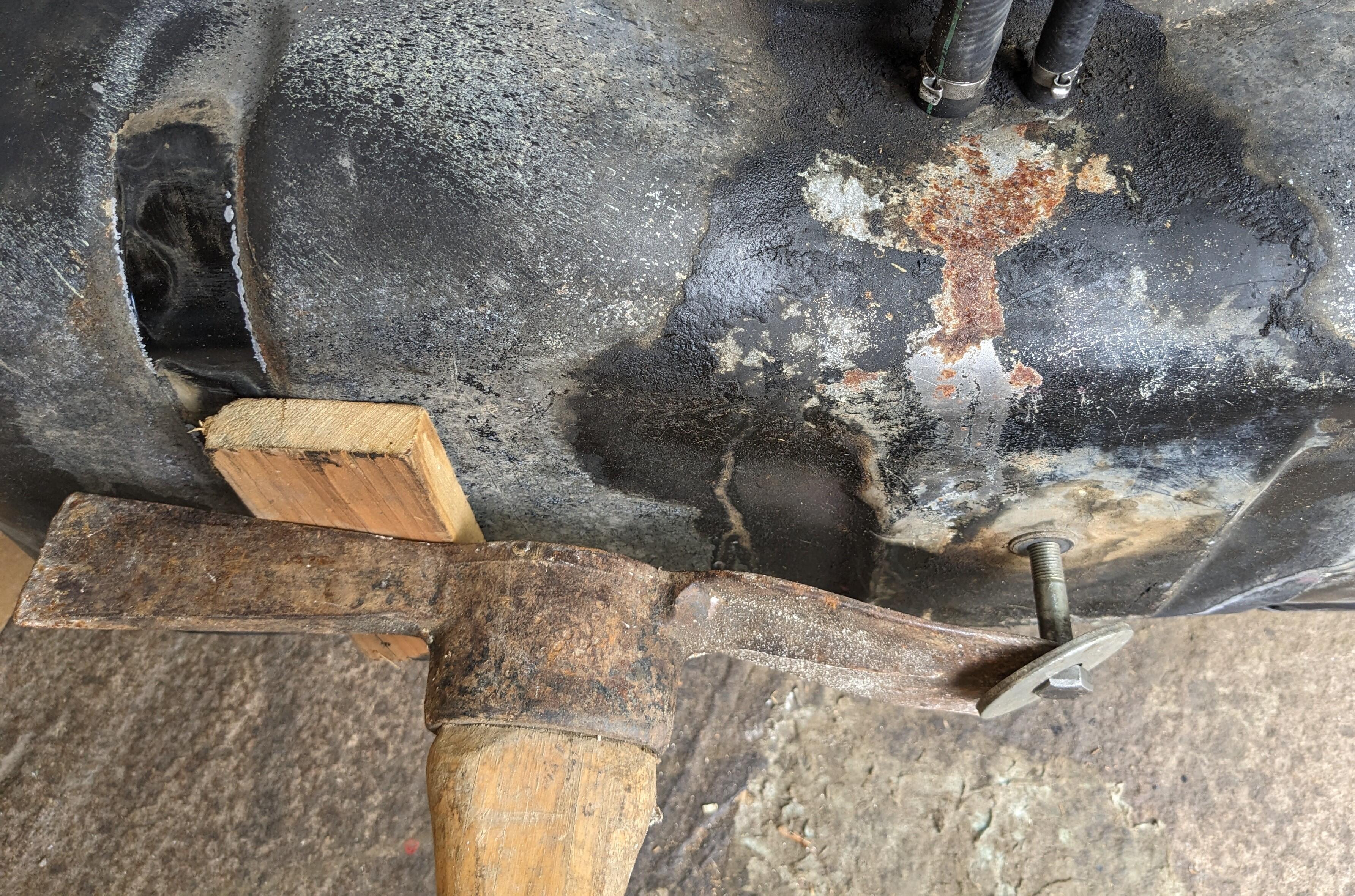

Had to pull out the bottom of the tank a little. I realized there was no way to lever in there from the fuel sender port as there is a baffle in the way. So I just put a threaded bolt in the drain plug and levered the sucker out evenly working around the circumference of the bolt/plug hole

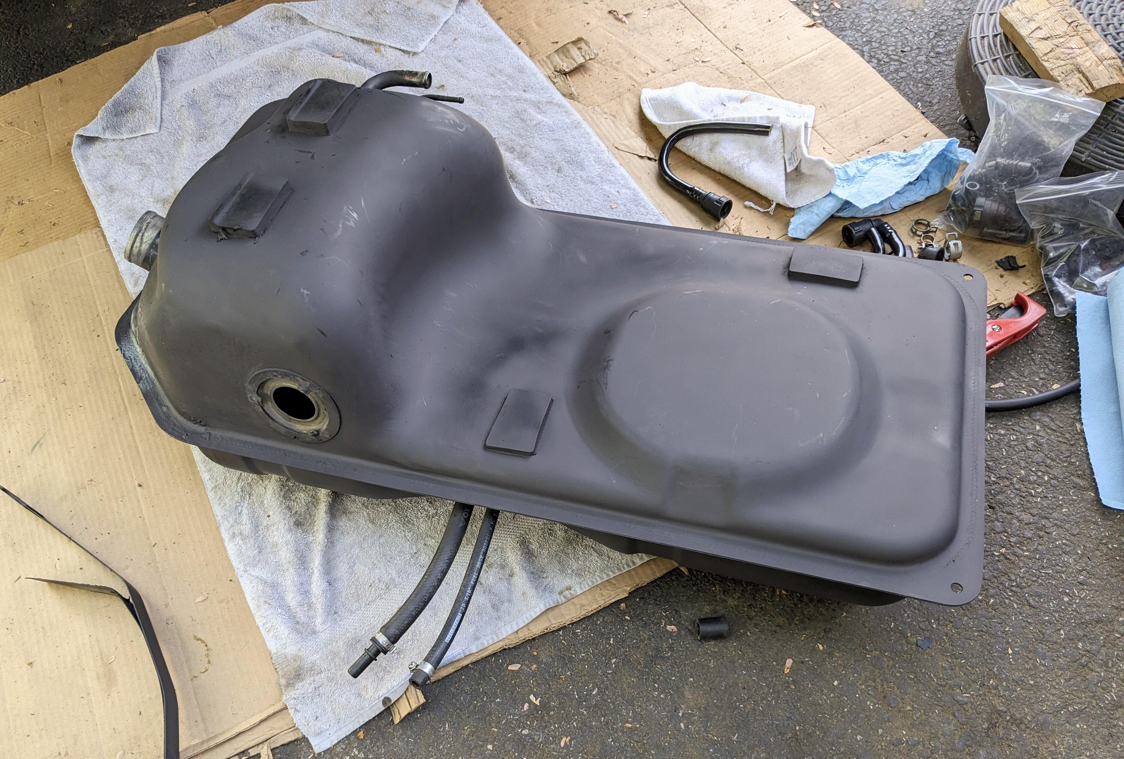

Degrease / clean and paint tank.

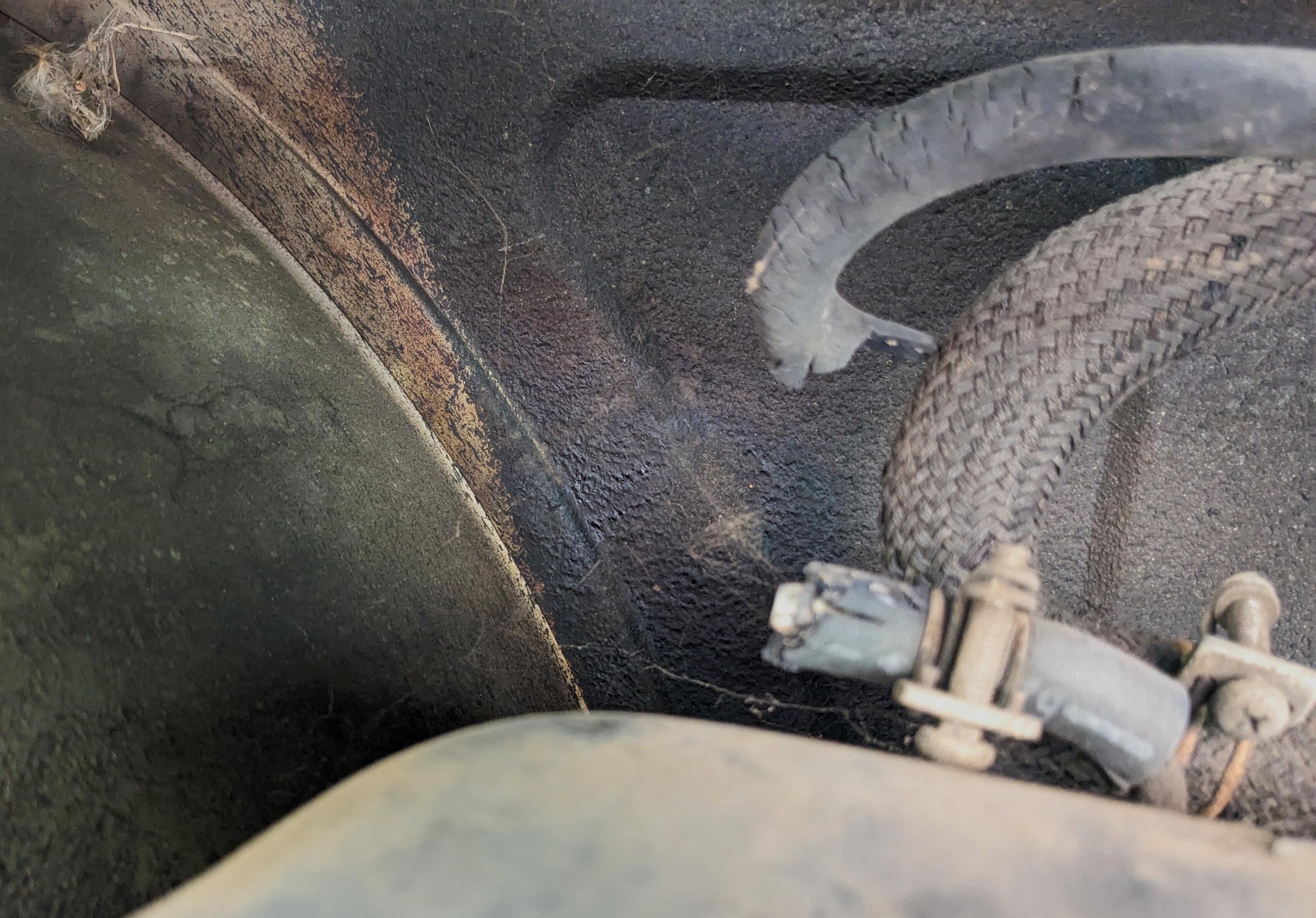

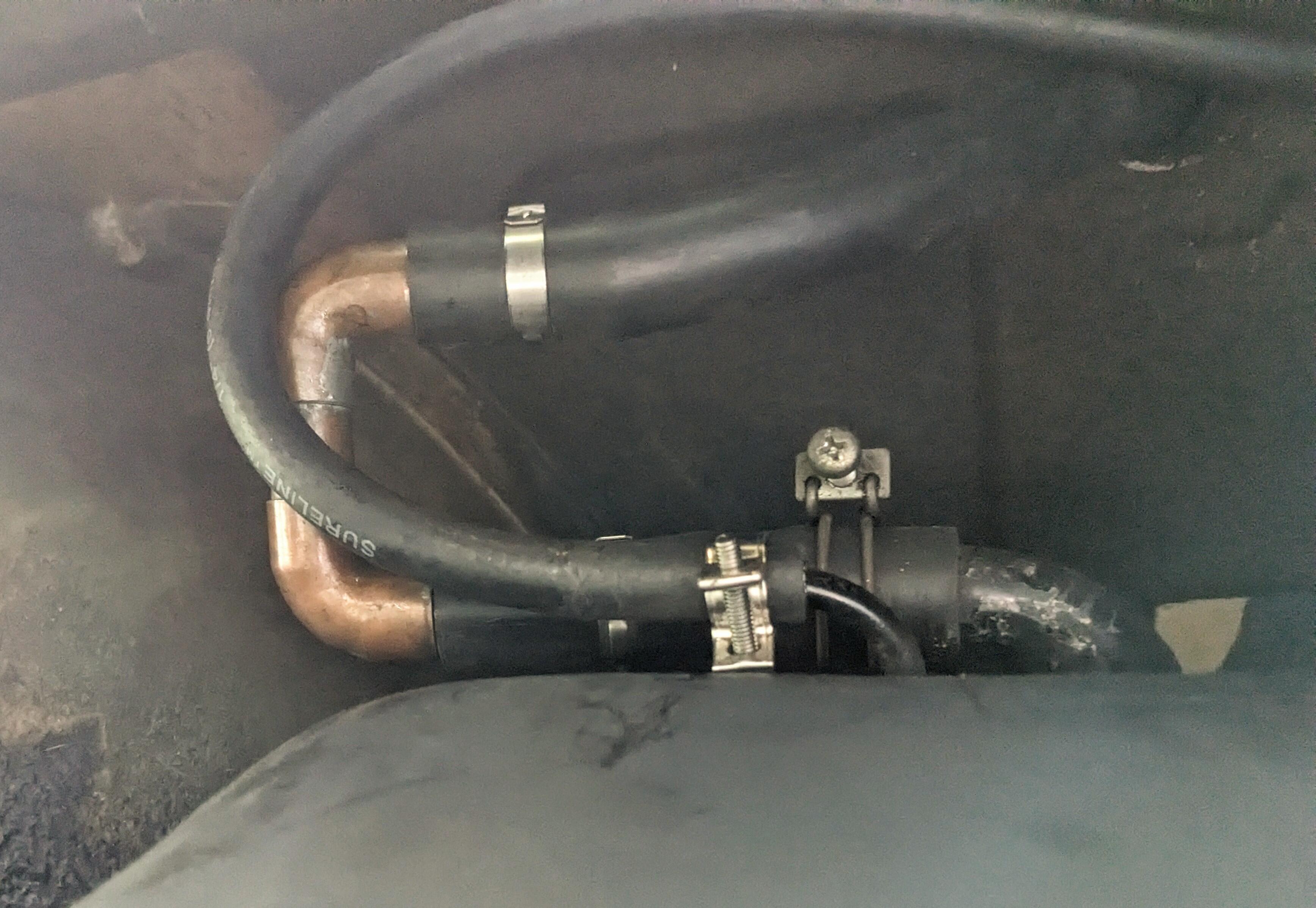

Made an elbow to replace the original large loop, the small line I just ran a longer piece, so it could loop gently
Visible through louvers beneath bumper.

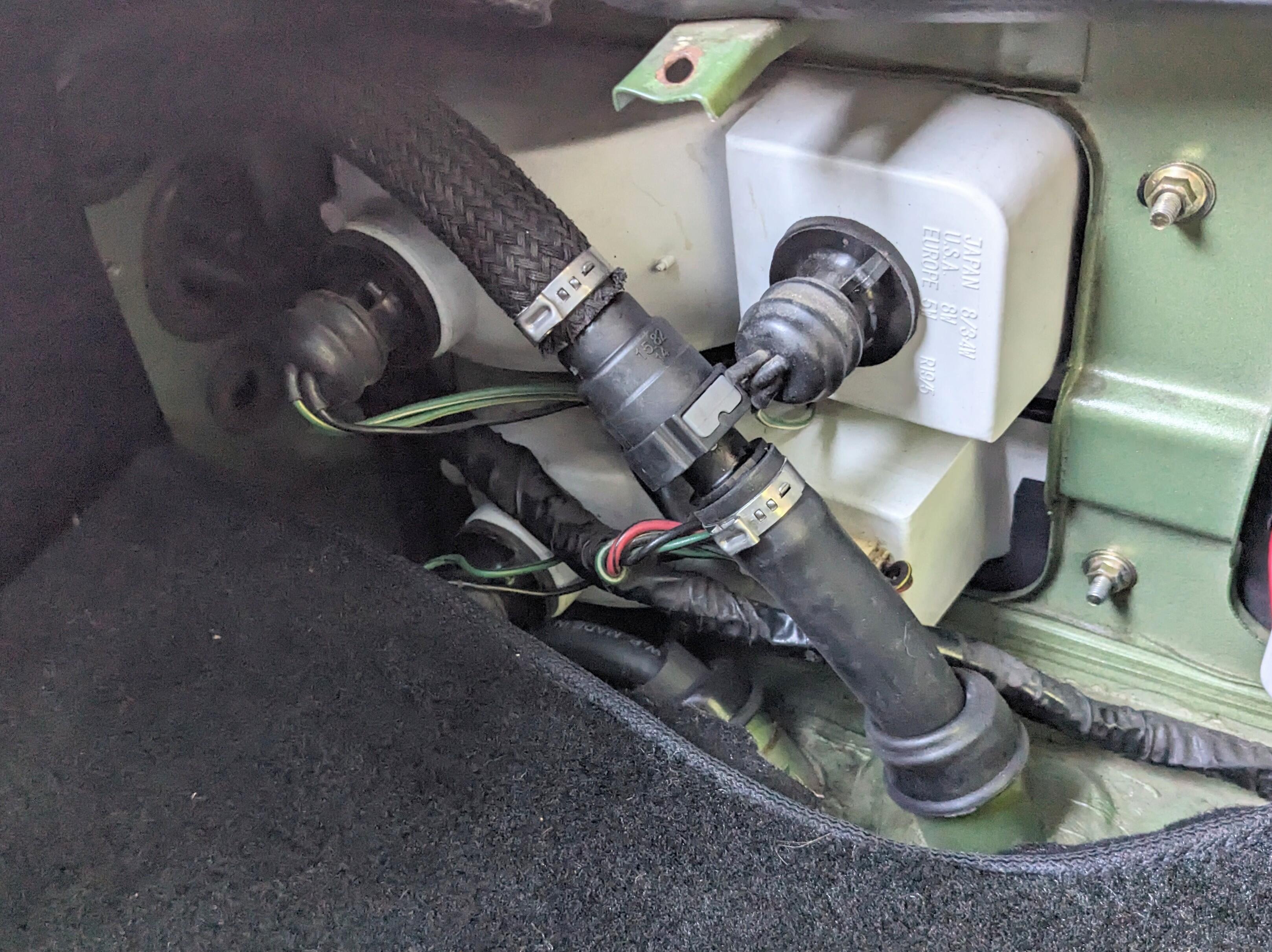

For the inside, I cut the original hose - most of the inside was perfectly good there was no cracks in the the material, so I just ran a splice section from the tank, and used a large quick connect to join the two. new grommets for the lines from ZcarDepot.
I did find out that I put the sender in upside down, as when I started it the gauge pegged full. Drained about 4 gallons, prior to doing the work.
I realized the notch in the sender plate was supposed to be on the right not on the left - upside down in this pic

That hose that's cracked was the same one causing my issues.
I've got a slightly different plan for routing the hoses (basically bending them), but haven't gotten around to that yet. I will post pictures once that's done though

I think the difficulty with dropping the tank, or getting access to that hose in the back, kinda depends on how much slack you have in your lines. For me, the top/front hose with the odd bend in it made it so I couldn't drop the tank at all, and had to cut it (you can see it still attached in the earlier picture I posted).
