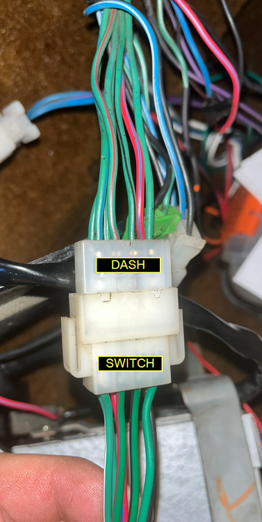

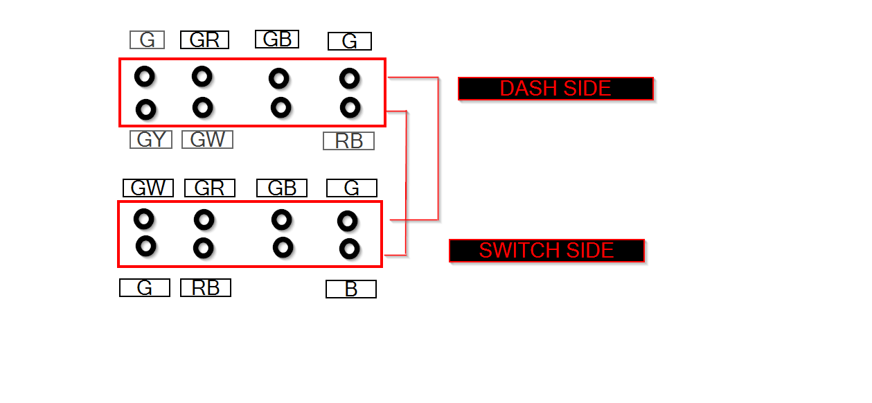

Hazards work, turn signals do not when wires are not jumped at c7.  I pulled the hazard switch apart to see what is wrong. Connectors look fine, no corrosion.  I ran continuity tests on the switch side wires to the board and all checked out. On the board  I can jump the hazards and get them to work but I can not jump the turn signals.
With the ignition in the on position the dash side connector green wires both have power.   Where can I look next?

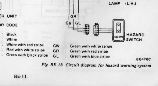

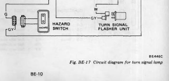

I haven't followed the whole thread but the wiring diagram shows a different power supply and a different output through the Hazard switch, for turn signal versus four way flashers.  You're either not getting power or you're not getting output from the Hazard switch. I would confirm power in on G, then power out on GY, right at the Hazard switch, firstly.

 1)Jumped G and GY at C7 again for a sanity check to make sure the turn signals worked. They did.
2) Took apart the hazard switch and cleaned up all the connections. Tested it with a multimeter and found no issues.
3) Connected G and GY from c7 directly to my switch. This worked
Problem was somewhere with the wires that connects C7 to my switch.  Ohms test was fine on all the wires.  Although I did not see any corrosion, I once again cleaned the male and female connections.  Then I sprayed it with deoxit.  Reconnected everything and now I have both hazards and turn signals working!
