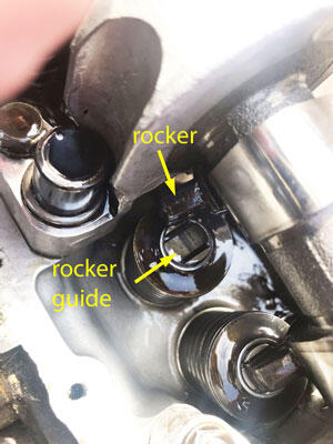

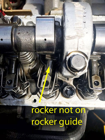

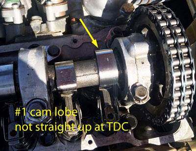

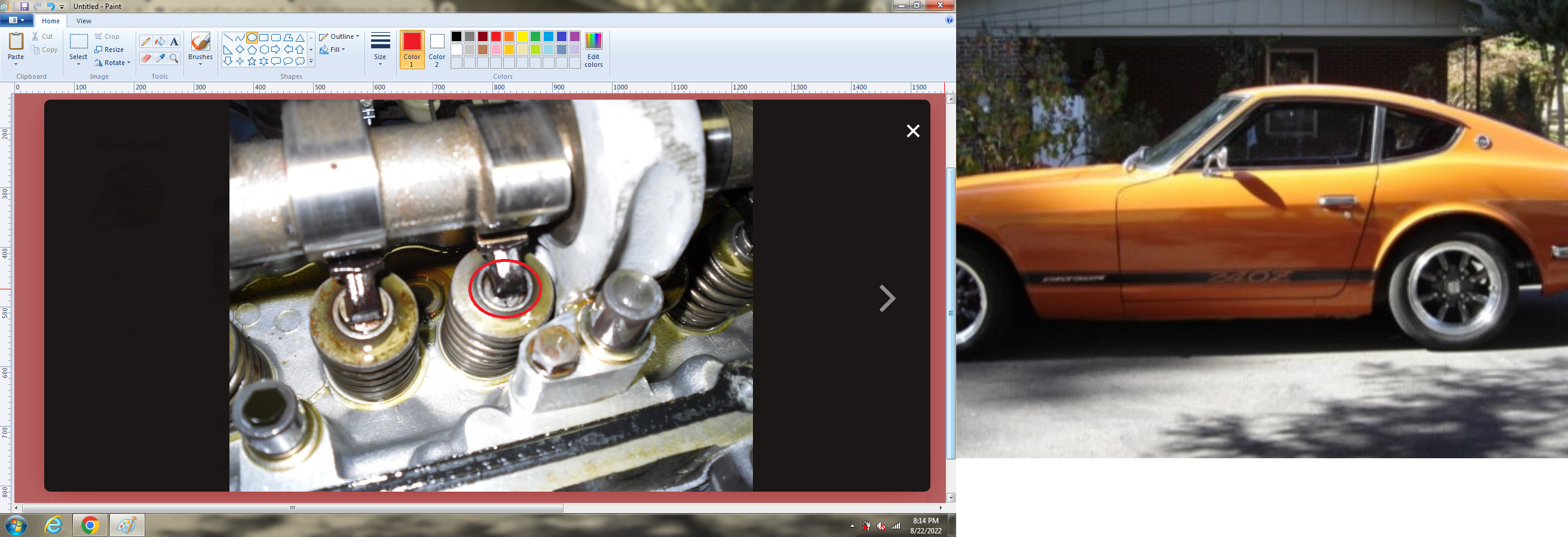

To my surprise I found that the intake rocker on #5 cyl had jumped off the rocker guide. The adjustment nut was locked so the valve lash had not changed. I finally got the rocker back in place and set the # 1 cyl to TDC. In the past I understood that the lobe of the #1 cyl was to be pointing straight up at TDC.

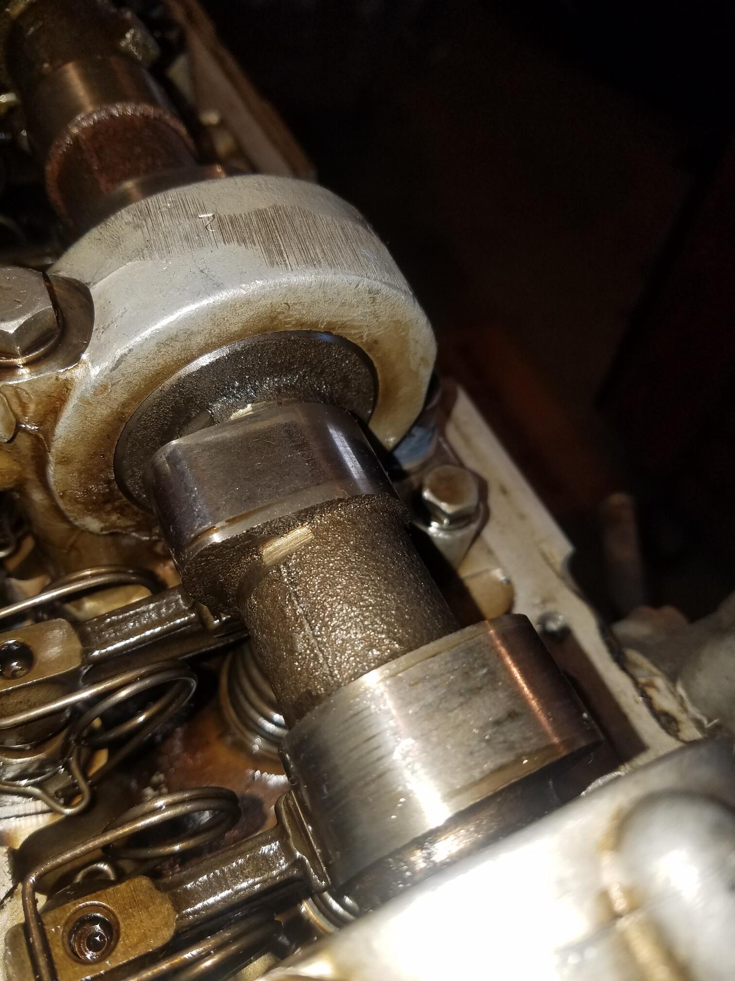

At TDC my cam lobe is at about 45 deg . I know it’s at TDC and I rotated the motor stopping on the timing mark to make sure that the piston was at TDC, also measured piston position, and both valves are closed. I checked the vale lash on all the valves and all were in speck (cold).  At this point I was worried about a valve problem with the #5 cylinder so I did a compression check on all cylinders, everything was good and no leak down.

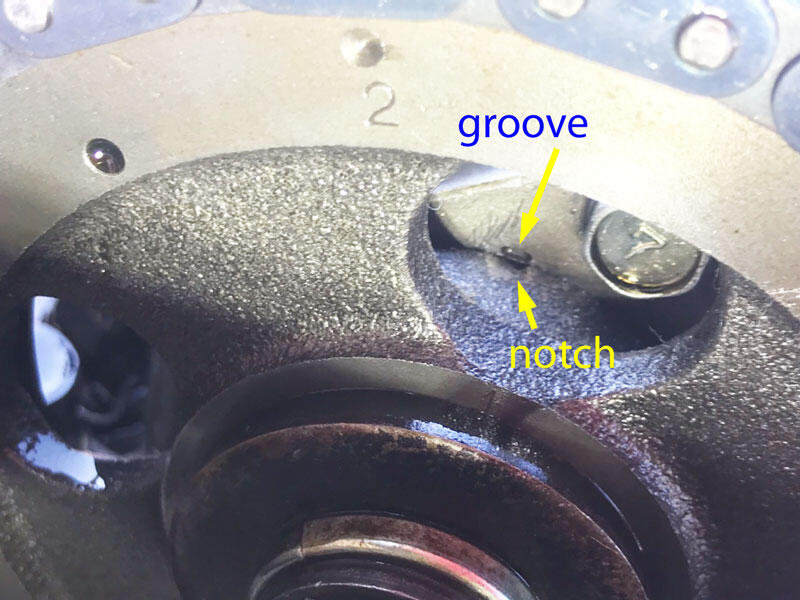

I also checked the timing chain position and mine is #2 position and just slightly left of the notch. See photos for all the above.

-- Is the cam lobe on #1 cylinder supposed to straight up at TDC?

These engines seem to throw rocker arms occasionally, especially if they've sat for a long time.  Maybe the valve guides are tight since they're new, or they're drying out as it sits.  Apparently today's detergent oils drain more fully than non-detergent.  (Obscure factoid I picked up somewhere).
But since it's open you migth as well check the wipe patterns.  Maybe they're off and a rocker arm pad caught an edge.  There have been some posts on the forum about bad wipe patterns causing a racket.
The notch is on the gear which is bolted to the camshaft.  I think that the only way the cam could be off is if the locating dowel was missing.
I agree, looks good.
I was breaking in my "just rebuilt" '77 and about 30 minutes from home I hear a terrible clicking from the head. Slowly back roaded it back home and found the same thing, a rocker had jumped off. Put it back on after asking the guys on here. Never had another problem.

I found the thread and I need to apologize. It was my lash pad or rocker guide that fell off the valve spring. The rocker actually stayed on top of the valve spring retainer it was just super loose but straight. Looking at your's I don't think you would have gone too far without damaging something.
Mine...
Probably the lack of use is the biggest culprit. Valve probably hung up and the rocker went off the rail. Worst thing you can do to these engines is to NOT use them. Just starting them up now and then is not enough.  I'd put it back on and go thrash on it down a back road .
