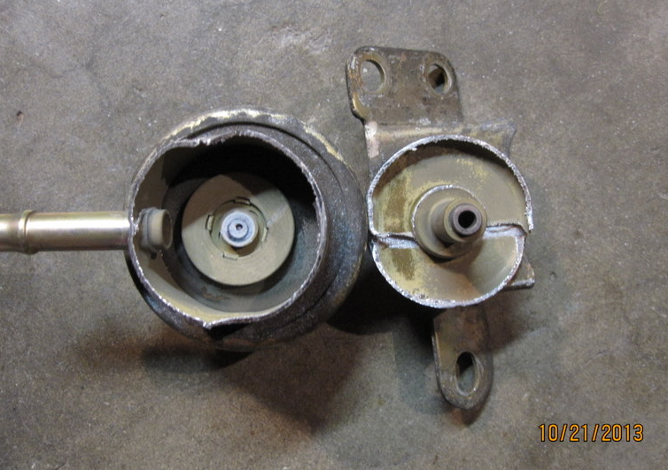

I don't know how it could be cleaned.  I think you'd need a new one.  Or a good used one.
Here's a  picture I took of one that I tore apart.  The fuel comes in from the side port and forces the valve open to exit down the hole in the middle of the center tube on the right.  You can see the wear marks on the seat where the exit port tube seals.
