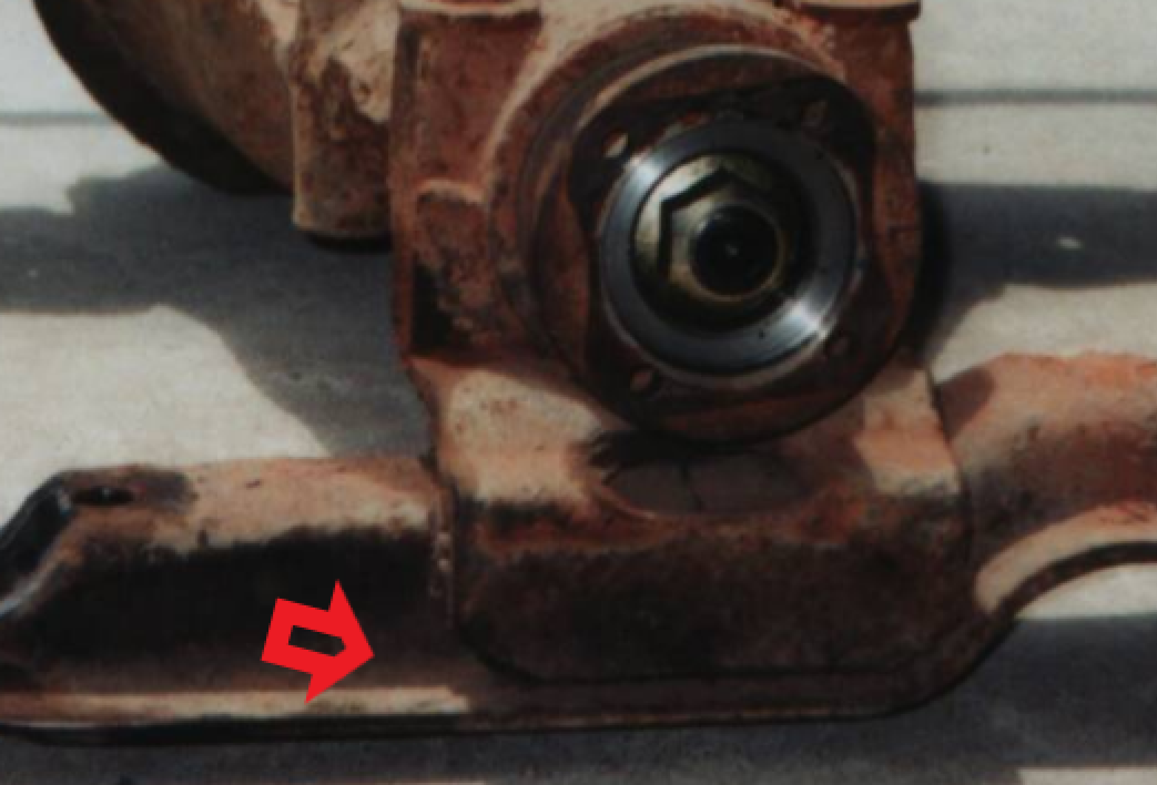

Zed Head Posted September 12, 2022 Share #11 Posted September 12, 2022 (edited) On 8/30/2022 at 1:58 PM, ollie said: This whine came on over the winter when the car was just in storage in a heated garage and I have never abused this diff. Any chance that the noise is actually from a failed differential or mustache bar mount/bushing? The diffs are inherently noisy. If you have any spare differentials you could swap one in and see if there's a change. Or take a hard look at the mounting areas. On deceleration the diff nose is pushed down. And the metal edge of the diff mount is very close to the crossmember. It's easy to imagine that the edge of the mount contacts the crossmember on deceleration. Borrowed a picture from somebody's web site. Edited September 12, 2022 by Zed Head Link to comment https://www.classiczcars.com/topic/67786-r200-clsd-whining/#findComment-645284 Share on other sites More sharing options...
