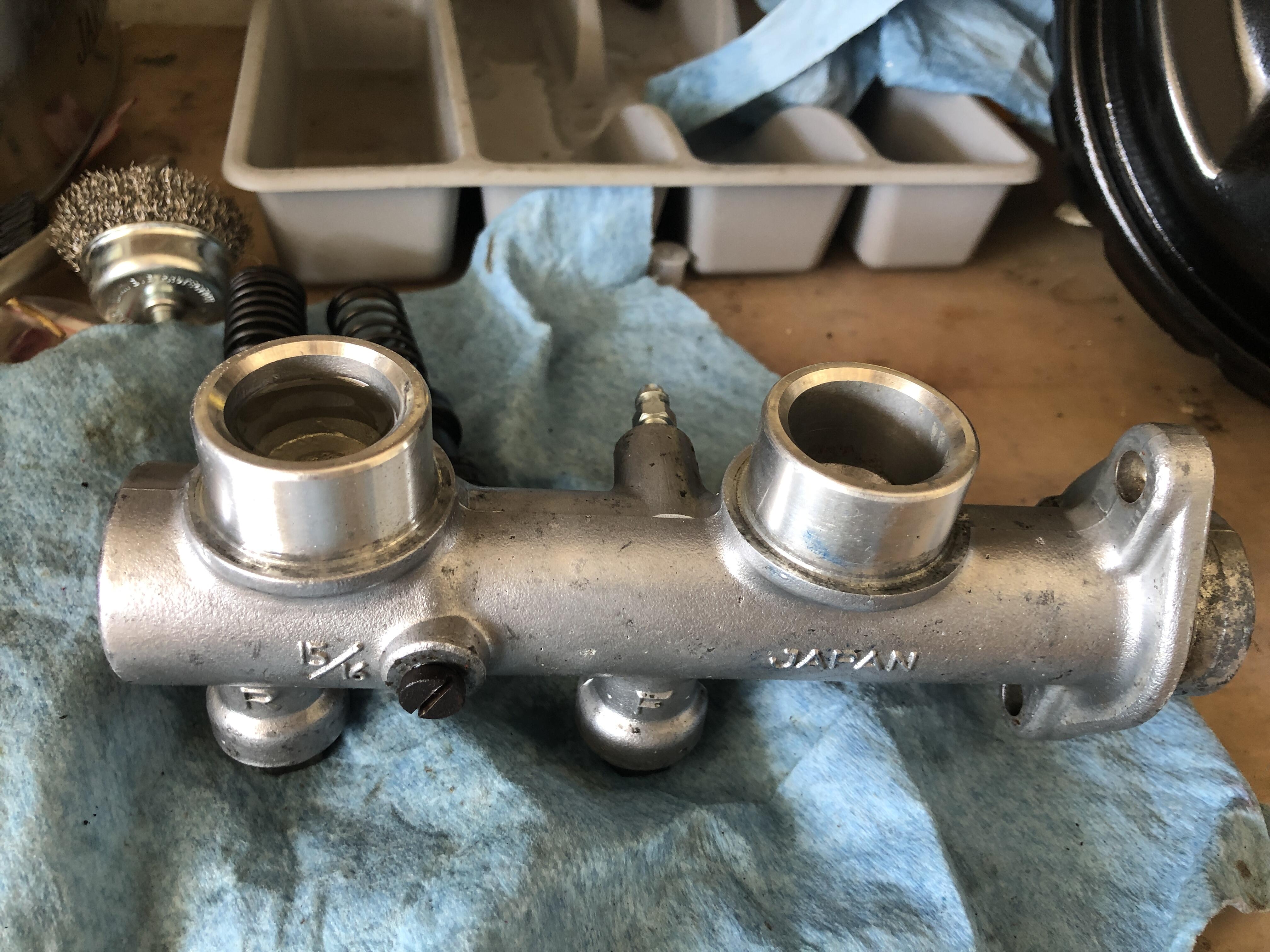

I’m in the process of evaluating whether to upgrade the 15/16” master cylinder with the 10” boost master from 280zx 1979.  I tried to bench bleed the master cylinder and observed the below behavior.
notice, I didn’t mount the reservoirs on yet.
fill up the cups and it’s very slowly draw in the fluid into the bore and out the F and R outlets.  I tried to tap on the side to see any bubble coming out.  Very little.  I even try to pump the cylinder and seem like just air coming out.
Fill up the cups and left overnight, the F seem to be able to drain completely.
do I need to mount the reservoirs to help with the gravity to pull in more fluid?
https://www.classiczcars.com/topic/67790-master-cylinder-bench-bleed/
It is used.  I bought the Tokico rebuild kit.  Apparently, a close examine the Tokico and the Nabco, the Nabco is a bout 1mm shorter on both piston.  I think the Tokico pistons block the holes.  That's why no fluid gotten into the bore.
ahh well, probably a remanufactured one probably a better route.
